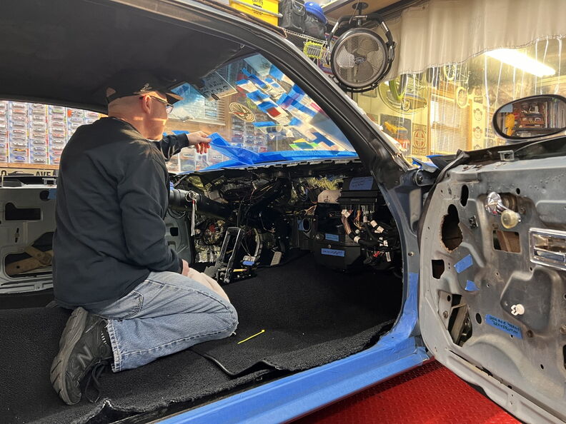

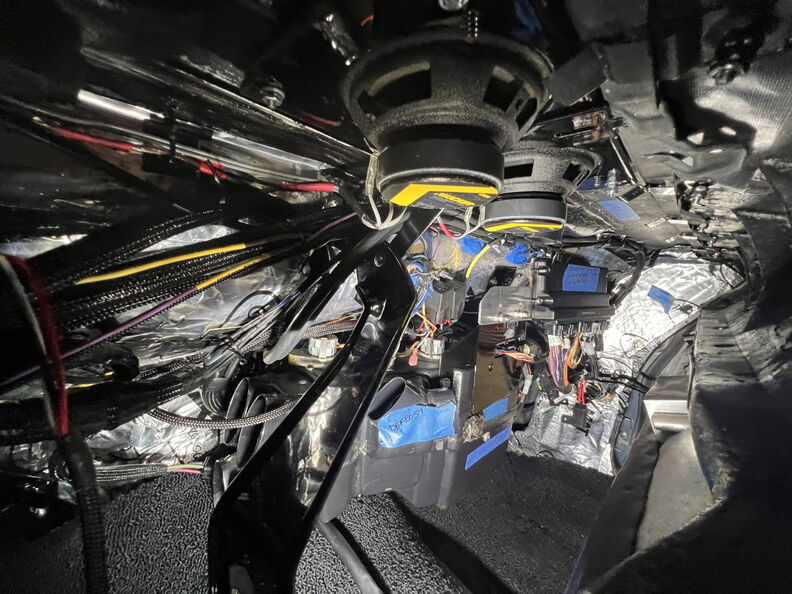

First up is to install the Vintage Air Unit.
Since I have no hair on my head I started wearing a very thin skull cap from Headsweat. It's not a true Bump Cap so l am calling
it a Tap Cap as it gives me warning that I am about to hit my head on something.
I sprayed the drain hose with WD40 Silicone to help it slide through the floor drain grommet.
Of course the fun part is installing all of the nuts.
It's hopefully hanging for the last time.
I double nutted the Relay's to make sure they don't fall off. I had planned to use a Nylock nut like I did on the other's but felt it might be brutal to have to remove while laying under the dash.
I am stilling trying to decide if I am going to run the Neutral Safety Switch wiring under the carpet. However, I am going to use the Orange & White wire for my under dash lighting.
A small feeling of accomplishment
Honey I am going in...hopefully for the last time.

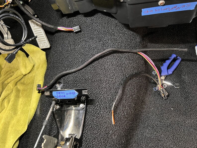

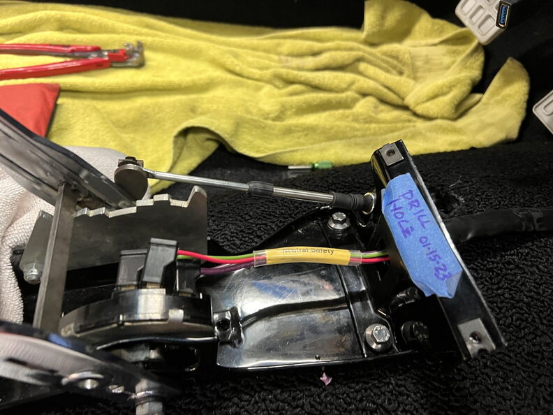

Default Neutral Safety Switch Wiring (( 04-02-23 ))
Well, I was going to install the dash and it seems I can't find the clips !!
Instead I will work on the final wiring.
Always make sure you take a picture of how the wires are run.
Loom has been sleeved for protection under the carpet
marty-mj

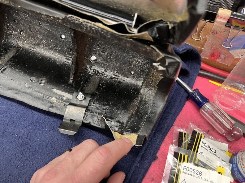

Default Road Trip and Dash Pad Install (( 04-04-23 ))
Thankfully D&R Classics is close enough for me to drive to so I picked up the needed clips for the Dash Pad install. (( 04-03-23 ))
04-04-23

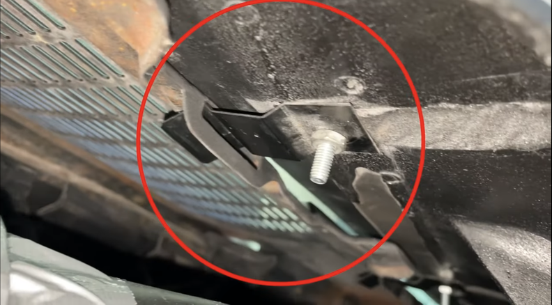

So this is strange the outside studs are metric and the inside studs are standard.
Not any more !!!
I noticed the outside edges of the leather needed some adhesive so I decided to tackle this small project and call it a night.
If you don't own a pair of these I suggest you buy a pair as they will precisely cut paper and then cut thin
sheet metal. I have been using these for months and they still work like new.
marty-mj

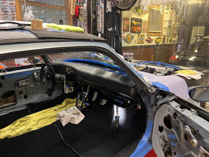

Default One Day Later Dash Pad Install...Finally !!! (( 04-05-23 ))
This is big as the blue tape is finally coming off the metal part of the dash.
I loosely installed all of the clips to make it easier to install the dash pad.
Remy picture for Skip.
We all know what he is thinking "When is he going to finish this car !!! "
I gently placed the dash in the car since I will be doing it solo.
I tried to physically push the dash pad in to engage the clips and that didn't work at all. So, I moved to Plan B and removed
the all of the clips except the two middle clips. This allowed me to push the dash pad in and fell like it wasn't going to fall on
me while I laid under the dash and put the clips in and then slid the studs into the clips. It's very important not to tighten
any of the nuts till all of the clips are installed.
Well it looks like I am going to illuminate the Fasten Seat Belt Light as I like how it looks.

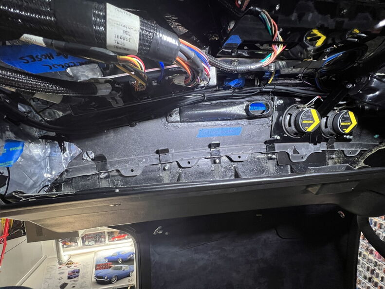

Last few nuts are now tight and I did install Nylock nuts over the nuts to make sure they don't come loose.
Looking in where the Dash surround will be I am very happy with my wiring as it is all easily accessible.
Calling it a night !!
marty-mj

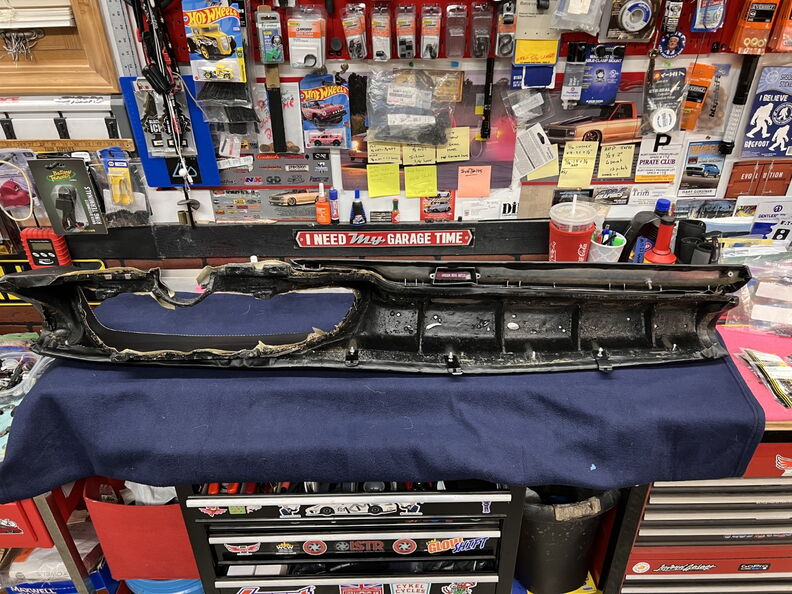

It's time to make the Classic Dash surround fit into my dash area due to the leather wrap.
The first thing I need to do is remove the Headlight Switch, Digital Dash and Autometer Clock.

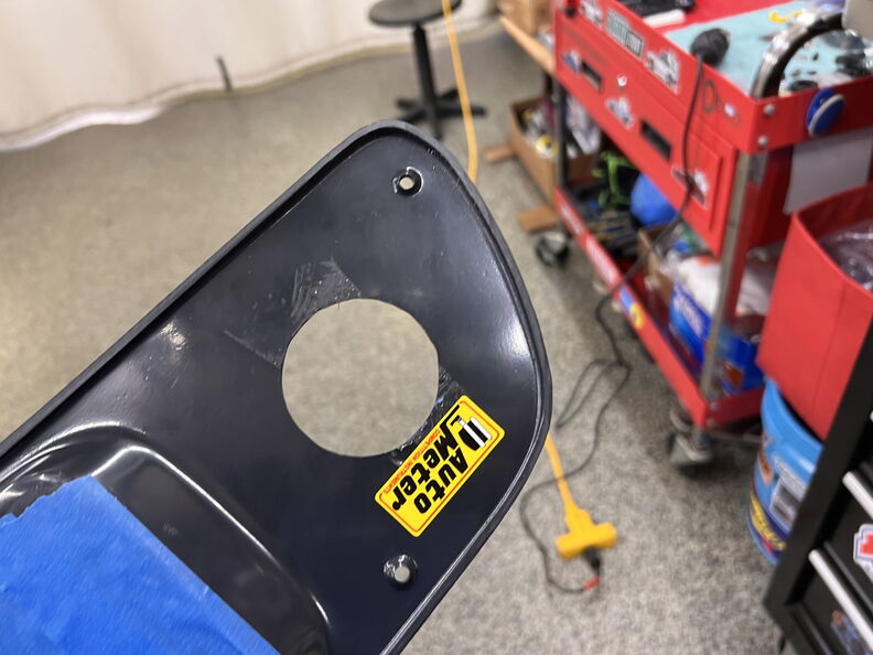

Instead of shaving a couple millimeters off the supplied bracket I chose to install two washer. On final install a star washer
as it will prevent the bolts from coming loose.
All parts safely stored back in the box
Time to start slowly trimming down the surround.
As you can see I removed a lot of material.

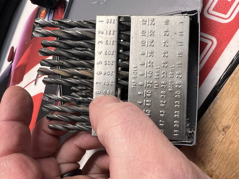

I need to enlarge the hole in the headlight switch and ended up pulling out the special drill bits to get it nice and tight.
These are the sharpest drill bits I have ever used and if you run your finger over them it will definitely cut them.
