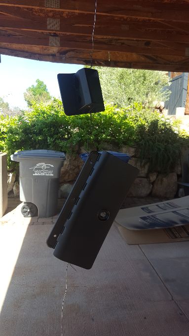

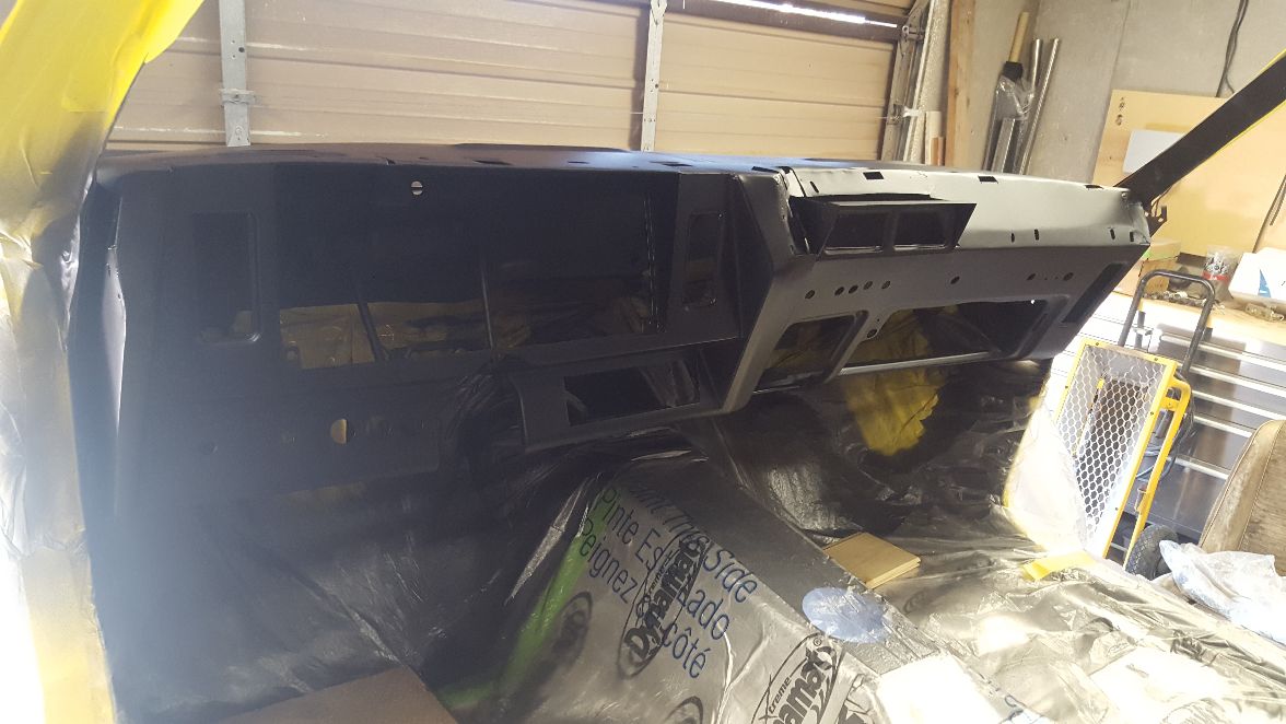

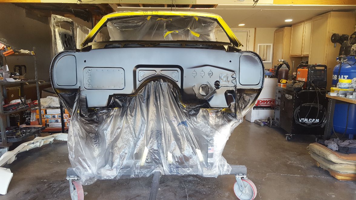

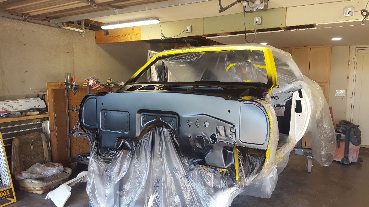

Finally got some satin black on the firewall and dash.

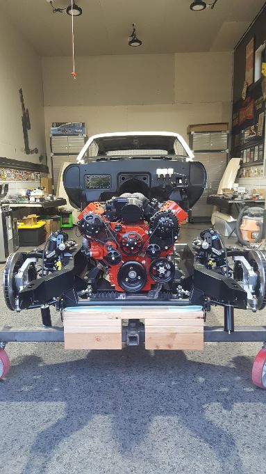

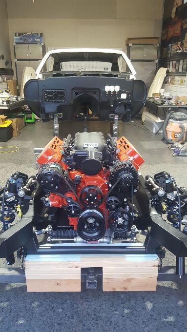

Getting ready to put these two back together. Plan is to completely put the car back together as if it were the final assembly. Once back together and properly gapped, we will guide coat and then finish the final block sanding. Blow the car apart and get it ready for final paint.

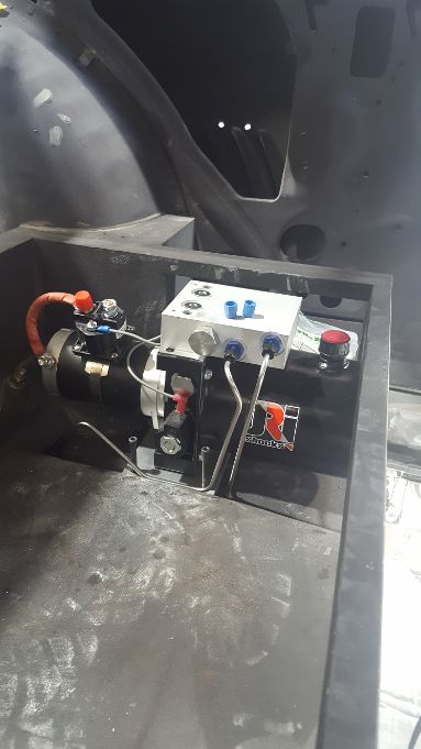

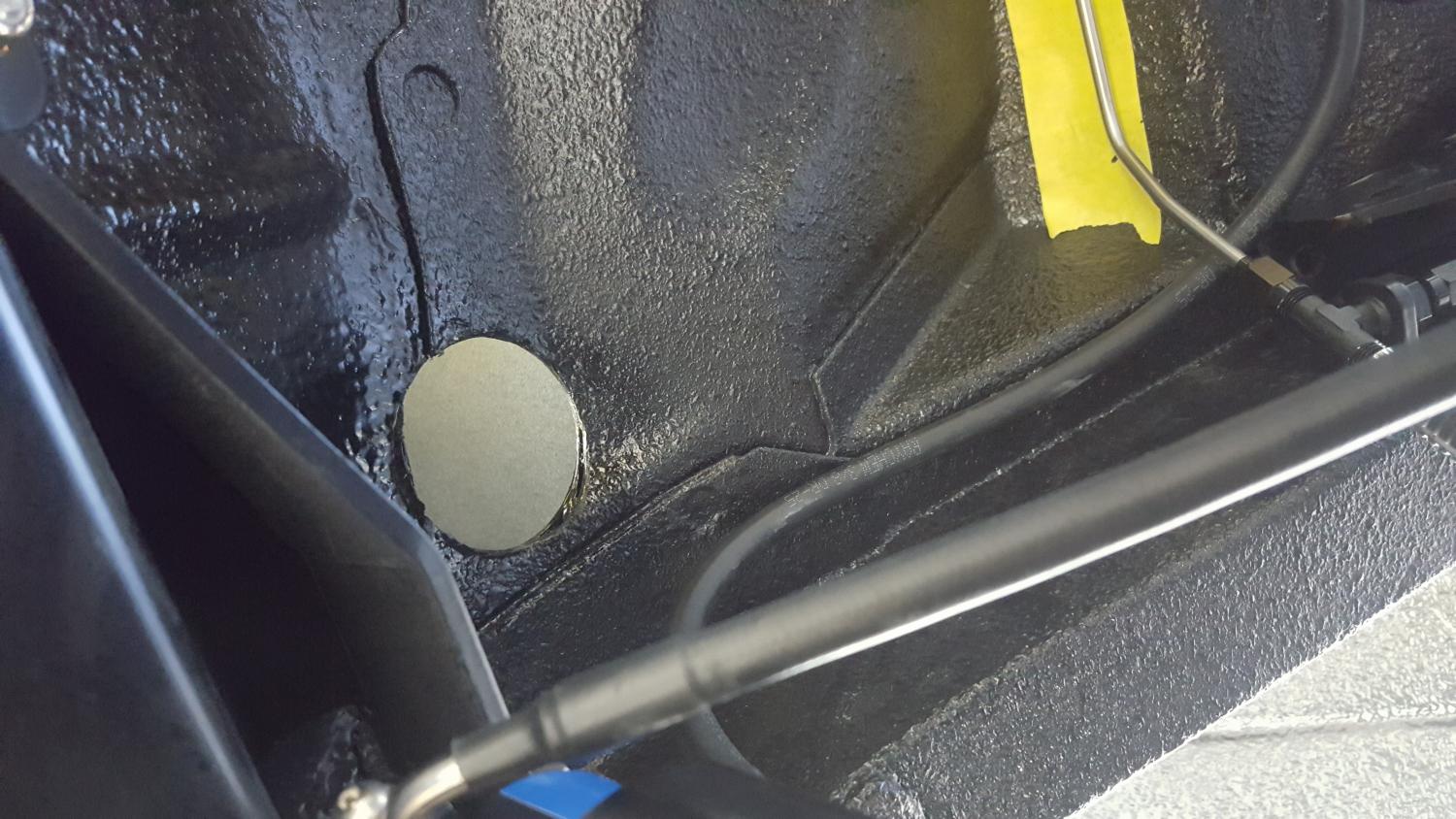

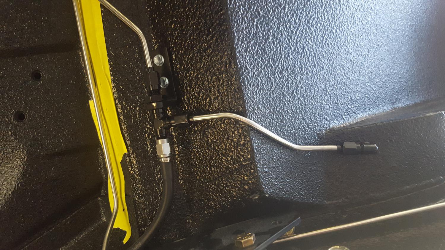

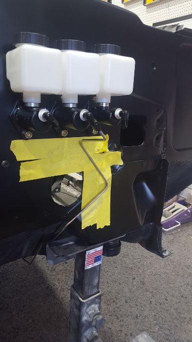

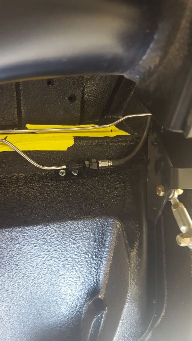

I have a paint booth lined up, but my wait is somewhere between two and six months. In the meantime we will be finishing as much as we can, starting with the brake and hydraulic lines. Also drilled the holes to run the JRI remote reservoirs in the trunk.
