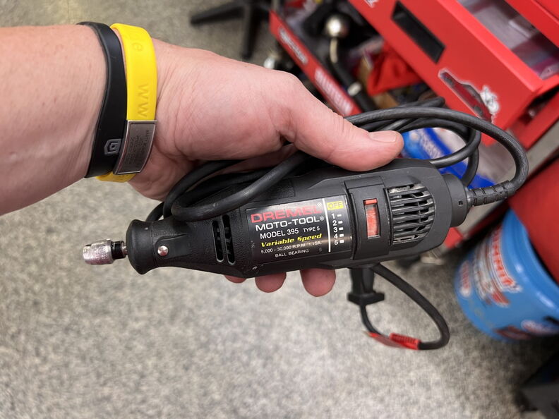

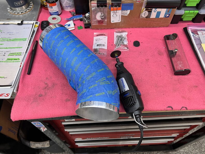

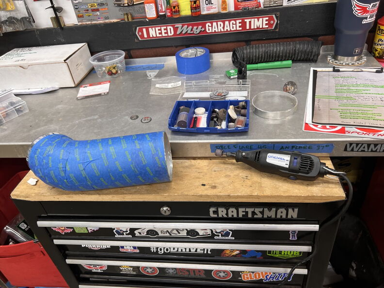

Default Intake Tube Support Bracket & Final Cuts (( 07-04-23 ))

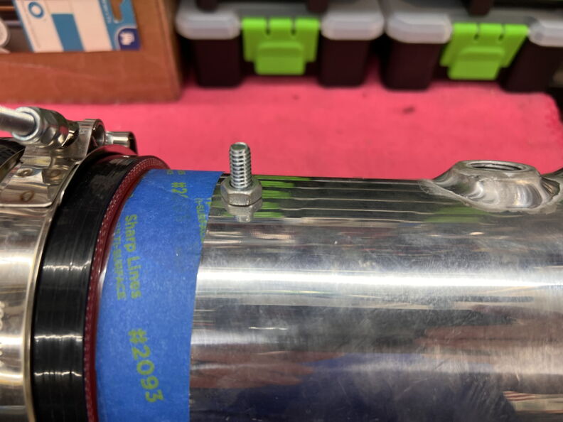

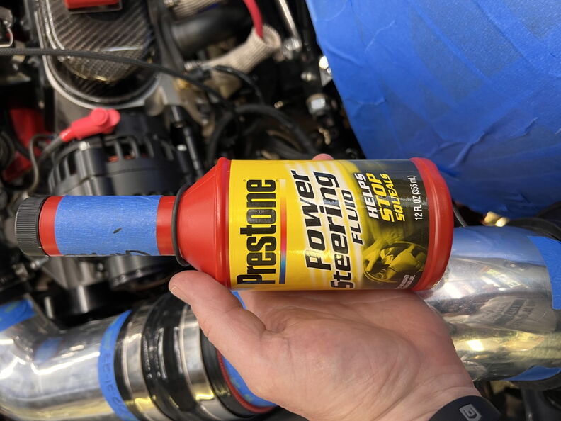

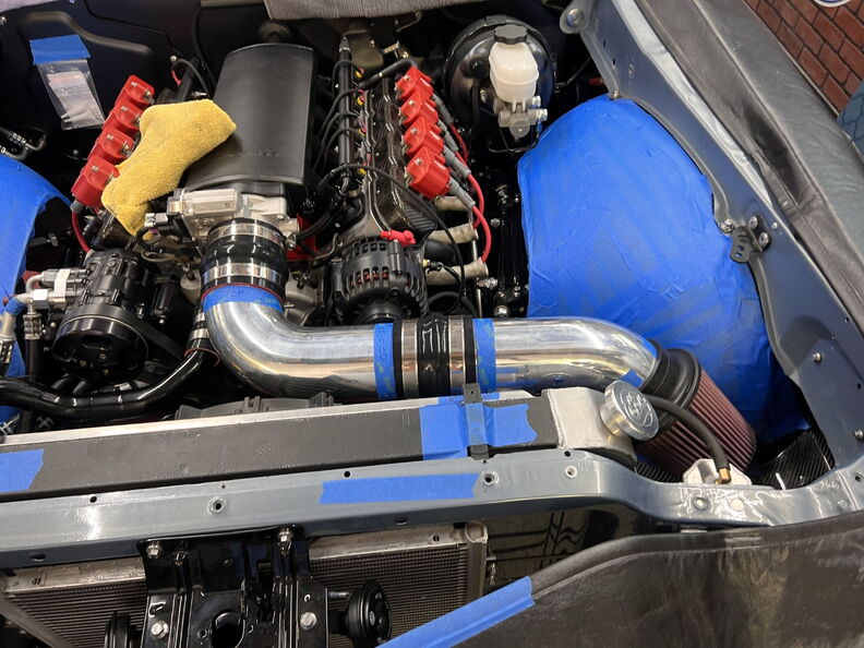

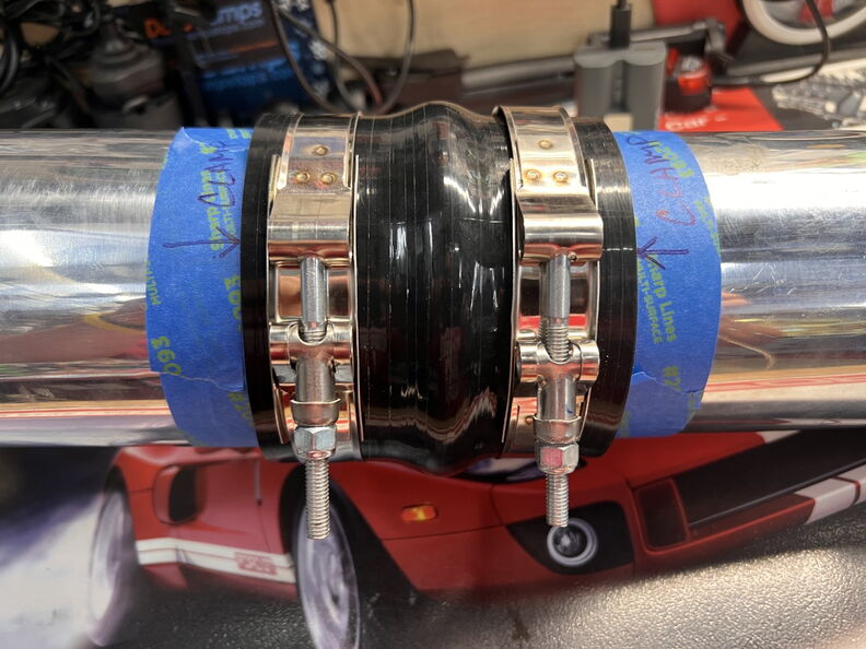

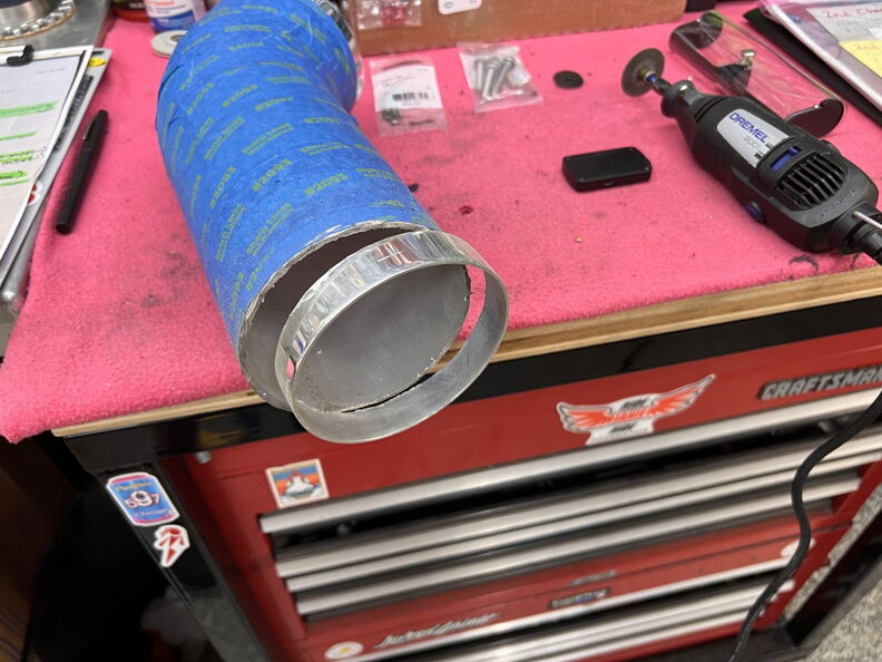

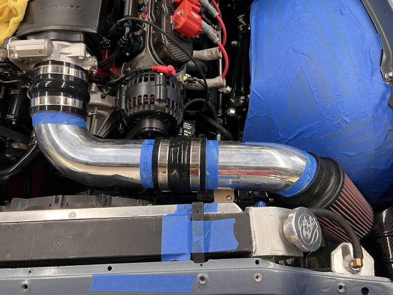

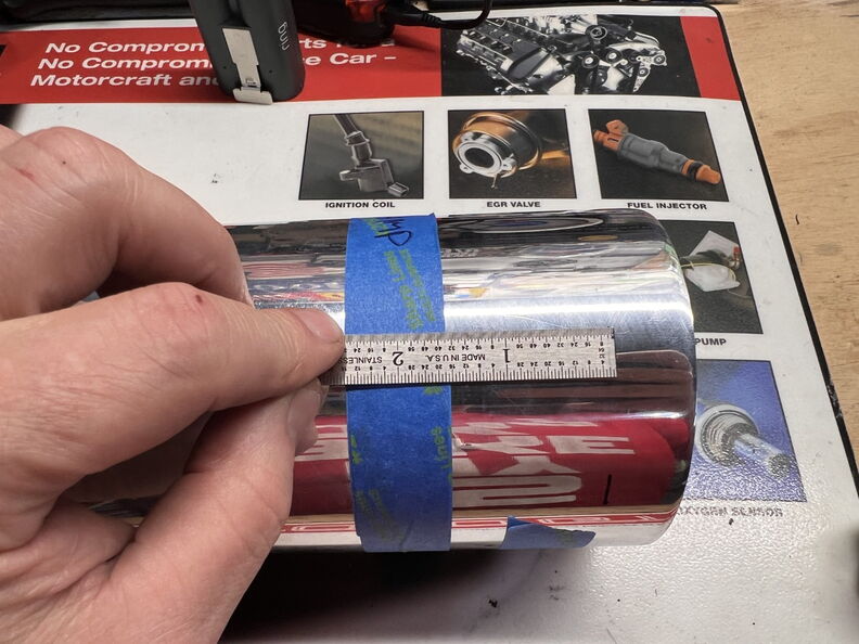

Next up I am going to finally finish working on the intake tube support bracket.
I know it looks complete however the tubes are shoved way far into those hump hoses. So I will need to remove a some of the material.
I marked where the hump hose ends so I know how much that I need to remove.
Well after 30 years it's finally time to retire my old Dremel
In with the new
Time to make the first cut
Just a little bit of clean up.
One Hour later and "Look mom nothing changed"
I will be dropping these off at the Powder Coater tomorrow.

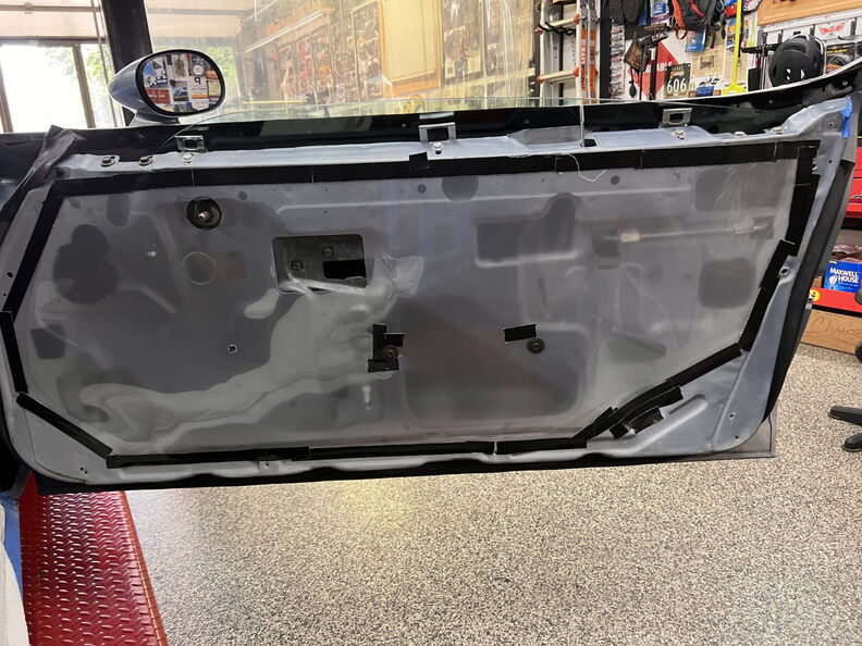

Default Door Pull - Plan B (( 07-03-23 ))

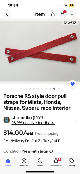

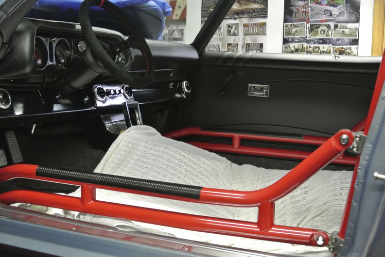

I am finally working on the door pull concept do to the door bars.
If you look the distance between the factory holes is about 1" shorter which should work perfect.
I am hoping they will sit right above the Tiger Cage Door Bars.
old picture for reference

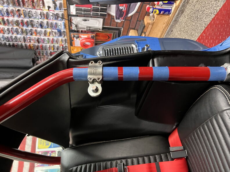

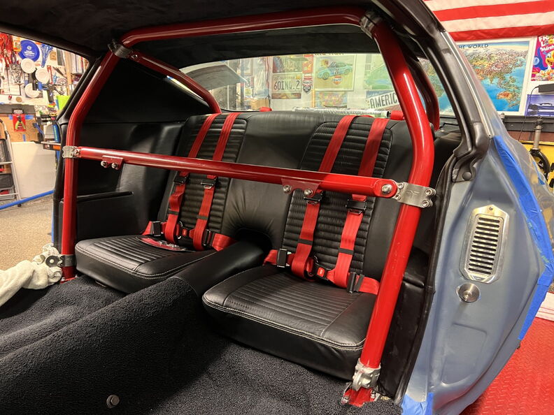

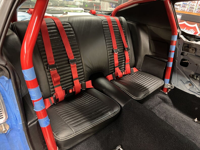

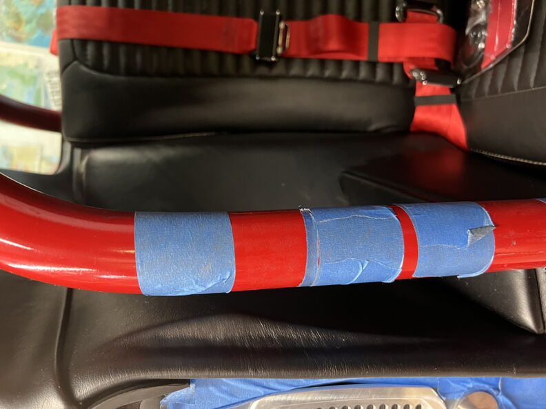

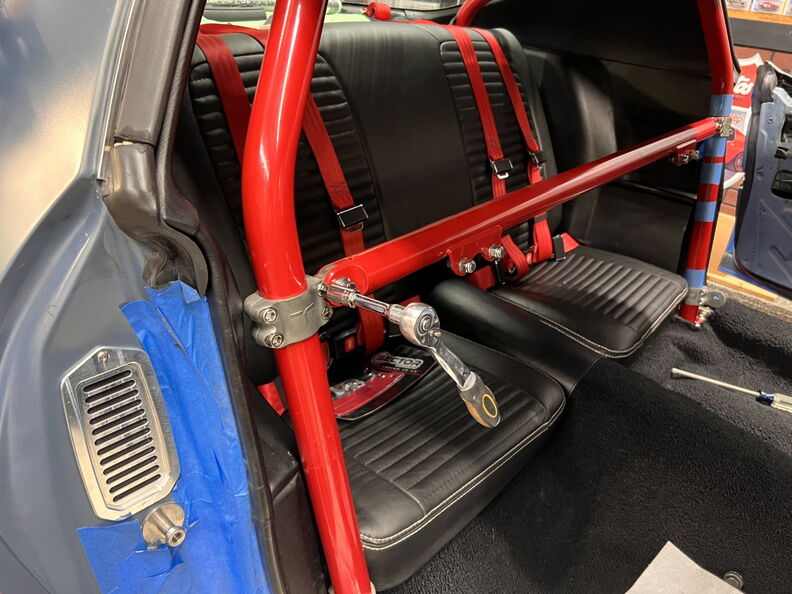

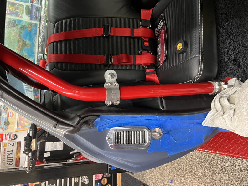

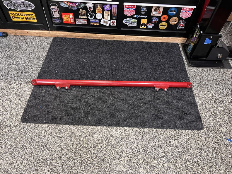

Default Harness Bar (( 07-03-23 )) - After Dinner with my Wife
Remember no matter how small the project is getting just one of them done when you only have an hour.
It's still a completed project.
Thankfully, I used the blue tap as reference marks so it was a simple project.
Tin Man **** !!!
Done and now a quick shower and off to dinner with Mike & his wife.

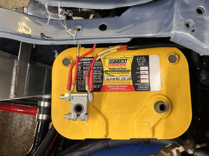

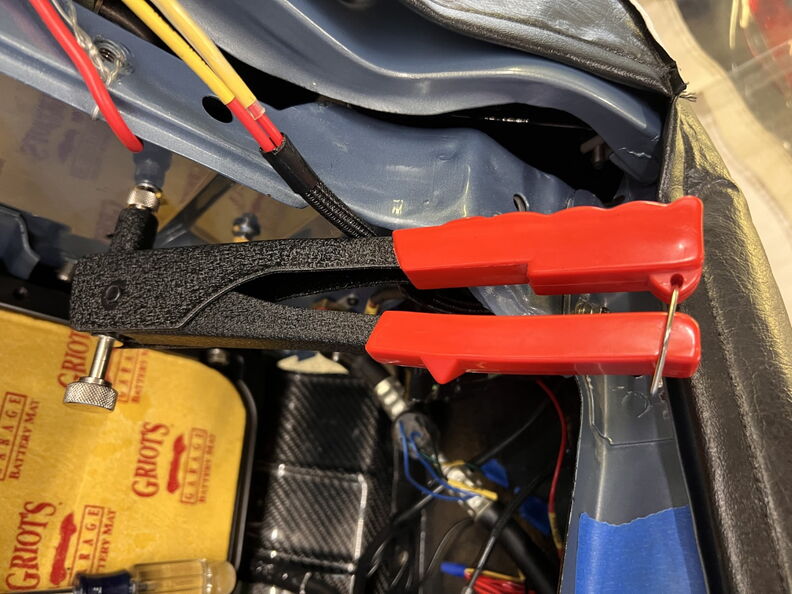

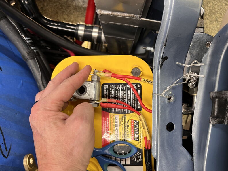

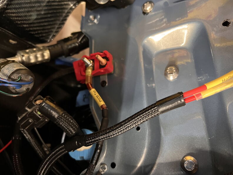

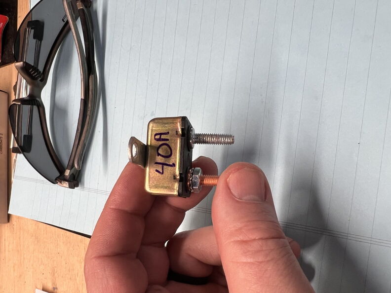

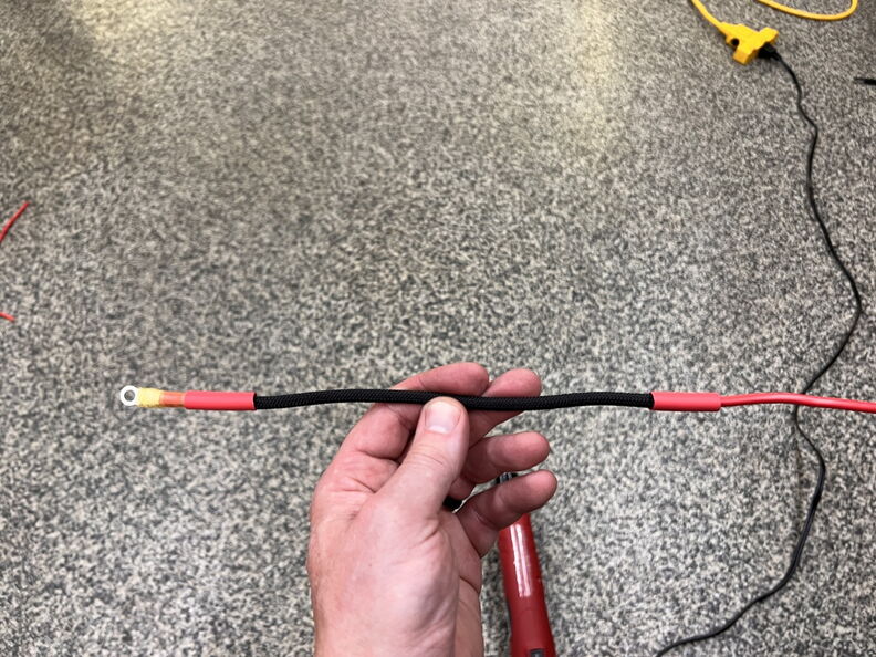

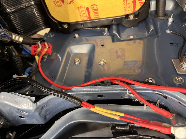

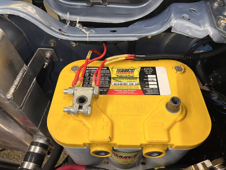

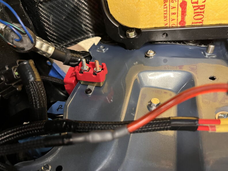

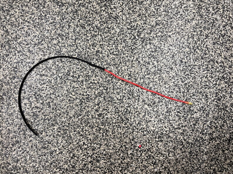

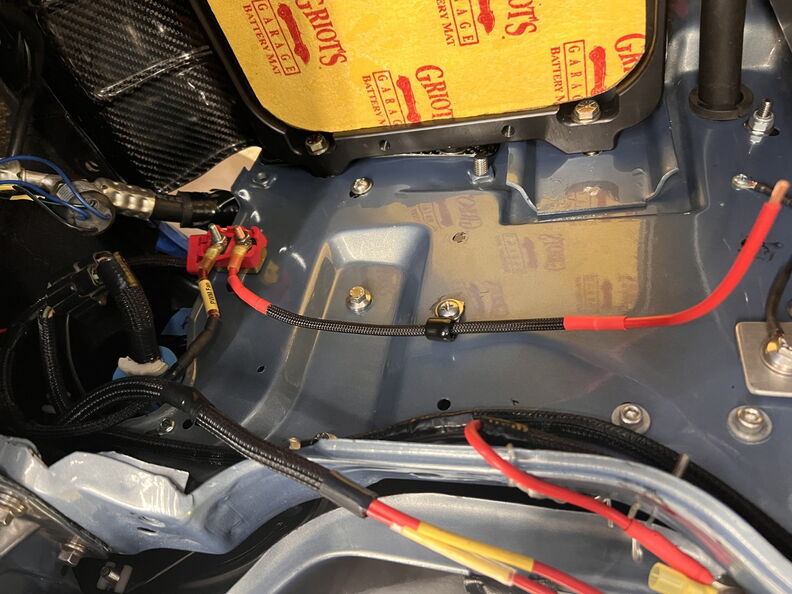

Default Swapping out the Fan Fuse (( 07-04-23 ))

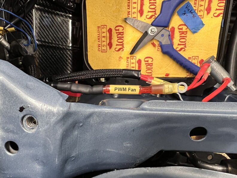

Another simple project that took much longer then I expected.

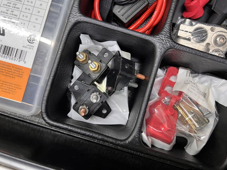

Swapping out the fuse for a circuit breaker.
I love using these washer for grounds on sheet metal.
I needed to borrow the Rubber Booty & the nuts from one of the other circuit breakers. Next car show I go to I am going to buy more of them.
Mounted

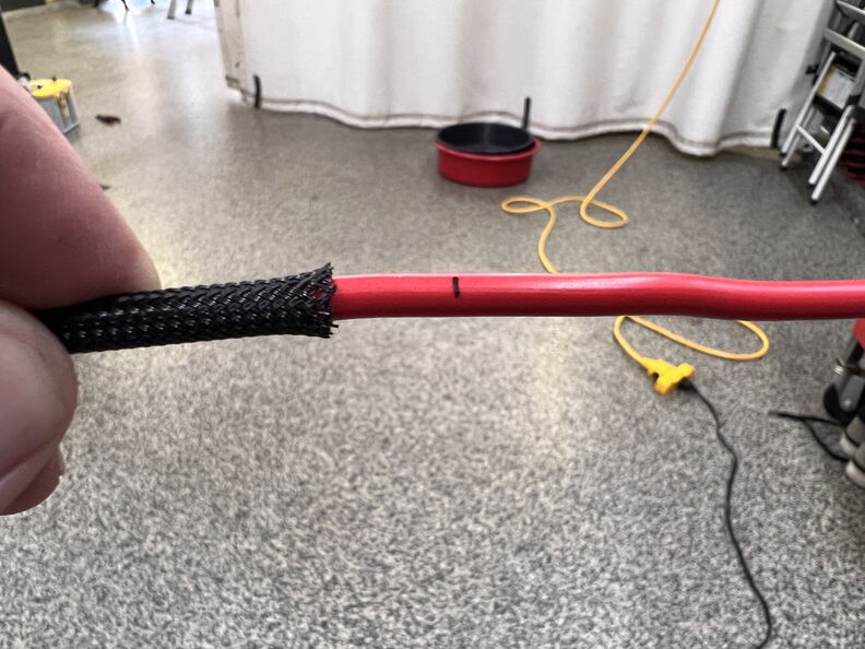

I sleeved the wire with the Tech Flex Abrasion wrap just because it looks better and offers great wire protection.
I use this little trick to make sure I know exactly where the heat shrink needs to start.
My OCD is Killing me
Yep, I have issue's
Being honest I was convince I cut the wire short and thankfully I did not.
Everything I used today just to run one wire.
marty-mj

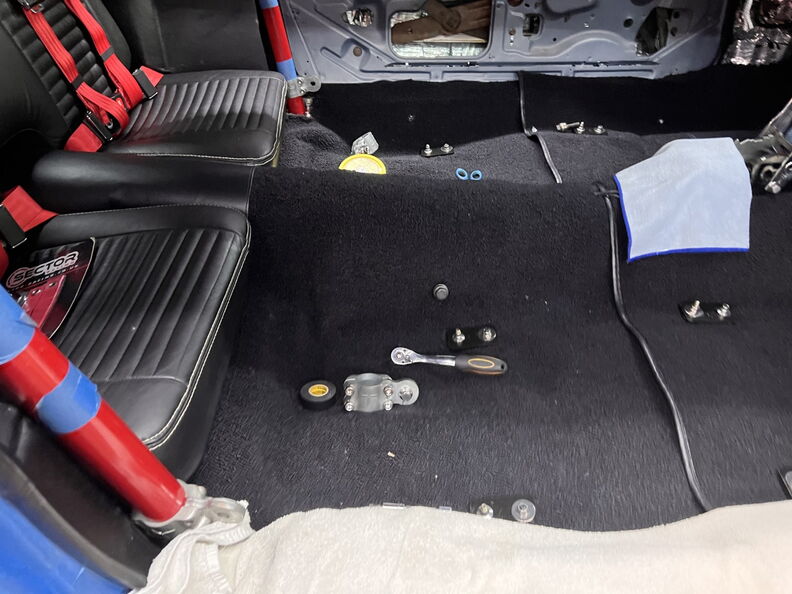

Default Every little project gets me closer (( 07-04-23 )) PM
After dinner I ran out to the garage since I had about an hour before I was going to call it a night. ( Going to Dinner with the Wife ))
It's full
Not sure if I am going to use both door pulls on the car but I have the second set just in case.

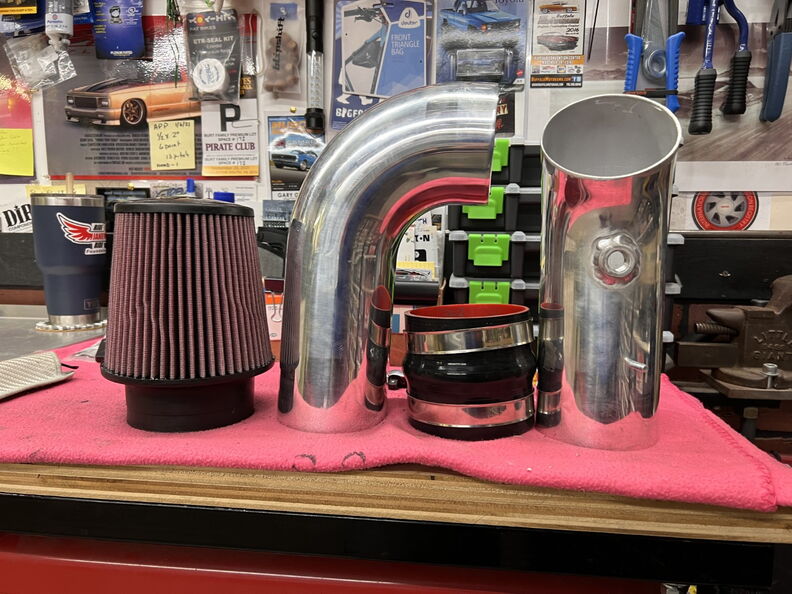

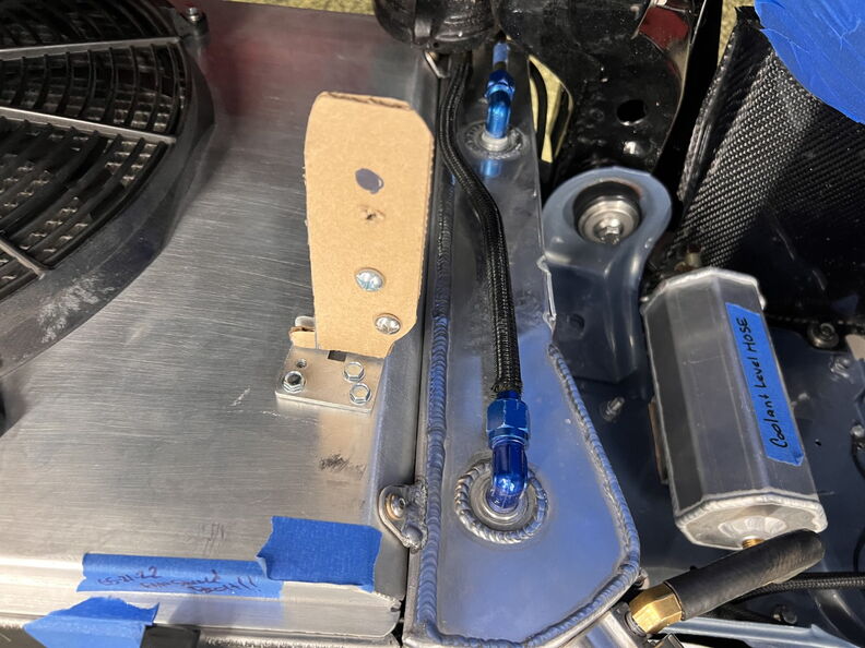

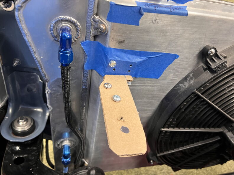

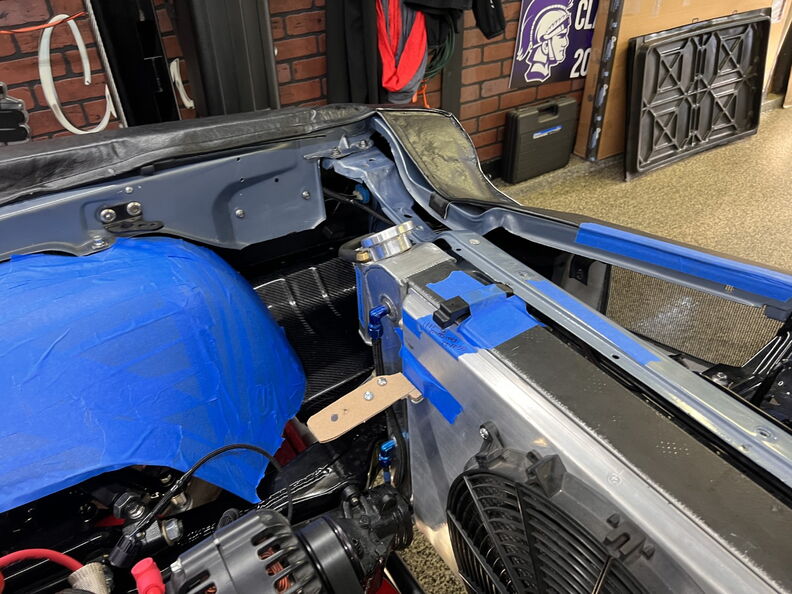

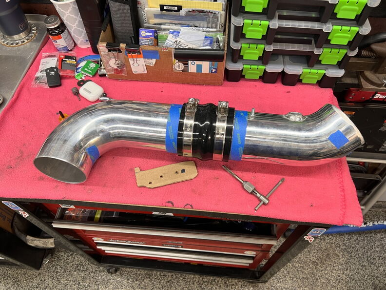

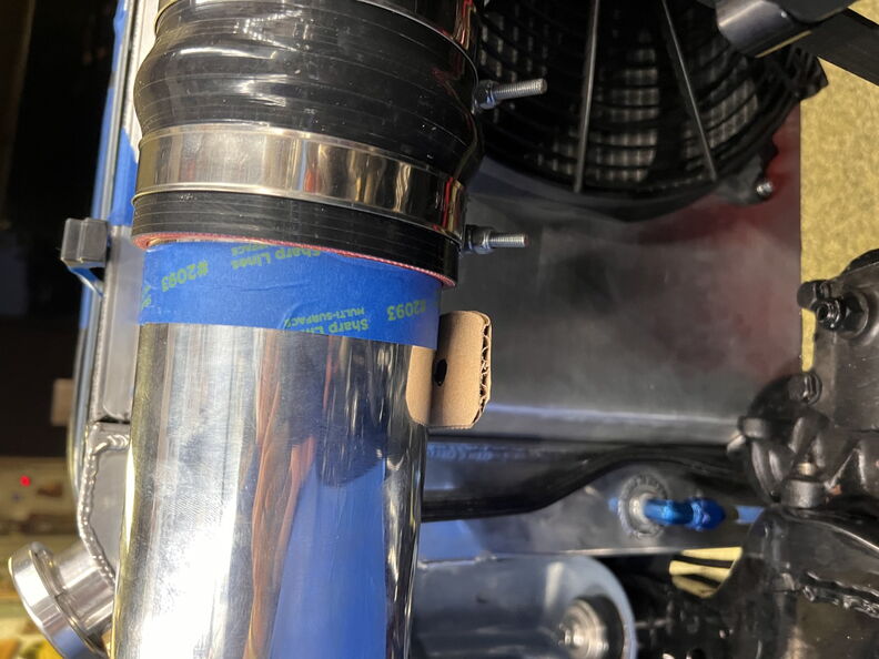

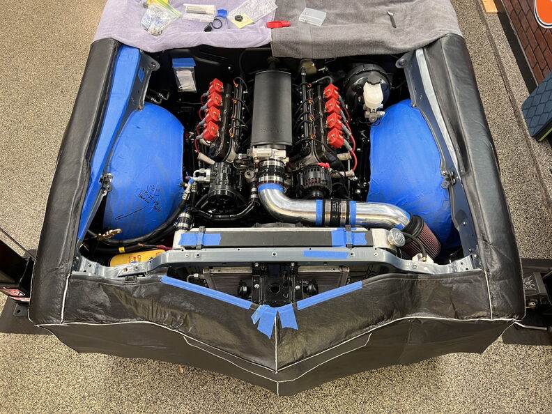

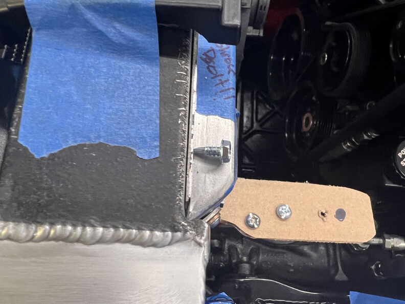

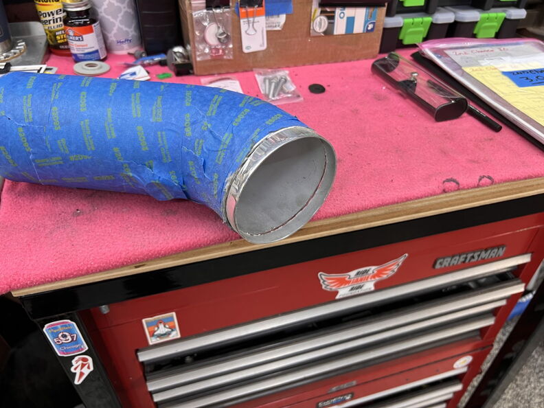

Default Intake Tube Support Bracket (( 07-09-23 ))

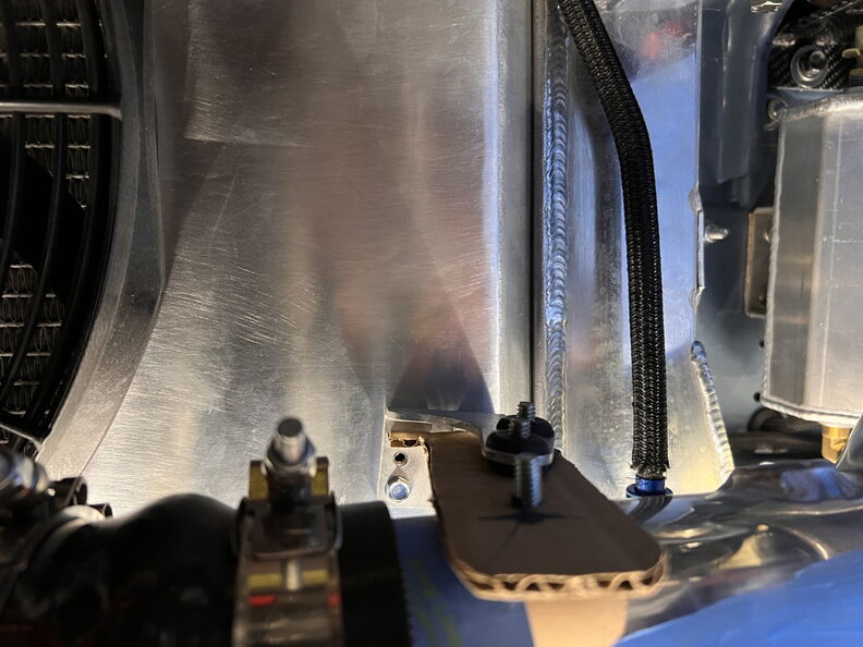

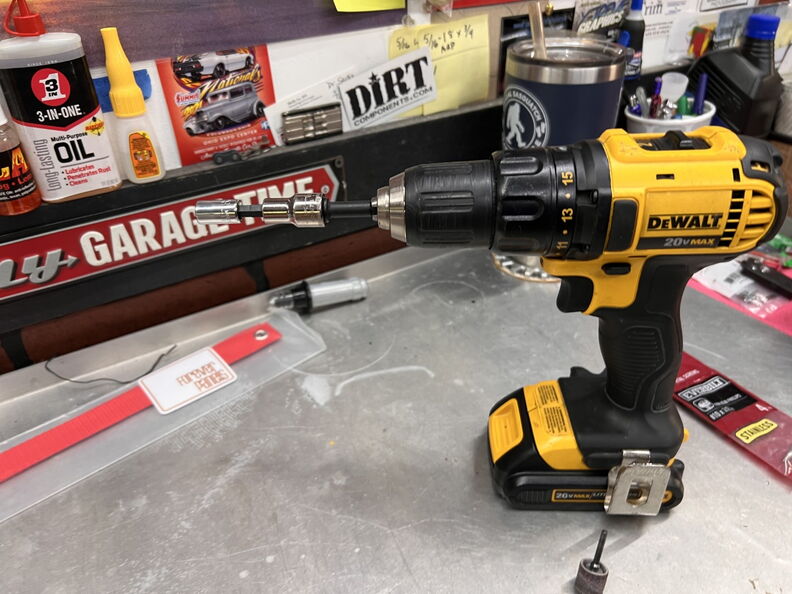

Since the intake tube is just literally just hanging off the throttle body I need to finish the support bracket.

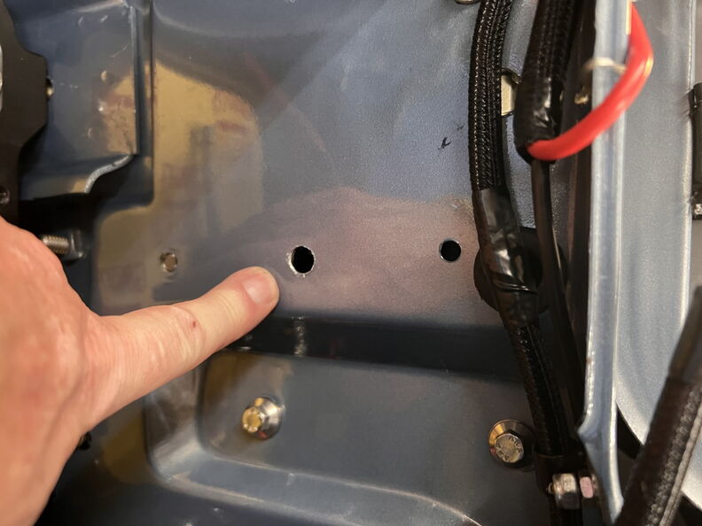

I have desire to remove the fan shroud to make holes so Self-Taping screws to the rescue.
I can't seem to find my 1/4" adapter for my drill so I am going to improvise.
Since the cardboard bracket won't be strong enough I am going to run over to High Speed Welding after work
tomorrow and have him make me an aluminum version.
yep, the screw is just short enough.
Well, I didn't notice it was crocket till I pulled the tape off.
Oddly enough the tube runs up on a slight angle to it works perfect
It's hard to see but there are rubber grommets the bolts go through so I will be using Nylock Nuts so I don't have to
worry about them coming loose. You can also see the bolt that is on the intake tube that I will be using to secure
the intake tube to the bracket.
I am going see if I can find a shorter nut as it doesn't need to be this thick.
Looks like everything worked so off to the powder coater we go.
marty-mj

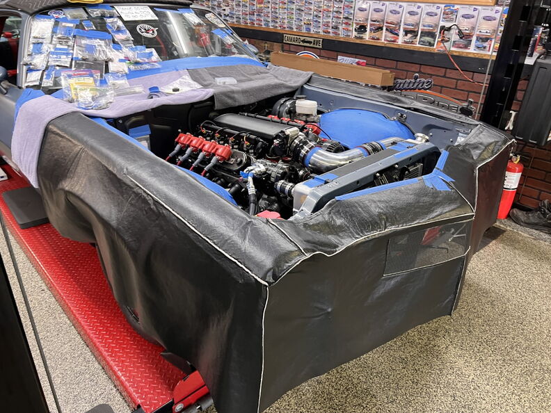

HEY, Marty where did you get the fender cover ??? what is the underneath made for scratches ???
