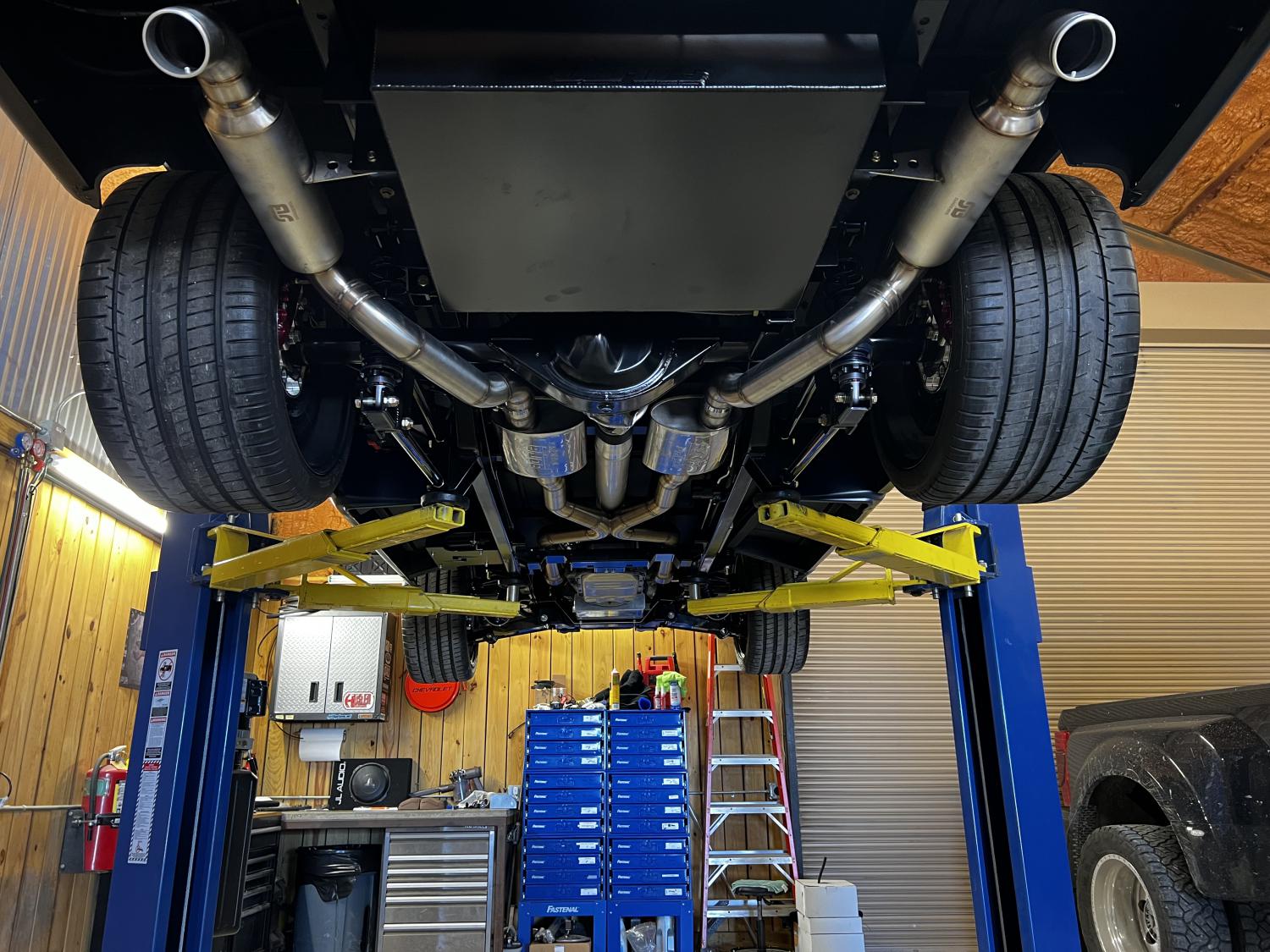

Chassis is ready for the body. Just got the exhaust all finished up and fuel lines ran. Fuel cell by DB Rods and custom driveshaft.
The body has all the rust repair finished and has been matte cleared. The interior and firewall will be painted the OG blue with matte clear also.

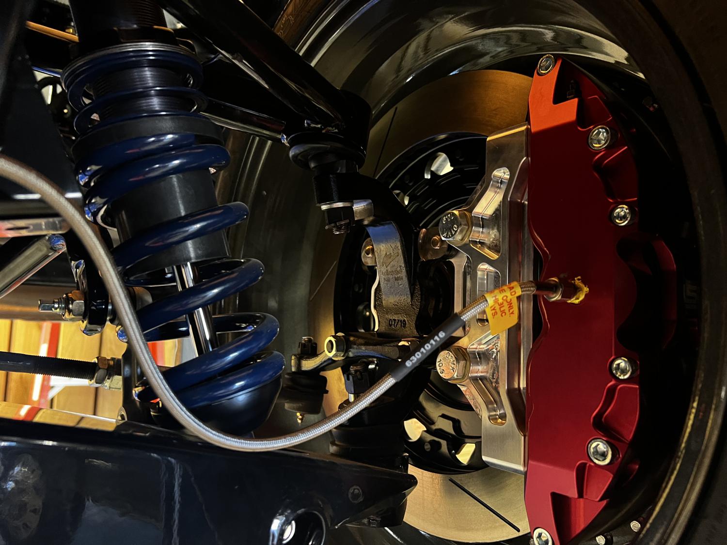

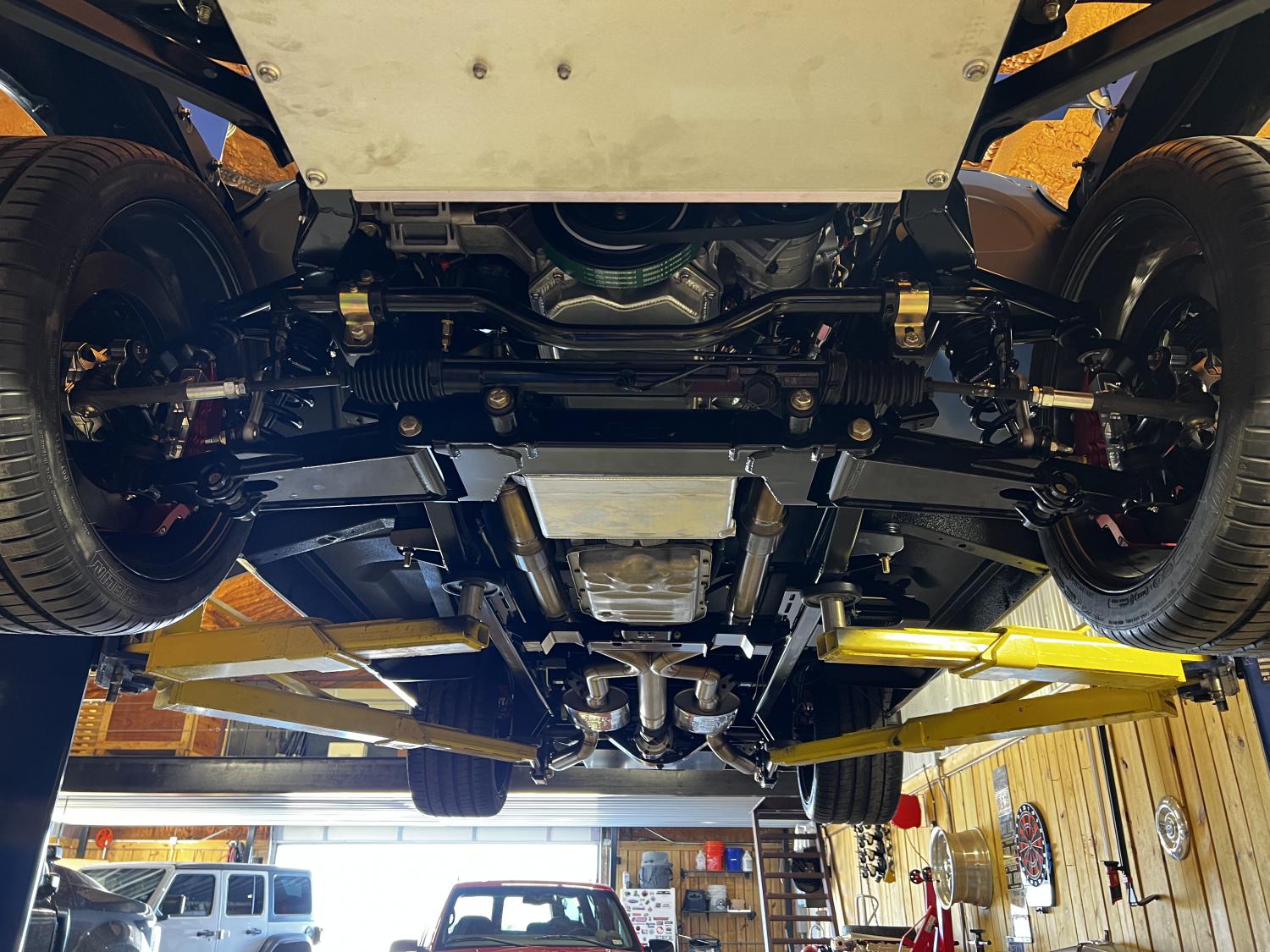

I wanted the truck to sit lower than it was. Had to change to a shorter spring front and rear and added some 0 rate take up springs. Also flipped the front coil over to where the adj nut was up top. It bottomed out on the lower arm with 2” of shock body left when full droop.
Need to adjust the trim and the sheet metal still but it’s getting there.

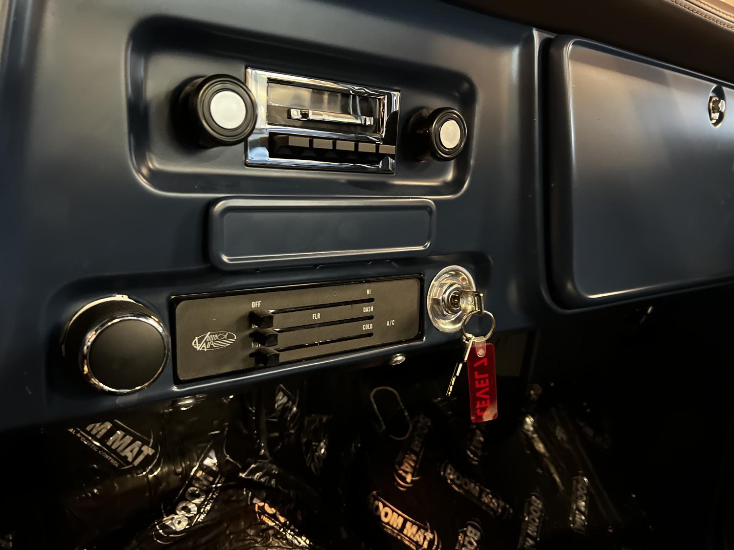

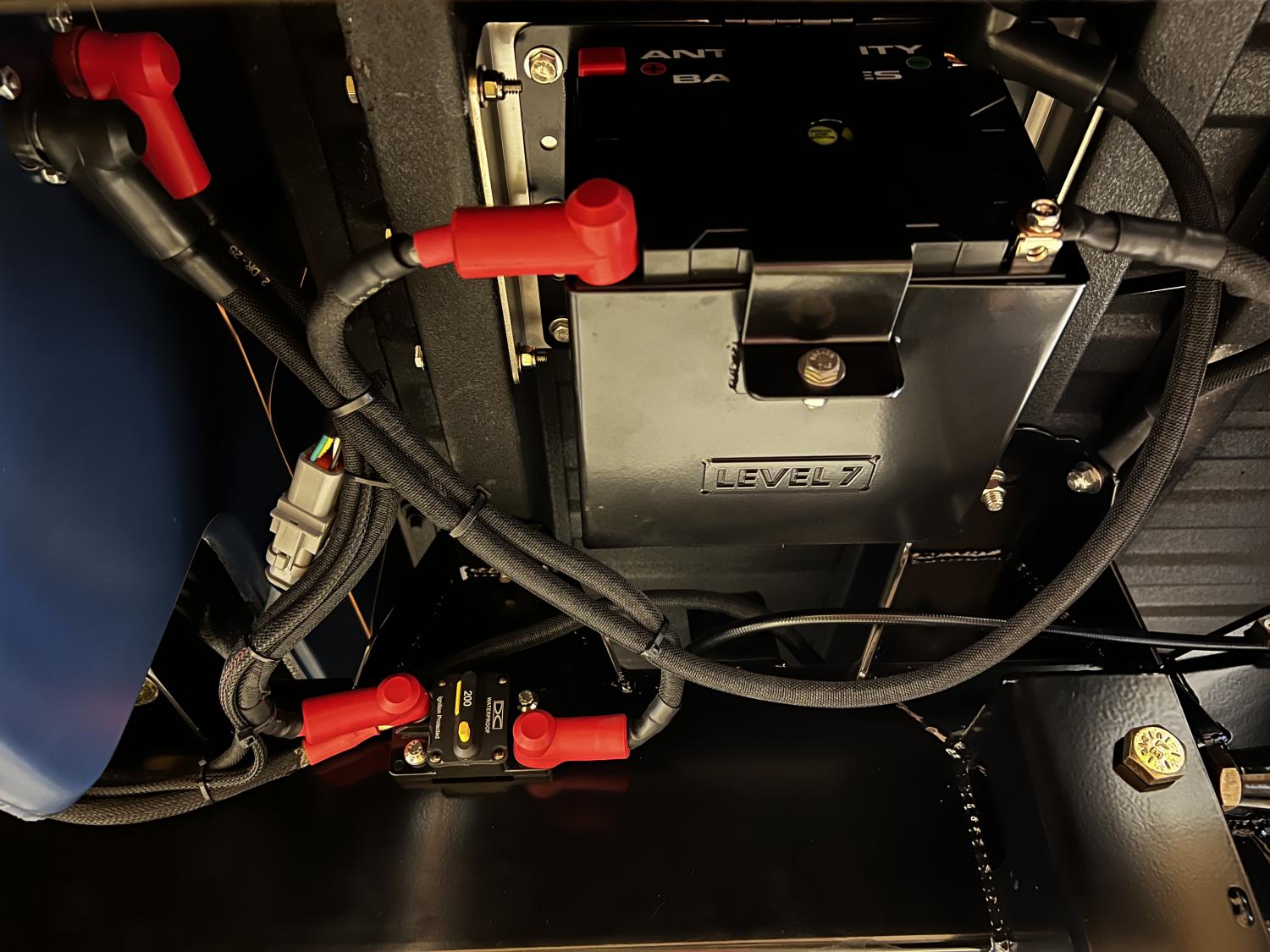

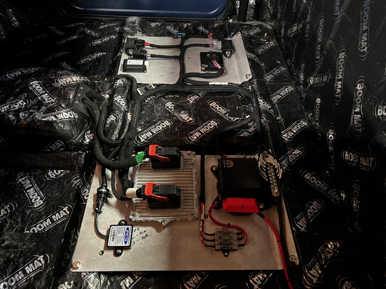

A little wiring action. Should be running by next week.
