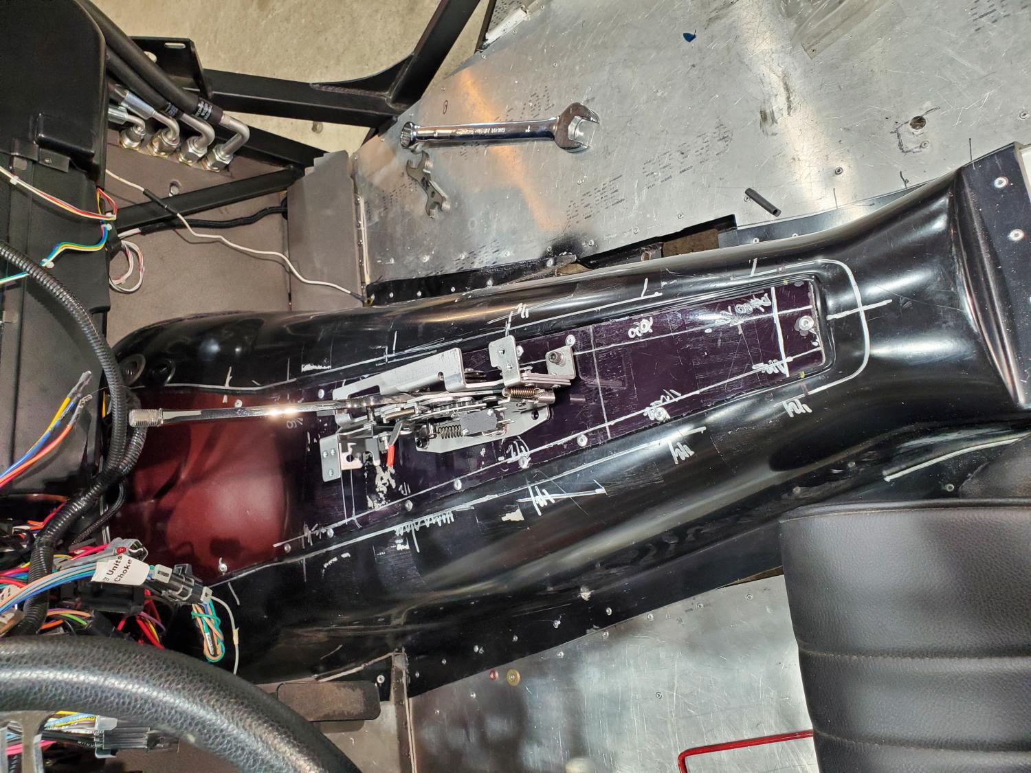

Had to cut that top center section of the trans tunnel to fit the recess, Settled on a shifter location, riv nuts through the fiberglass seemed ok but added some reinforcement to the backside just to be safe.

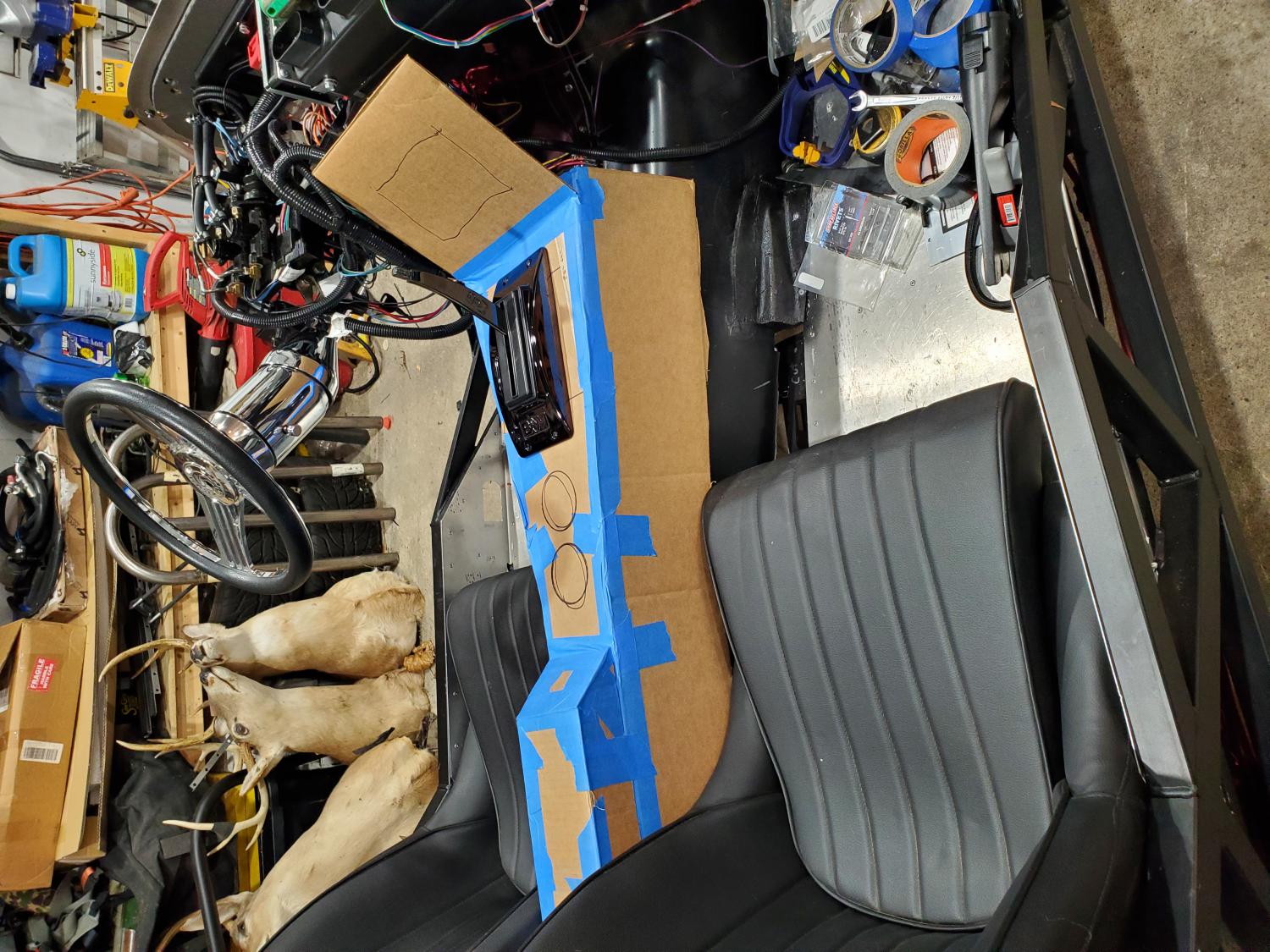

Started working on my idea for a center console with armrest and middle storage

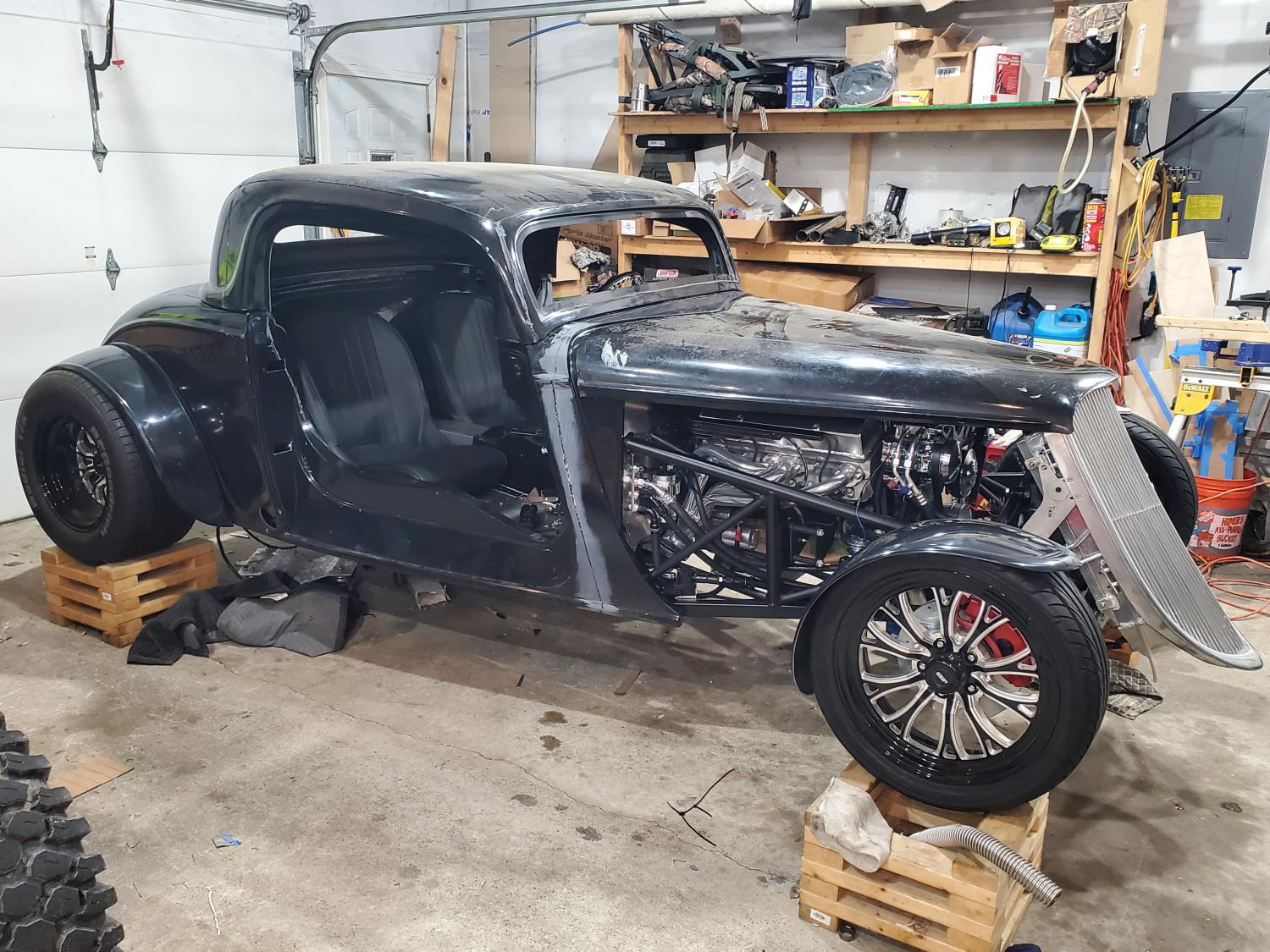

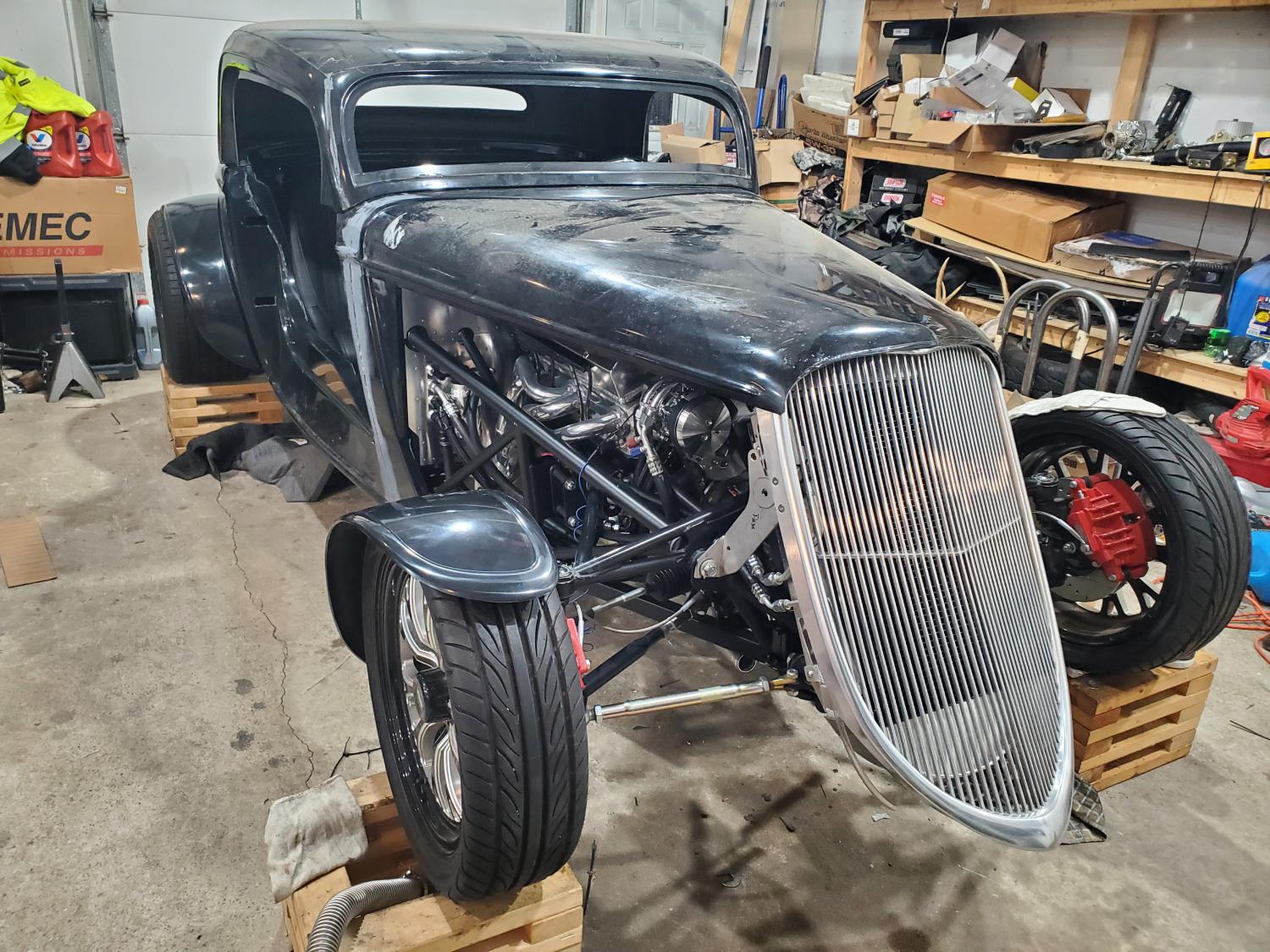

A friend stopped by today so I took full advantage of him and put the body back on. Playing with different looks, with & without hardtop, fenders etc..
(these are not the wheels and tires i'll be running, these are just for rollers)

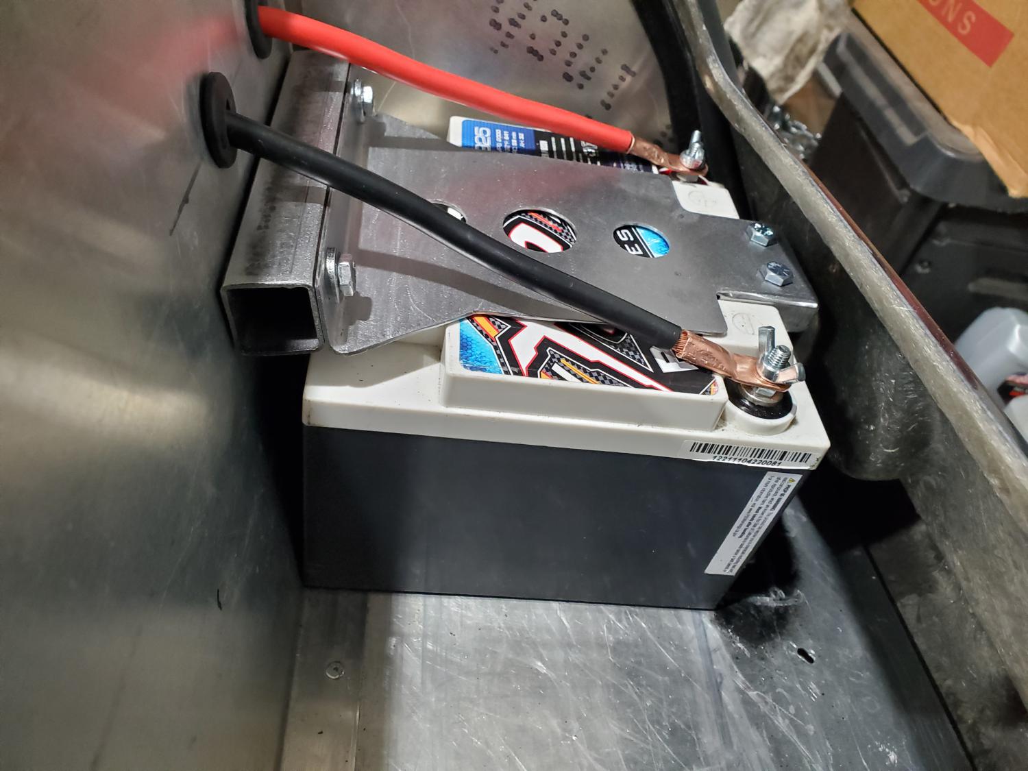

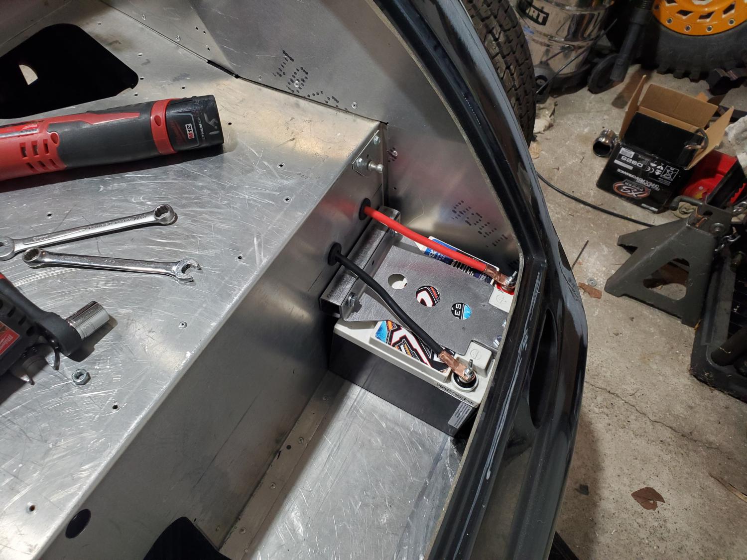

Made a battery hold down and moved it to a corner of the trunk area.
