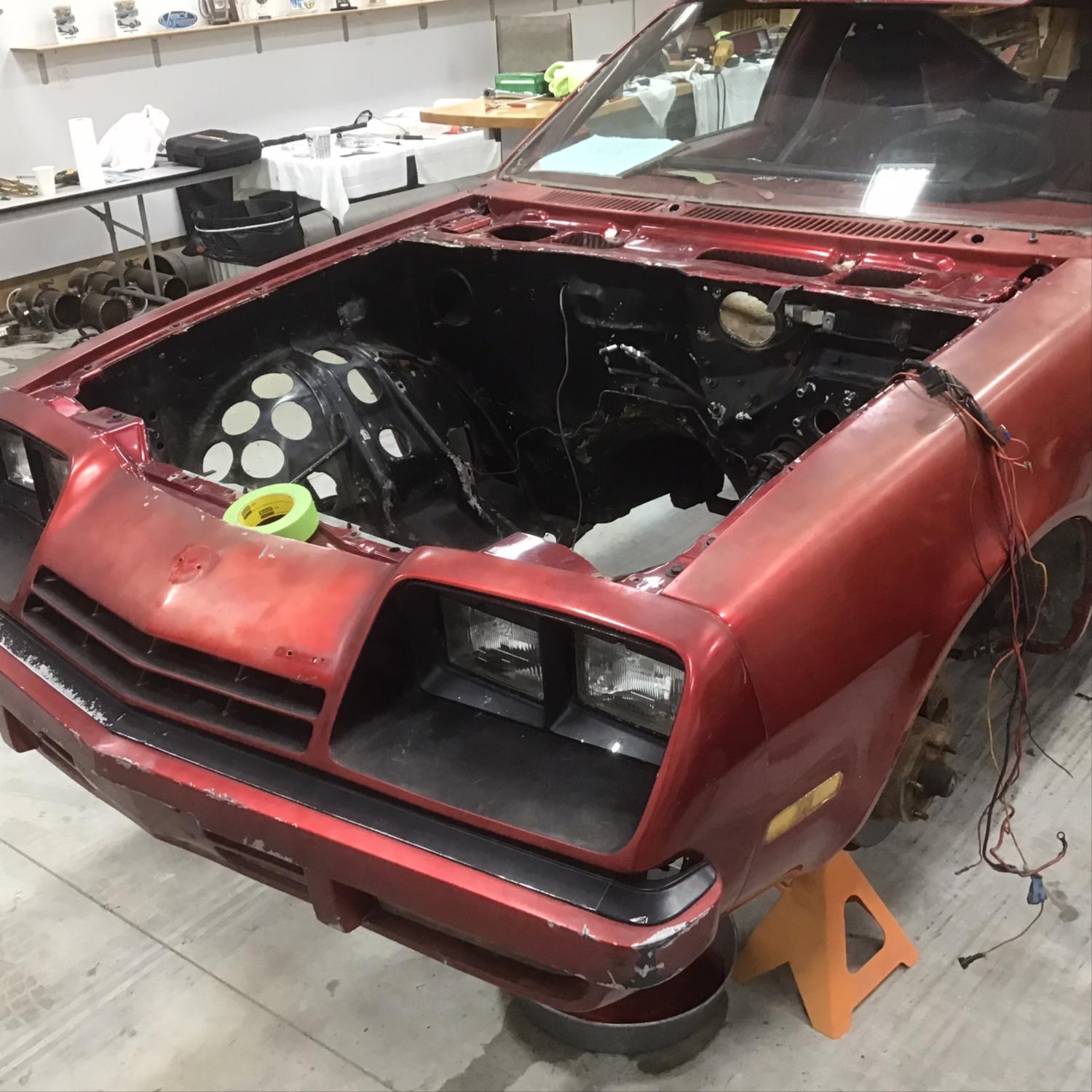

Default MONZA shows a unique history
Remember JC Whitney, the coolest magazine with hot rod parts?
Upon Monza disassembly, we discovered a genuine JC W. Line-Lok.
It gets better.., check out the 17 holes somebody drilled into the fender wells. We’re talking 3” diameter.
Now since a Monza has no frame or subframe, and the fender wells are STRUCTURE, I am welding all 17 holes shut.
Ironically, I found A36 alloy steel 3” circles in diameter at .125” thick from Amazon! For cheap.., I bought 17.
