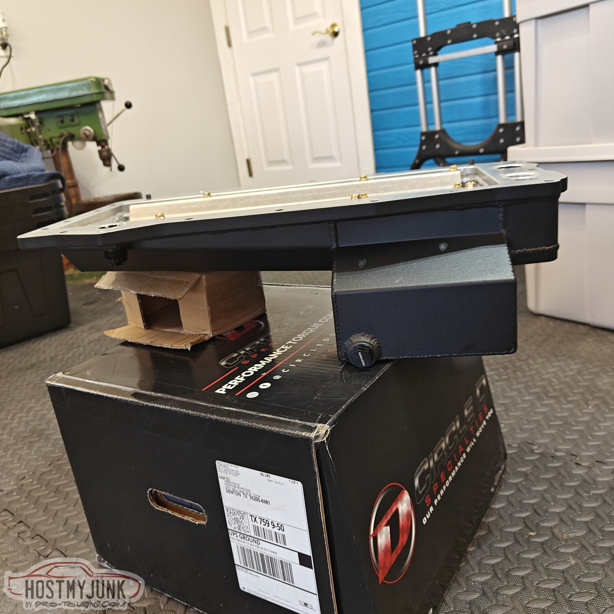

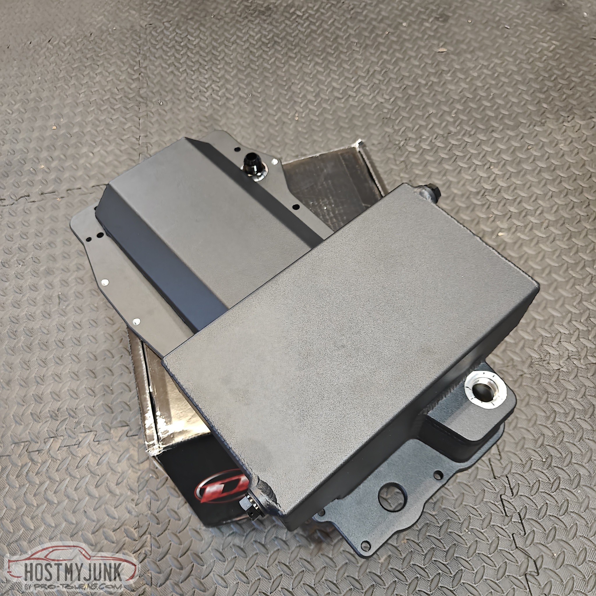

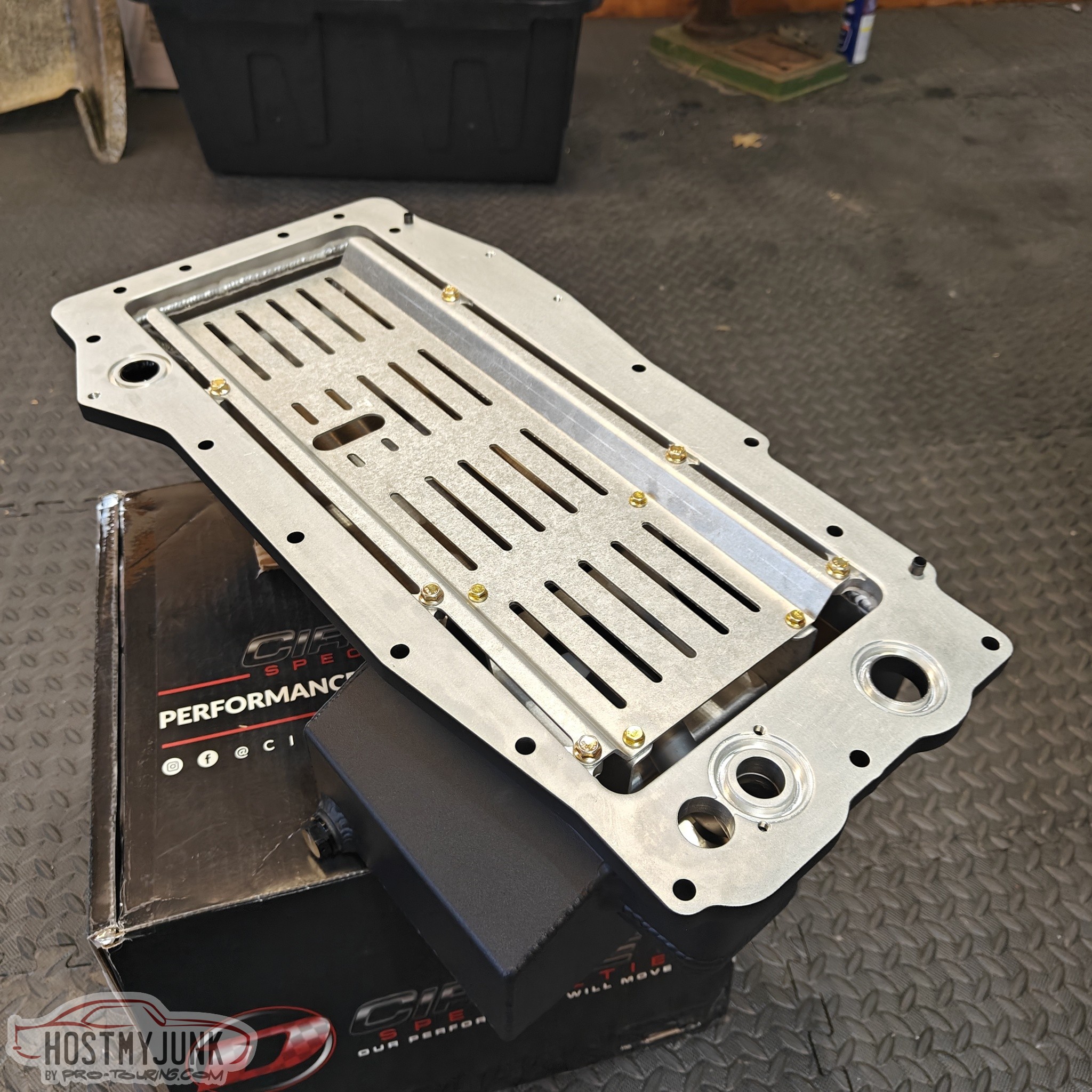

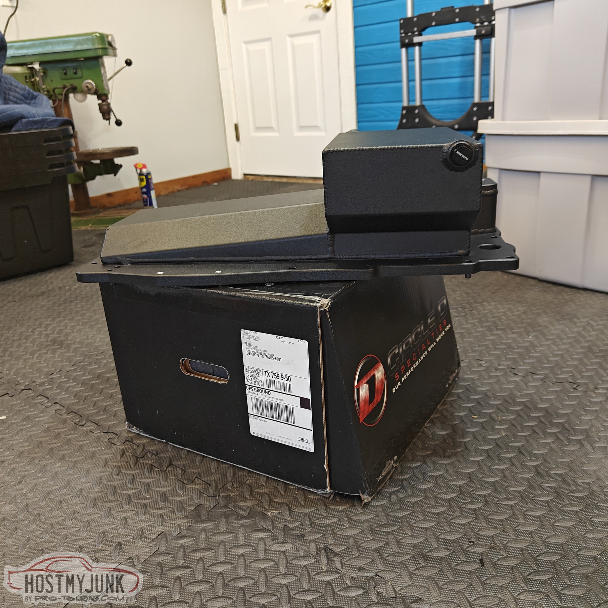

There is nothing like a slow moving project, but progress is being made.
Today I received a critical part of the swap, which is a front sump oil pan from Crowbar Customs.
https://www.crowbarcustoms.com/produ...-and-oil-pump/
I am pleased with the overall quality and the finish. This pan will require a remote mounted filter and it is designed to be used with the Holley front cover and oil pump arrangement.
Andrew
