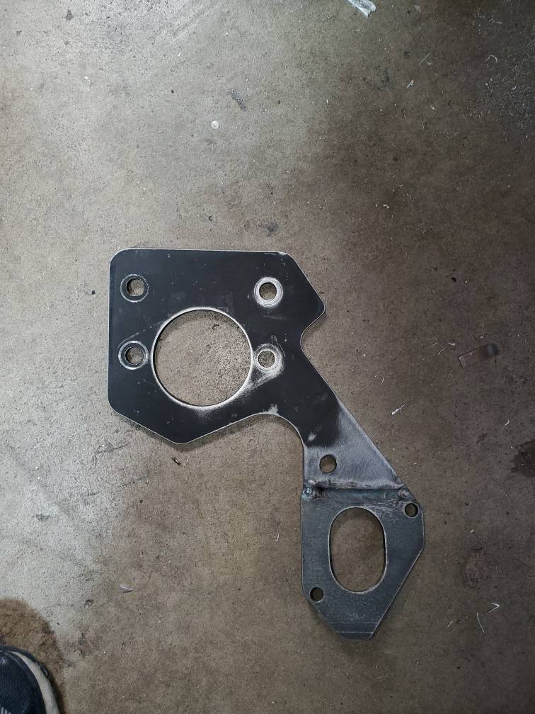

Just want to say thanks for the wealth of info that you share with your builds. I'm currently redoing my 1960 Impala hardtop and your clutch geometry explanation has been a god send. I actually had a used 4th gen pedal assembly from a T56 I bought to copy and I made a firewall bracket like the detriot speed.
