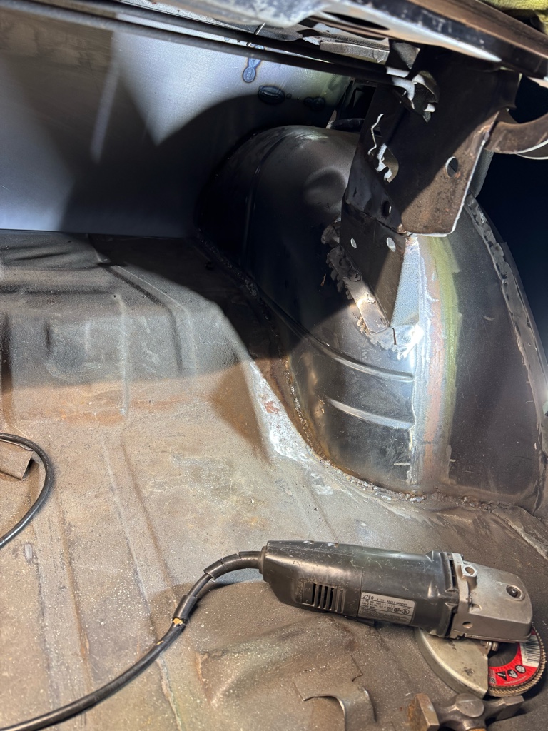

Got both trunk hinge supports welded back in. The trunk area seems to be complete. Trying to decide if I’m going to leave the jack and spare tire mounts on the floor.
Still waiting on metal for the trans tunnel. Hopefully it will be ready next week. Name:  IMG_2092.jpg

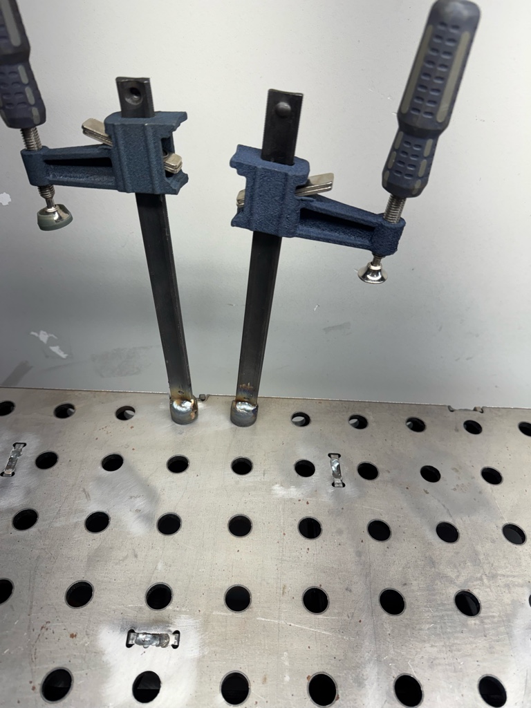

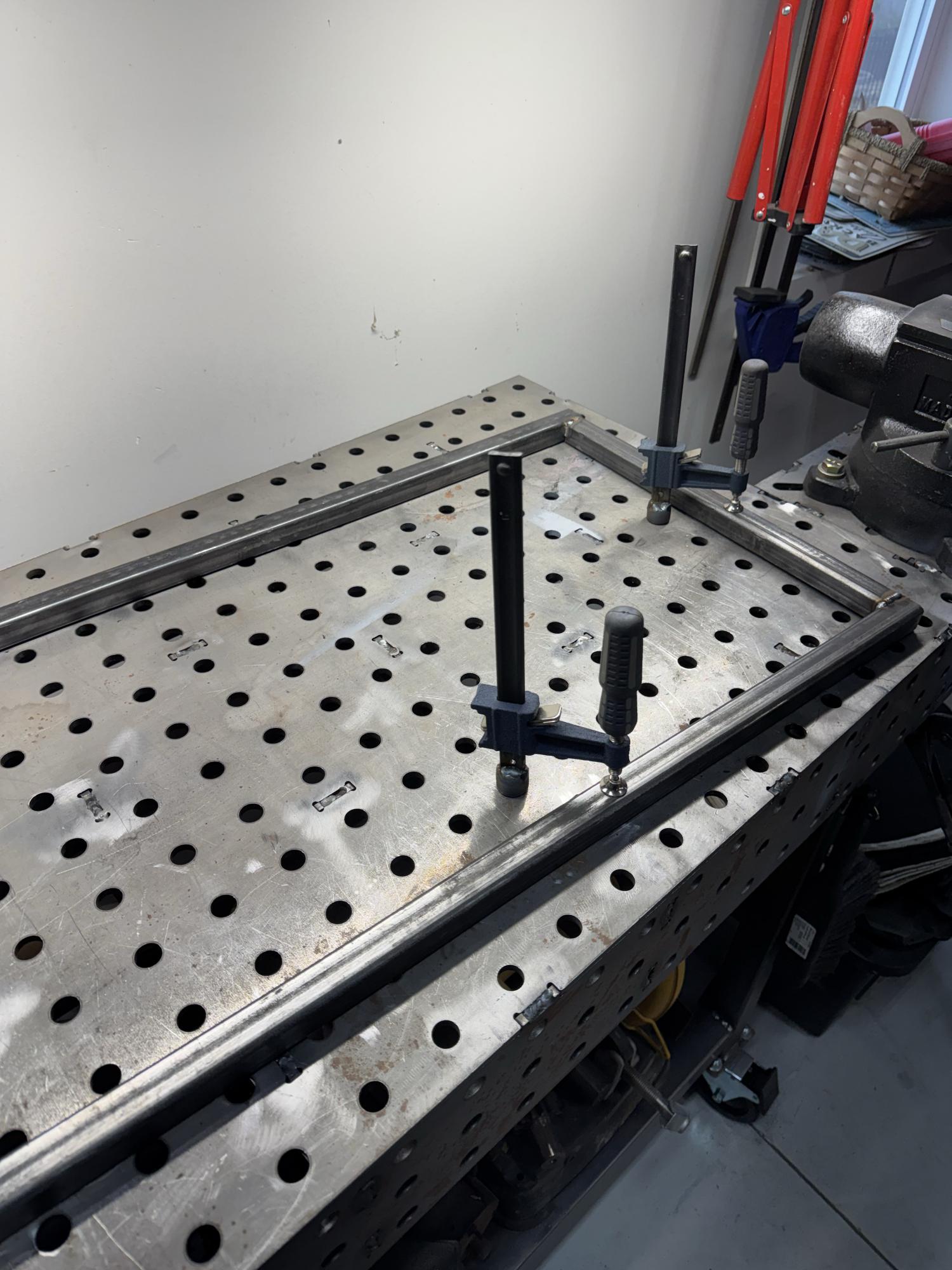

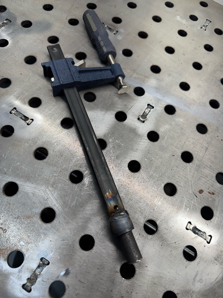

Also finally made a couple of clamps for the weld table.

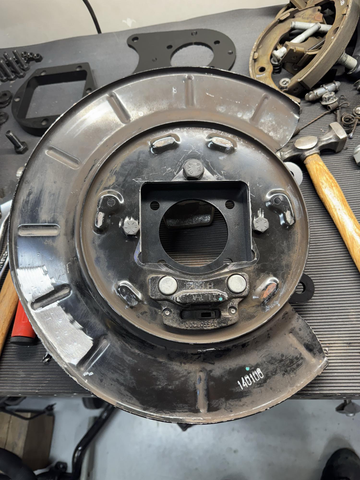

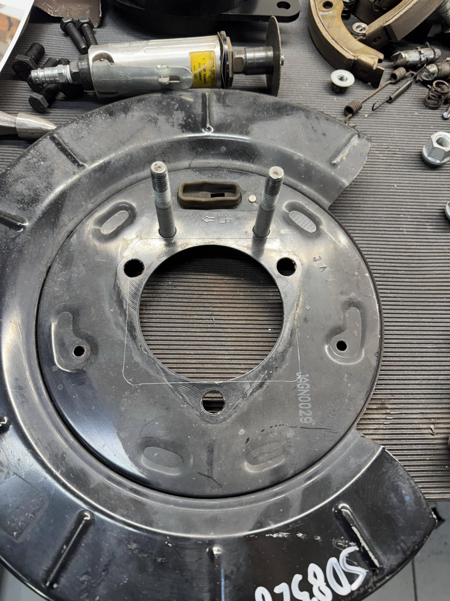

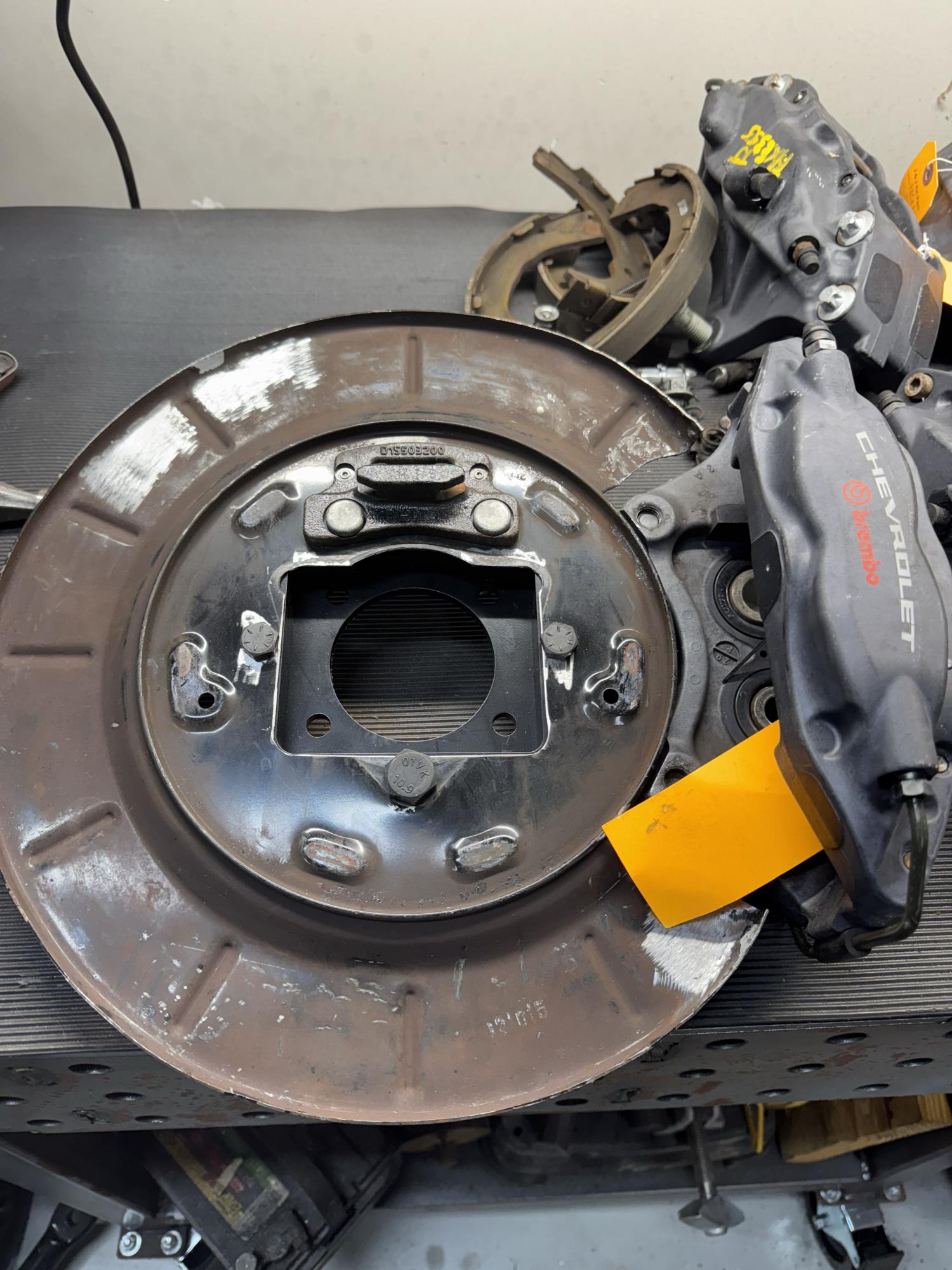

Searched for brake information in the brakes section of Lateral-g. Received some very good information about a company called BigBrakeUpgrade.
They were very helpful in getting information to me and walking me through the process of modifying Camaro brake backing plates to fit a 12-bolt GM rearend.
Sent from my iPhone using TapatalkName:  IMG_2121.jpg

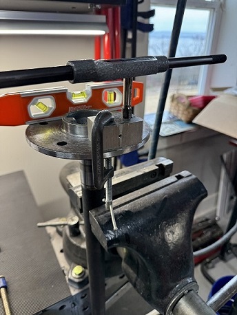

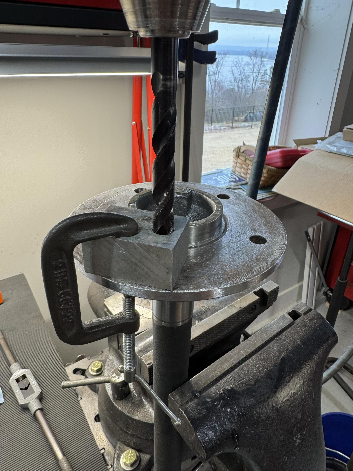

Got the axles back from the machine shop and set up to drill and tap for new 12” studs. Made a block to ensure that the drill and tap went in straight. Name:  IMG_2145.jpg

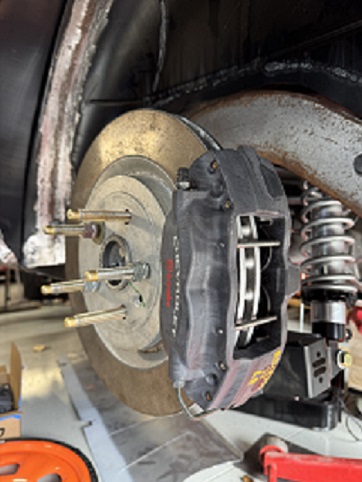

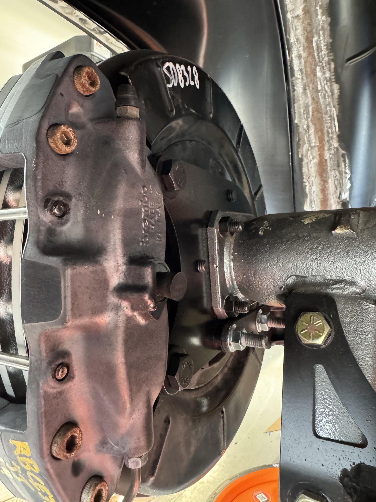

Got the backing plates installed and the axles in. Mounted the rotors and the new calipers. Name:  IMG_2148.jpg

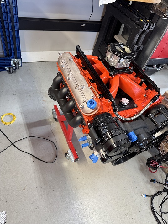

Also got the new exhaust manifolds and installed on the engine. Tried to put the picture in, but Tapatalk seems to not like to do that.

Tapping the axles

Pictures of the rotors and calipers installed.

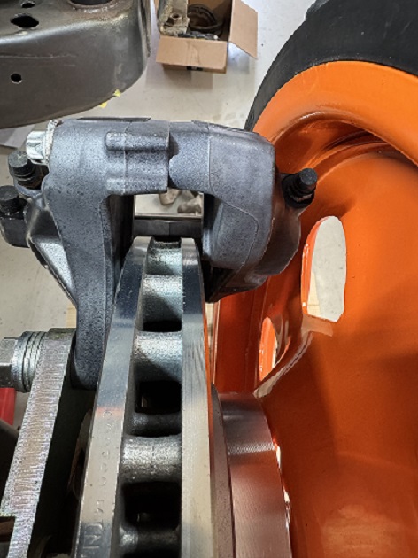

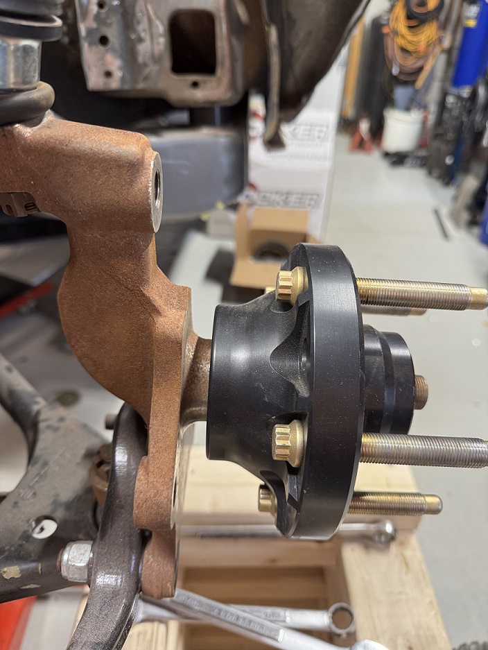

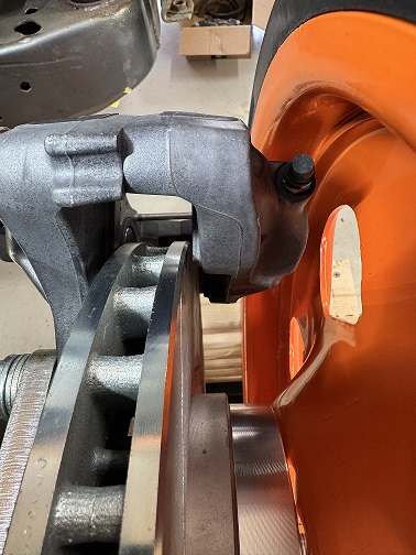

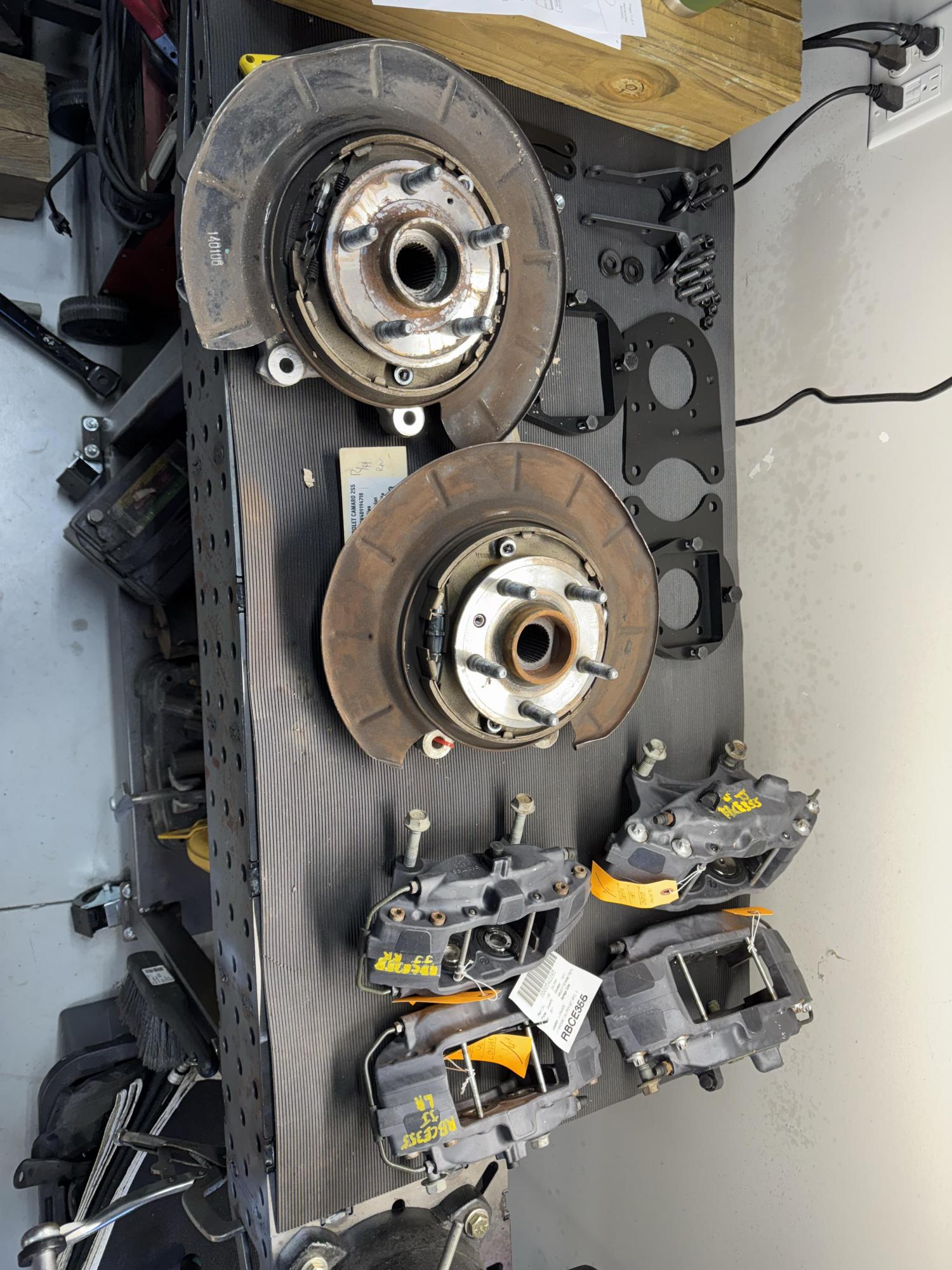

Moving forward to the front brakes. The previous brackets will not work with the new calipers. Contacted BIGBRAKEUPGRADE.COM and the correct brackets will be here this week.
