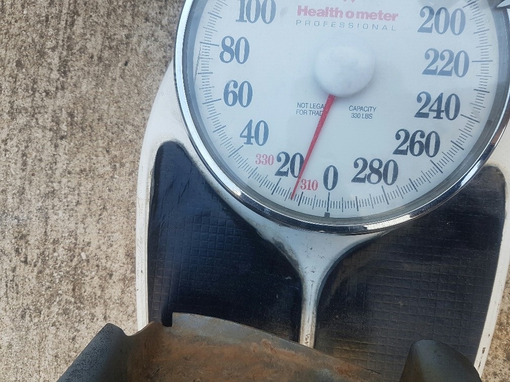

steel impact weighs in at 22lbs aluminum is 13lbs

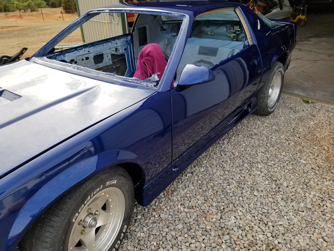

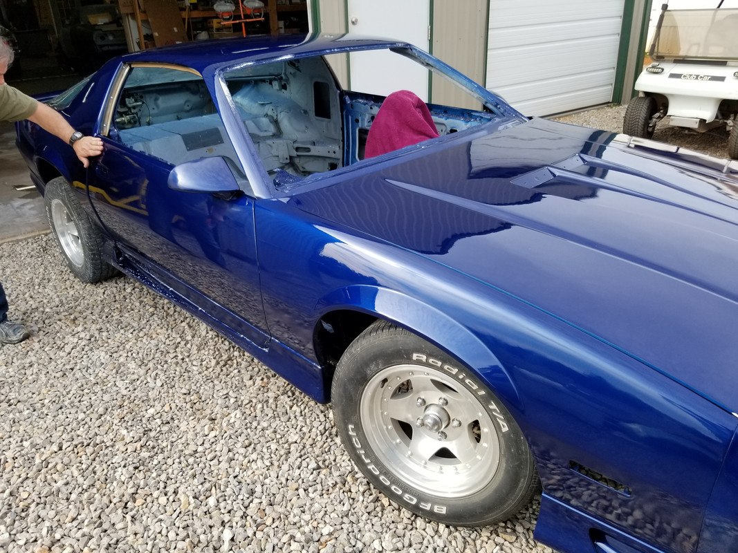

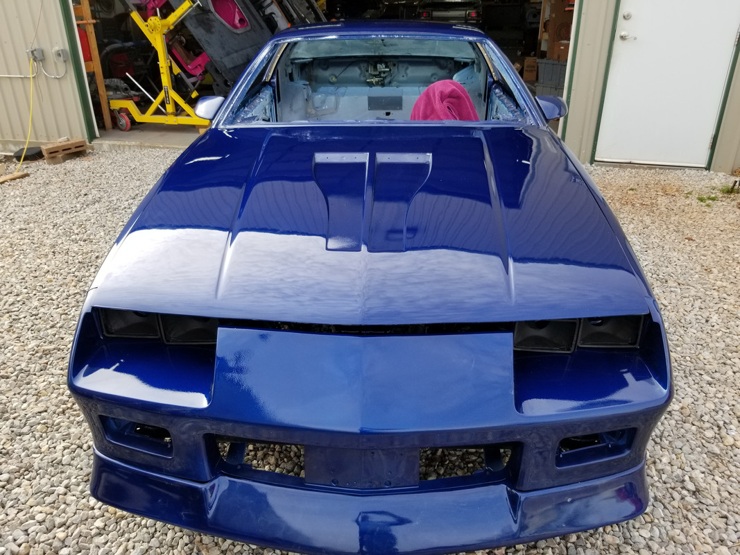

Just got back from the painter. Almost ready to go home!!
Marked a few places that needed a bit more attention. (The plastics aren't cut & buffed yet either)

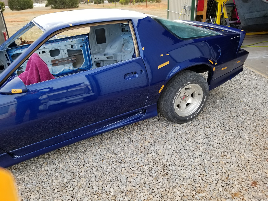

I've put in more hours working from home the past month than I usually do in the office. That and spring cleaning around the property has kept me from making much progress.
The car is home from paint and assembly in under way!
