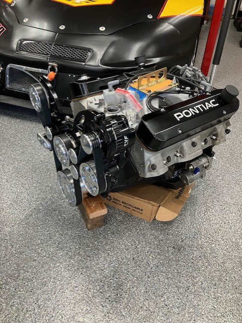

Old 06-16-2025, 11:25 AM
Panteracer's Avatar
Panteracer Panteracer is offline
Join Date: Oct 2013
Location: SF bay area
Posts: 1,169
Thanked 250 Times in 108 Posts
Default DREAMIN TA 2
Been working on getting the Pantera going
and when talking to my engine builder he told
me about a 467 Pontiac engine he just built
Butler insides, edelbrock heads, etc etc
Killer deal but sniper and front pulley system
are going... not my thing.. up for sale at 1/2 the
price of new
It made 434hp at the wheels and the guy
wants more power... building him a big block chevy
Perfect for my WS7 1979 Ta.. don't want to break
the auto and 10 bolt for my cruiser.... another project
Bob
