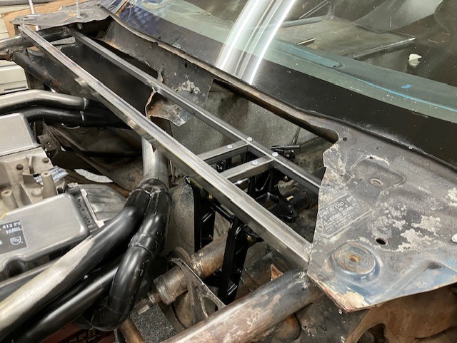

Been working away on the pedal mounts
and firewall rework... Trying to cover up
the ugly and get a nice pedal feel
Wilwoods overhead with remote reservoirs
to clean up the firewall.. moved the steering
column over and back since the seat is moved back
Next is starting to put metal around the header etc

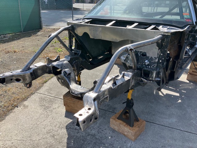

Buddy and I were wire wheeling the world this past weekend
most of the crud is gone.... welded in some additional bracing
including a bar between the high rear shock mounts
Hopefully throw some paint on it next weekend

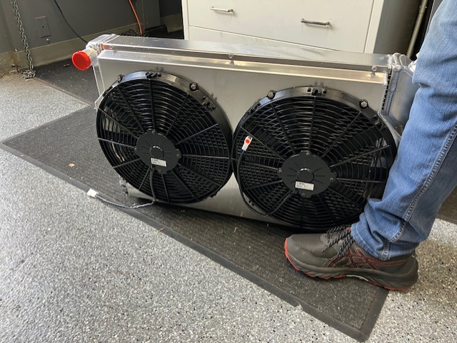

Parts are starting to come in for the CP Camaro
New radiator, CVF elect water pump, alt, Ps with
serpentine belts... a bunch more from Summit later today
Bob

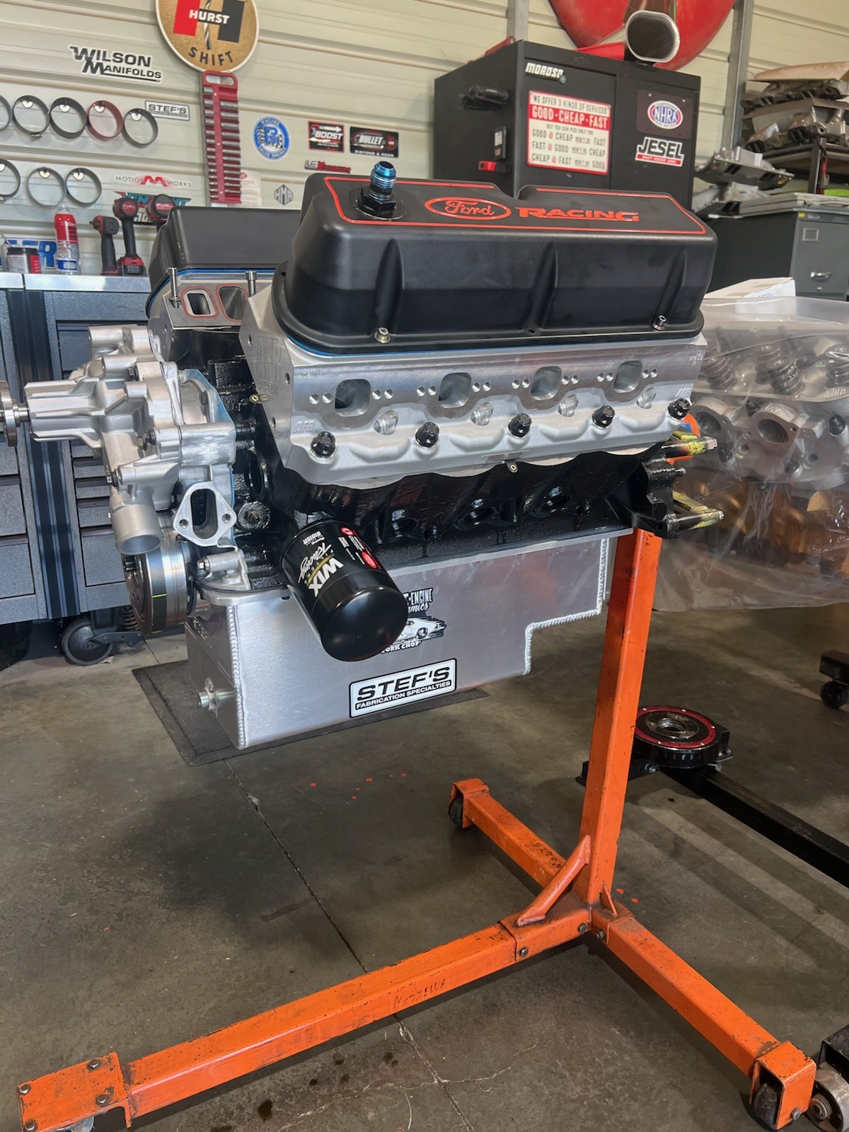

from the Cp Camaro.... Pantera engine
is going on the run stand next week....
SS headers shipping the next week
406 Dart block, AFR heads, scat crank,
LA Billet rods, Race tech pistons, Billet
solid roller, shaft rockers and a Stef's pan
Cam is a little aggressive but you only live once
Bob
