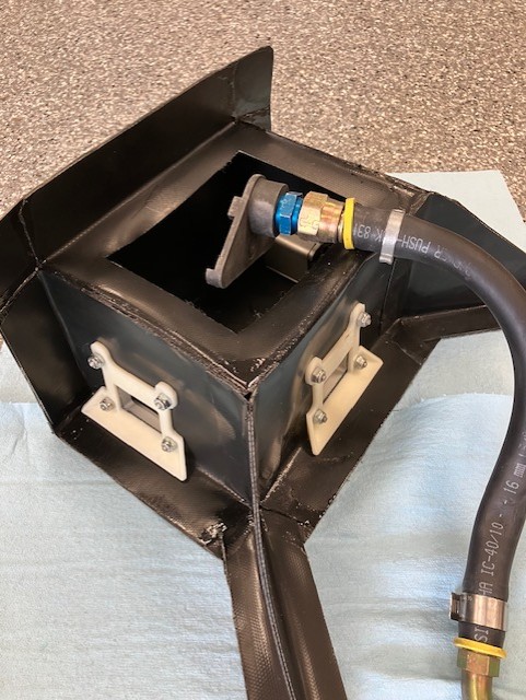

Fuel cell started leaking at the top
seams.. 2015 date so it is time to replace
I am getting a plastic tank and putting
all the guts from the Fuel Safe inside
Picture of pickup sump... I thought it was
pretty cool
Bob
