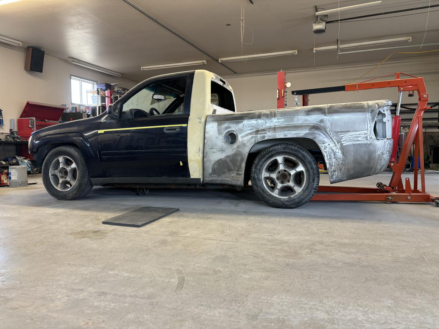

Been off the site for quite a while, but I started a new project. It’s not a G machine by no means and I had no intention of making it real nice, but I ended up going farther than I anticipated. I’ve had a weird attraction to the trailblazer SS especially the lowered ones and I thought one might look cool as a pickup. So here goes.

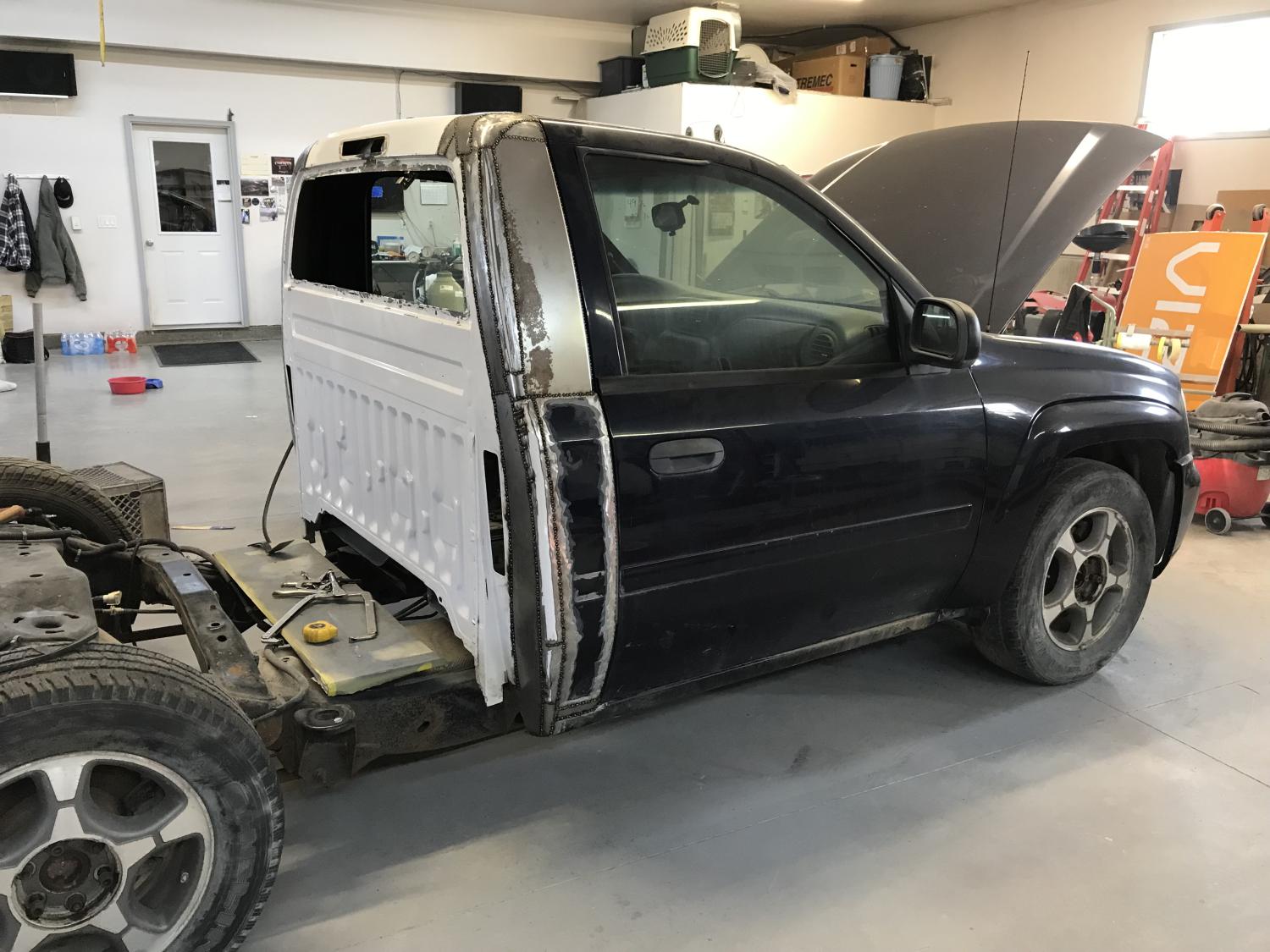

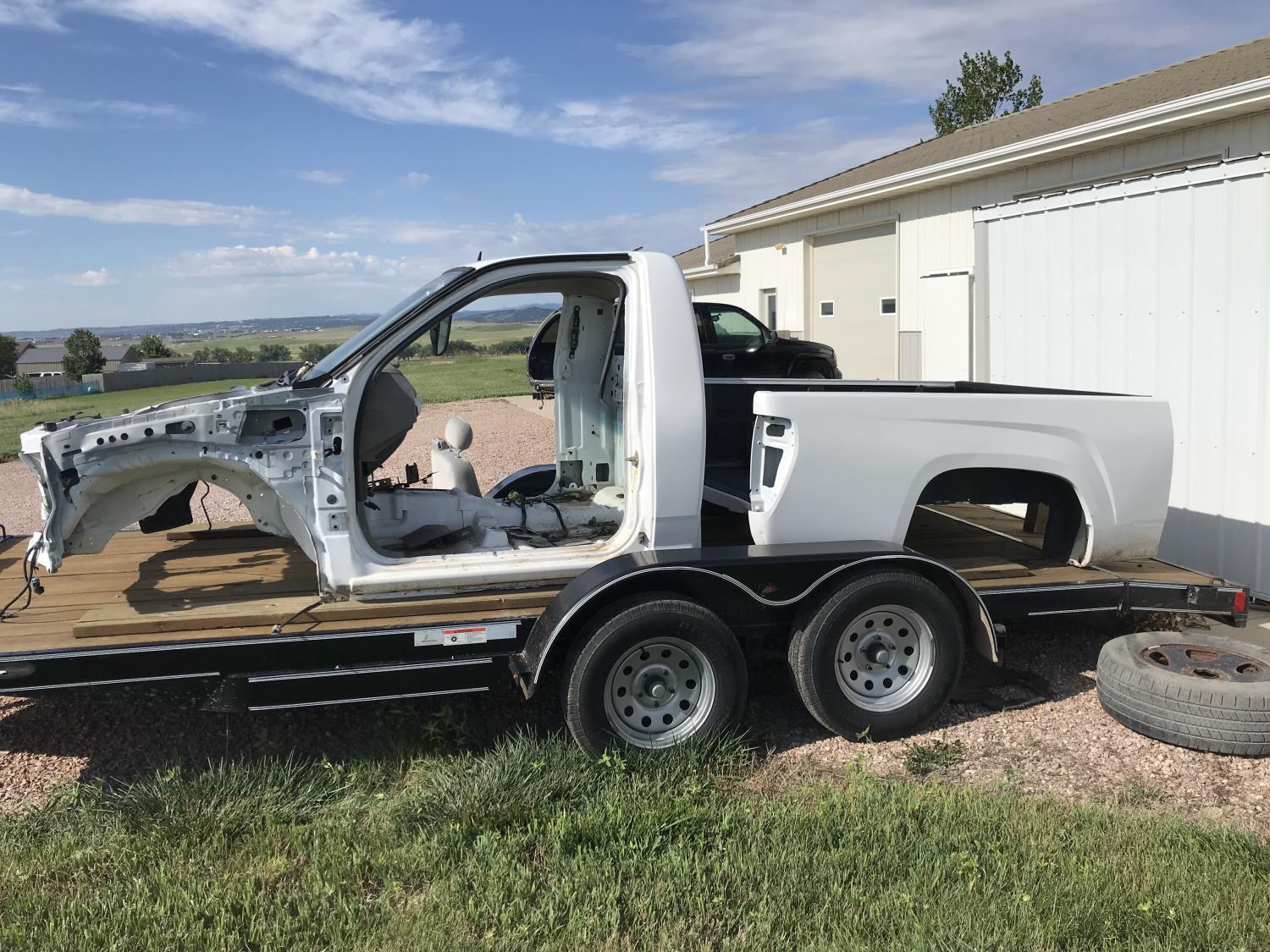

I used a Colorado box and for the back of the cab

it looks alot like the white pickup. are they the same wheelbase/suspension? I am trying to reconcile if the outcome as the same a a two door pickup ?

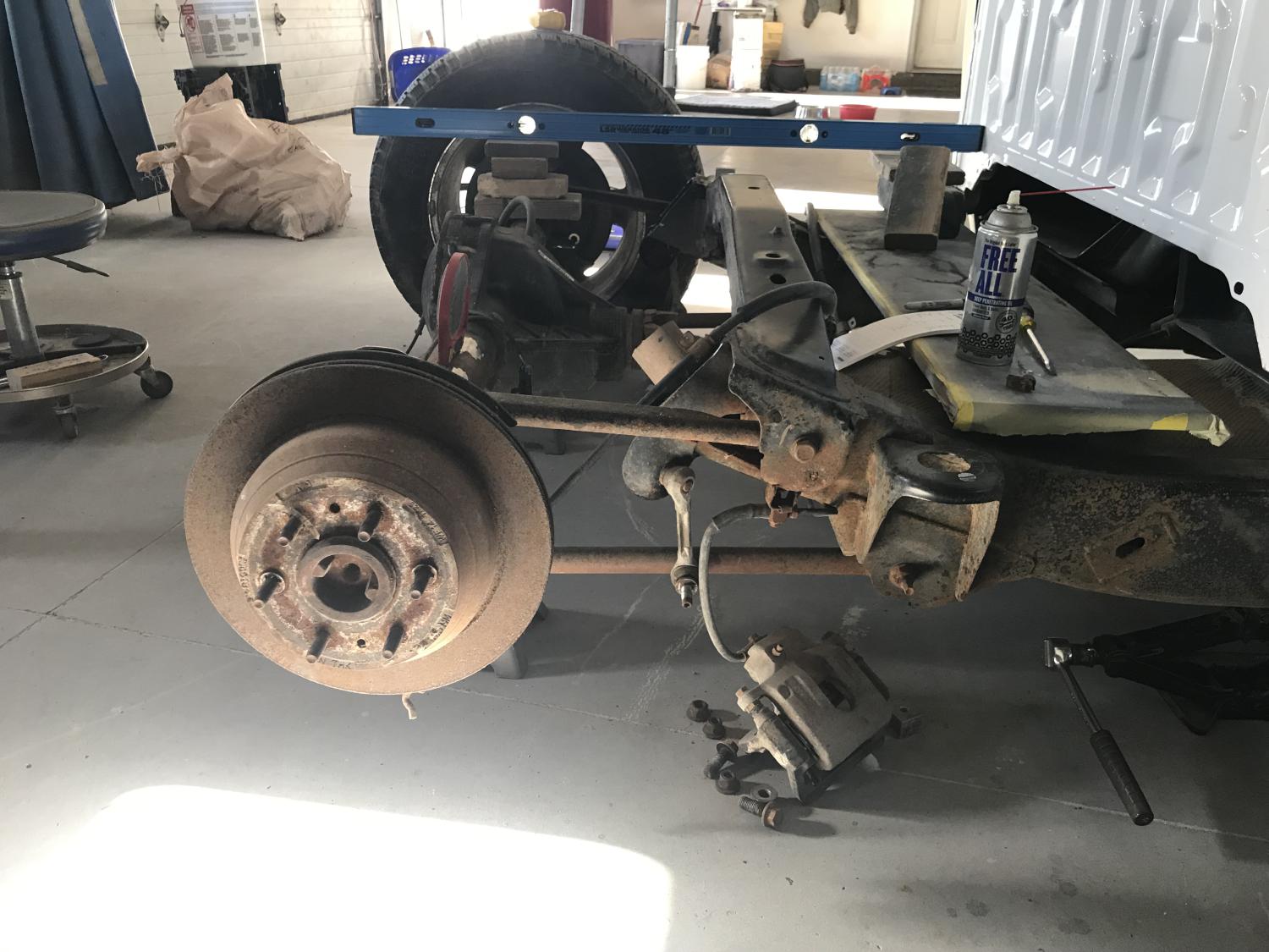

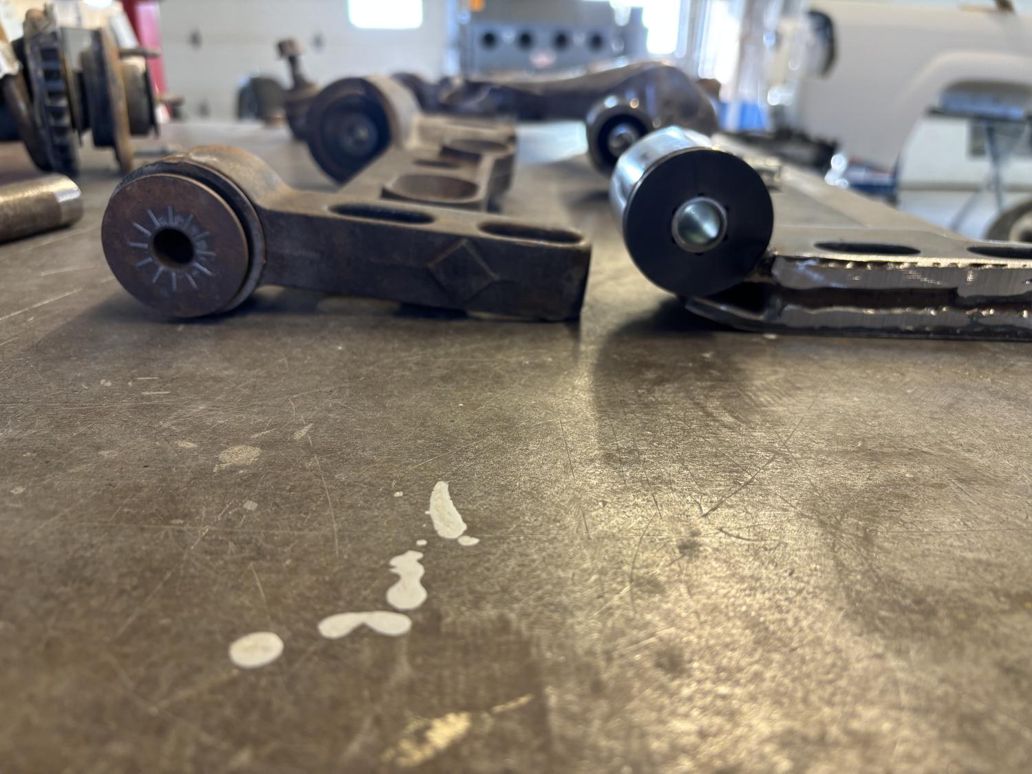

I never planned on posting this project and I’m embarrassed that I have no pics of building the rear frame. Lowering the trailblazer causes geometry issues with both the front and rear suspension so in the rear I made new mounting points on the axle to keep the radius rods more happy. In the front I raised all the inner pivot points to eliminate the excessive control arm angles from the lowering.
