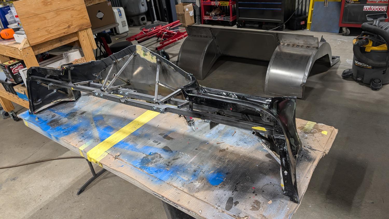

I use sign makers plastic for making the mold flanges. It's cheap, cuts nicely and shapes with very little heat, and easy to get.
Masking tape so the hot glue doesn't permanently stick to anything.
Use a lot of cripples so the plastic doesn't move or break off during laminating, last thing you need with wet 'glass!
I welded in a fairly stout inner structure while the valence was still on the car. Given the weak-@ss nature of how the shape of the spoiler was created, can't have anything flexing once it comes off the car.

Tacked up the spoiler mounting brackets.
Bumperette mold almost complete
Spoiler mold almost complete

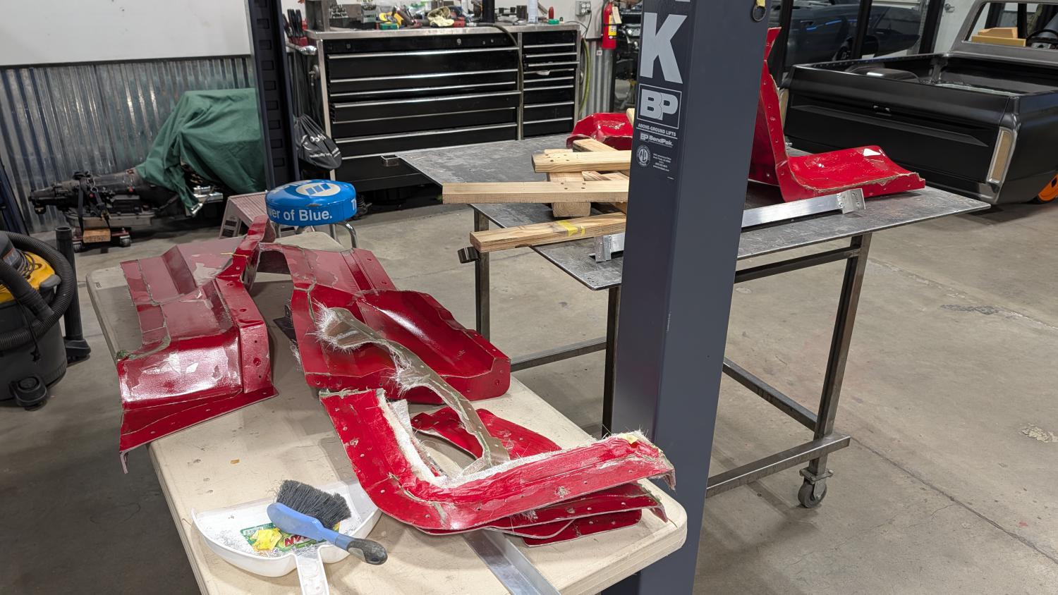

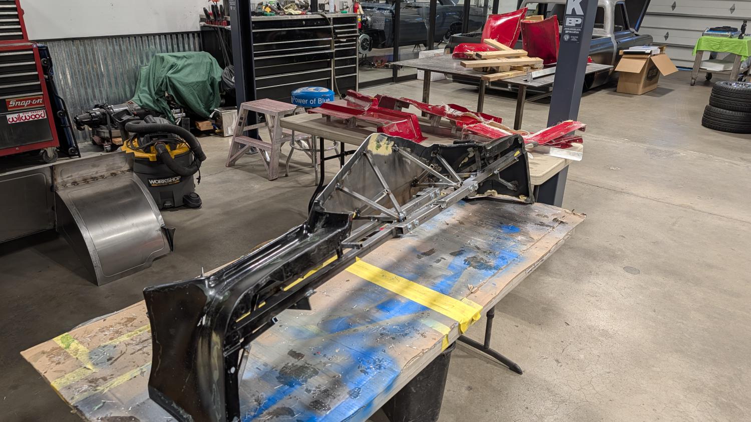

2 of the molds are complete now, here is the mold sections right after pulling them off the plug.
The mold parts and the plug.

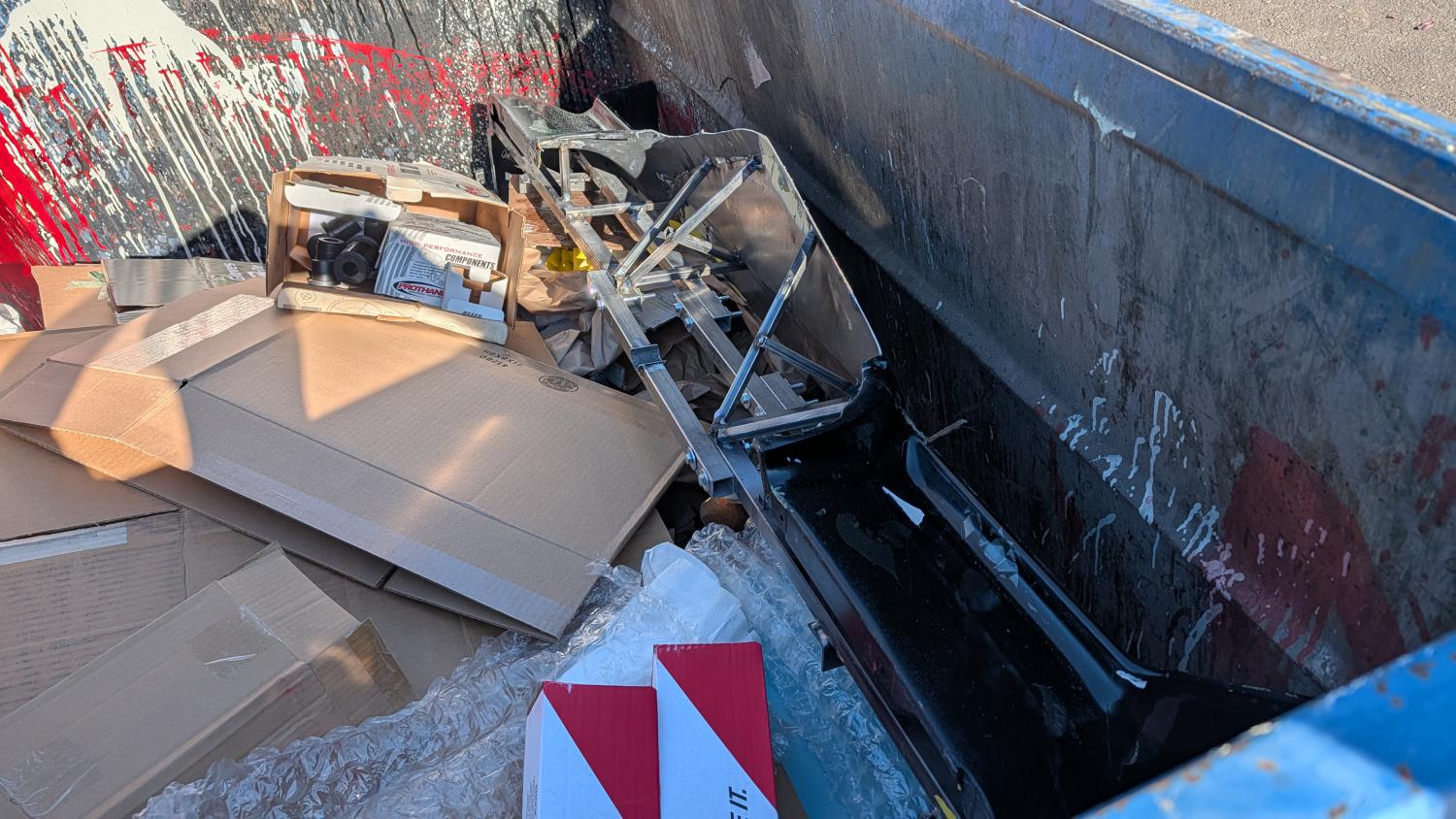

The plug getting ready to go in the trash. I cut off some of the nose piece mounting brackets. I will use them on the final part, it will make sense later.
I set the mold aside and forgot to take pics of it, will do next week.
Threw the plug in the trash. That's always weird! I made this mold pretty darn stout and braced the heck out of it so it doesn't warp once I make the part and put it up on a shelf. Hopefully I'll never need it but if so, at least it should be as straight as the day I made it.

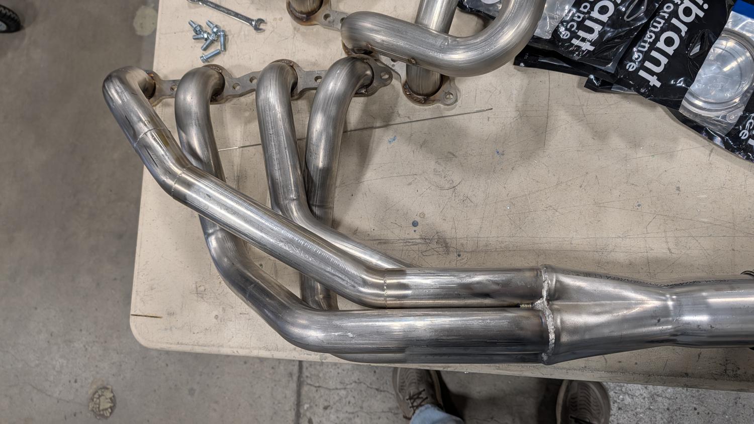

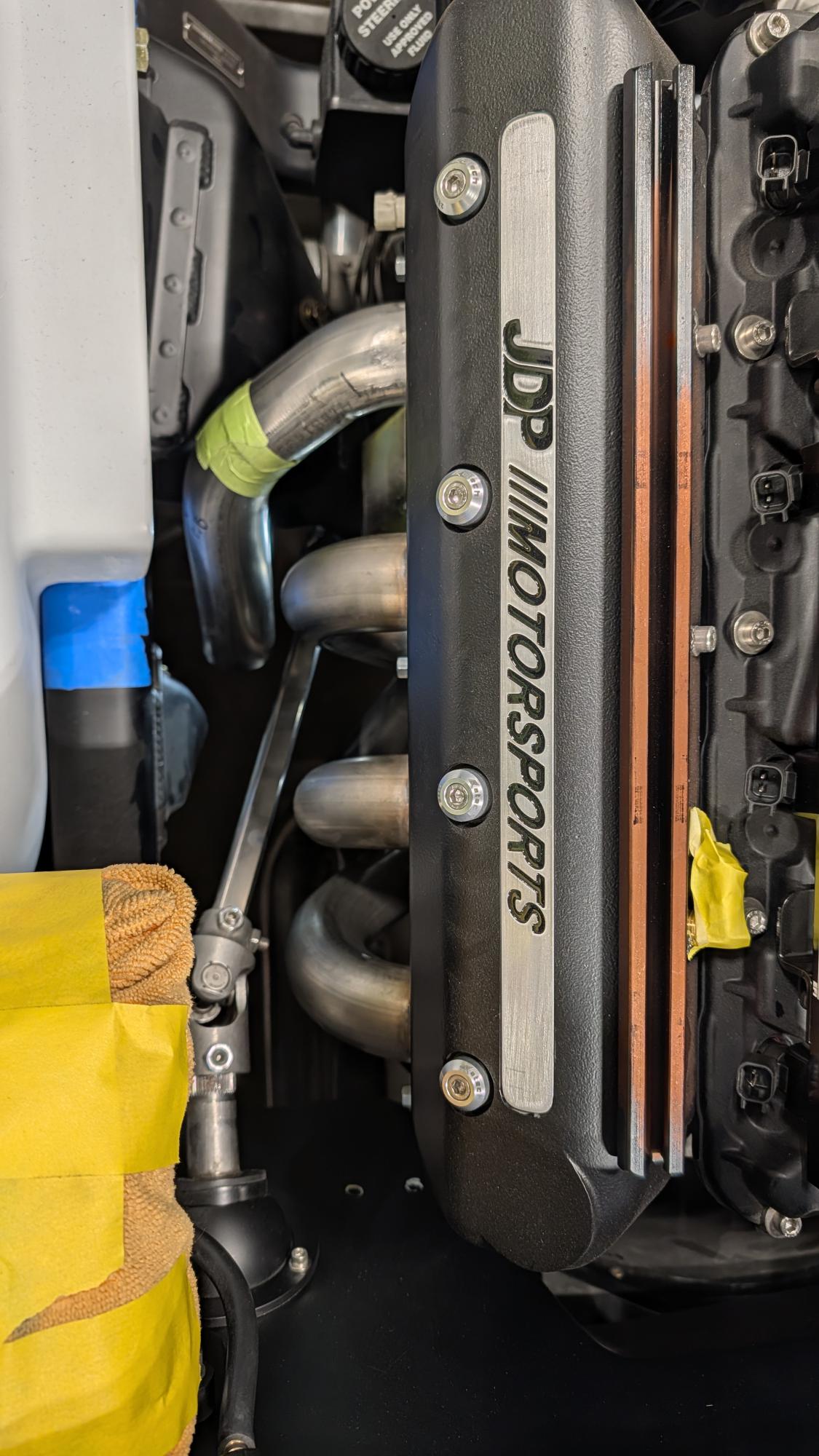

Switched it up as Kenny was kind enough to offer one of his awesome fab guys to help me put the #1 header tube on the headers. The way I mounted my steering column put the shaft right through the middle of the #1 tube. American Racing Headers was kind enough to make me a header without that tube and sent me a box of scrap bends along with the seal and collector. First class people.
We spent a day getting this thing right. Couldn't have done this without Adam's help. Next level talent.
Header done ready for some scotchbrite.

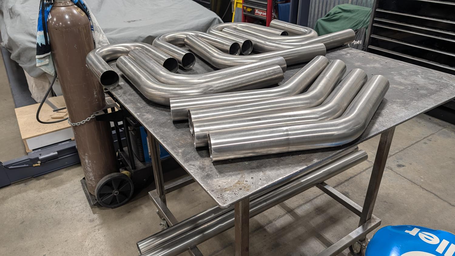

Kenny spent the weekend with me working on the exhaust. Another next level talented dude. 35 years of badassery....
Parts ready for cut'n.

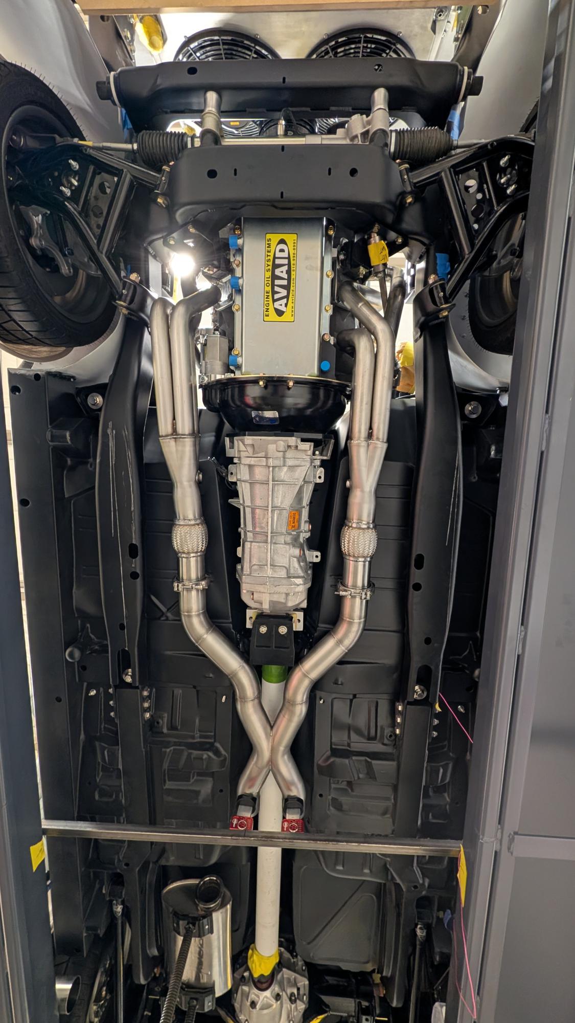

We got the it built to the X this weekend.

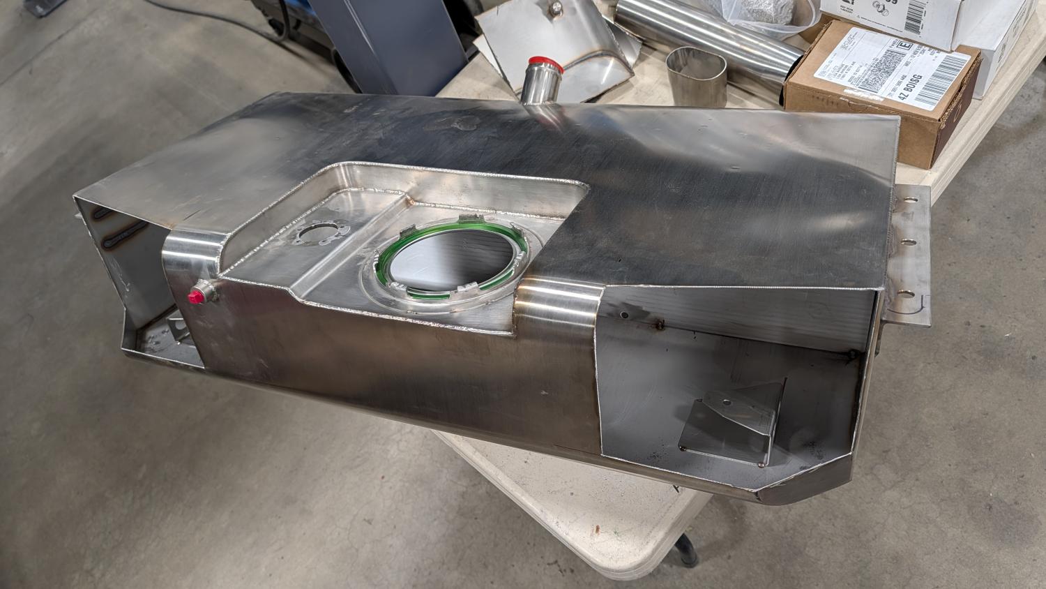

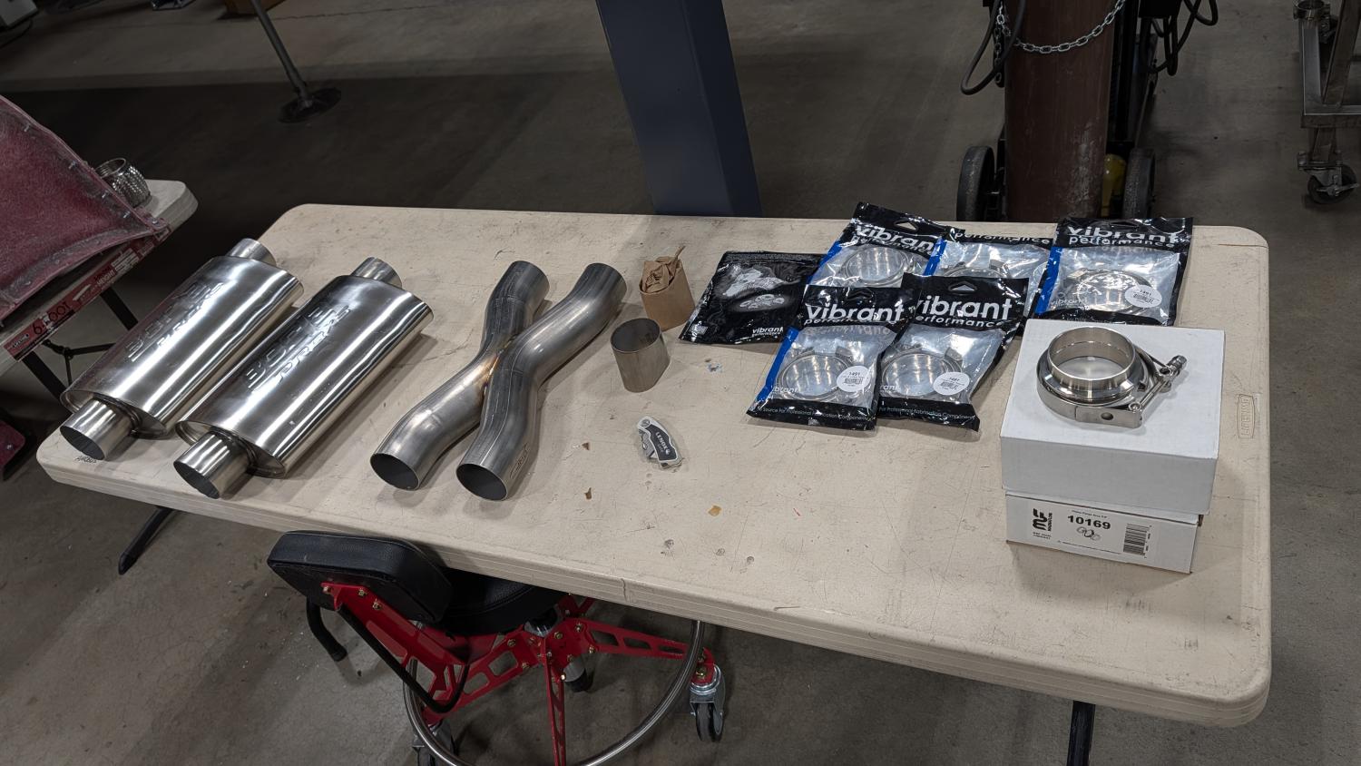

Started prepping for the mufflers and the rear, figured we would notch the fuel tank for cleanlyness. I decided to run 3" all the way back, I know many go 2 1/2" after the mufflers but I don't have experience with that, so just made way for the 3".

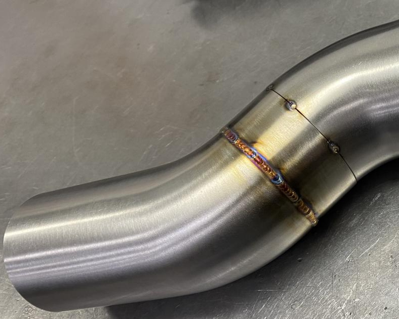

Really enjoy viewing your build, your skill set is phenomenal to watch the process evolve.
Wanted to ask a question about you mentioning using a scotchbrite on the headers. Is that to give it a brushed look?
I'm going to have some exhaust work done on some 304 stainless next year and like the brushed look as opposed to the mill finish. Any tips to offer this novice are appreciated to achieve a finish like the pic below, TIA.
Name:  Brushed stainless exhaust.png
