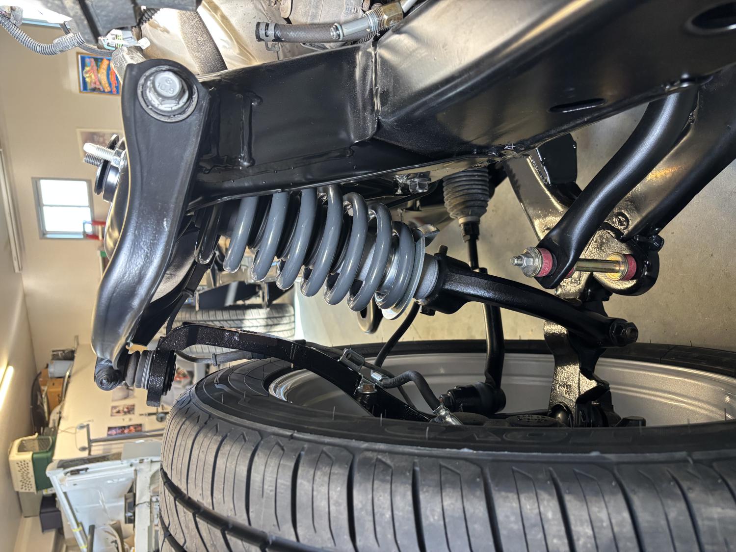

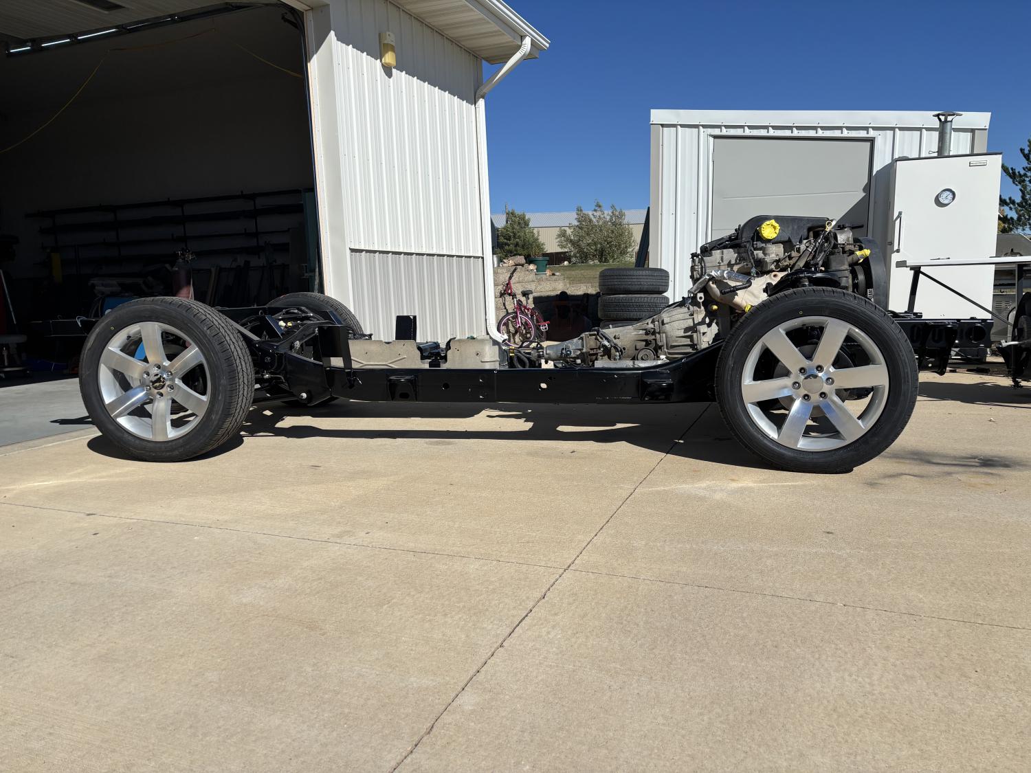

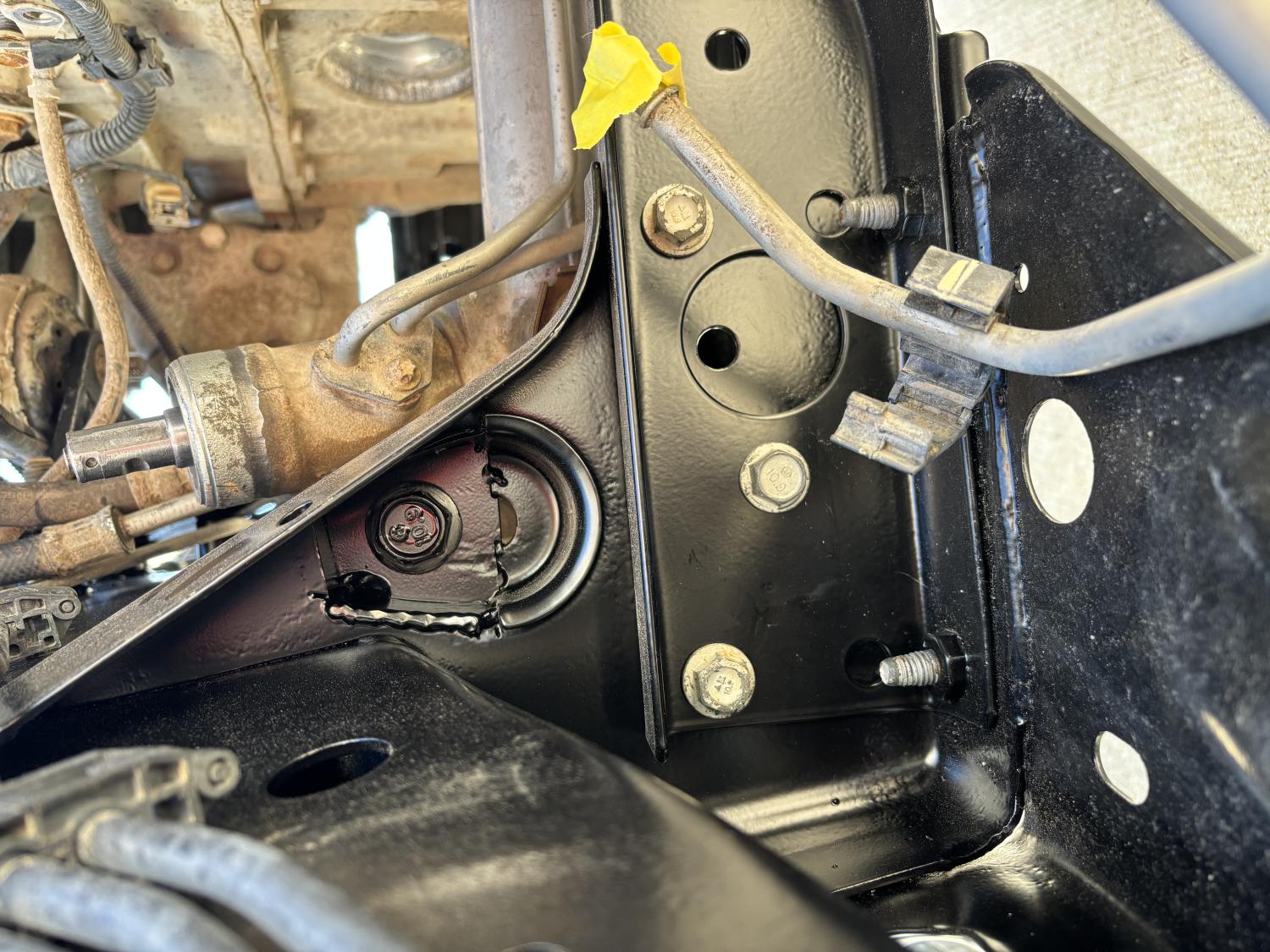

Got the frame powder coated. The first pic you can see where I raised the upper a-frame mount. The second you can see how I about ran out of space, notice the lower a-frame just clears the swaybar. The last shows the mounting point of the rack, you can make out half of the original mounting hole. Sorry, the last pic is rotated.

I rotated the pic, let me know if it's upside down (I can't tell lol).

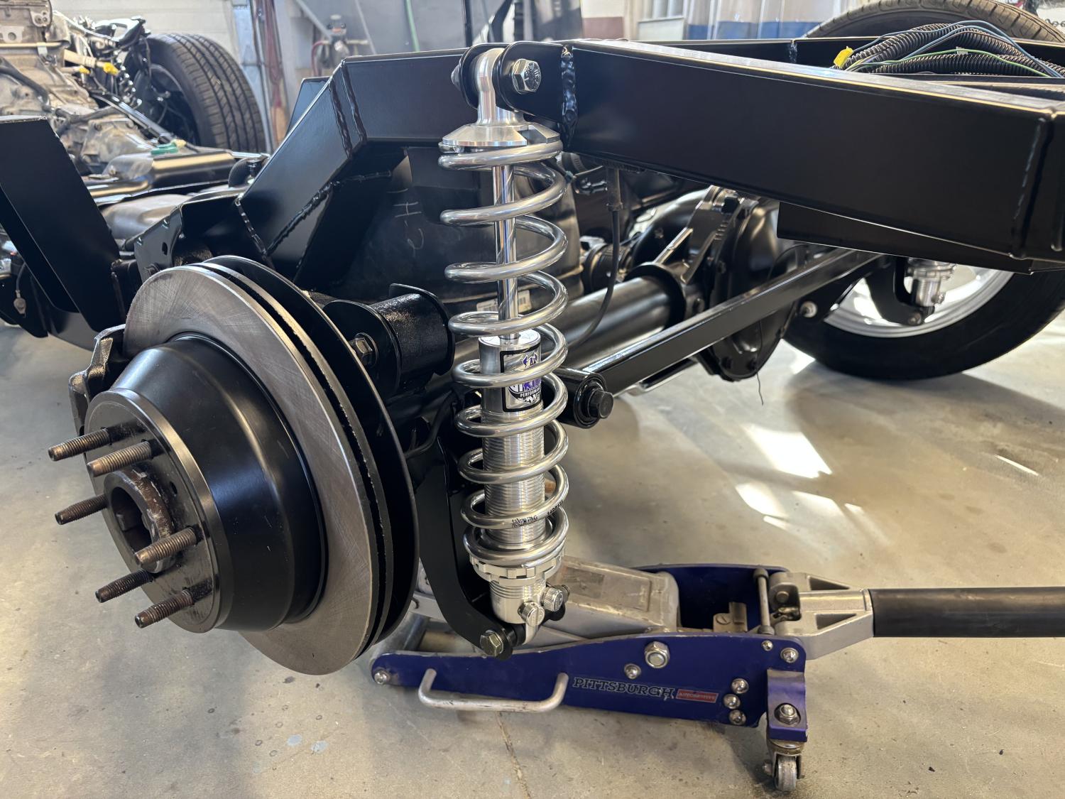

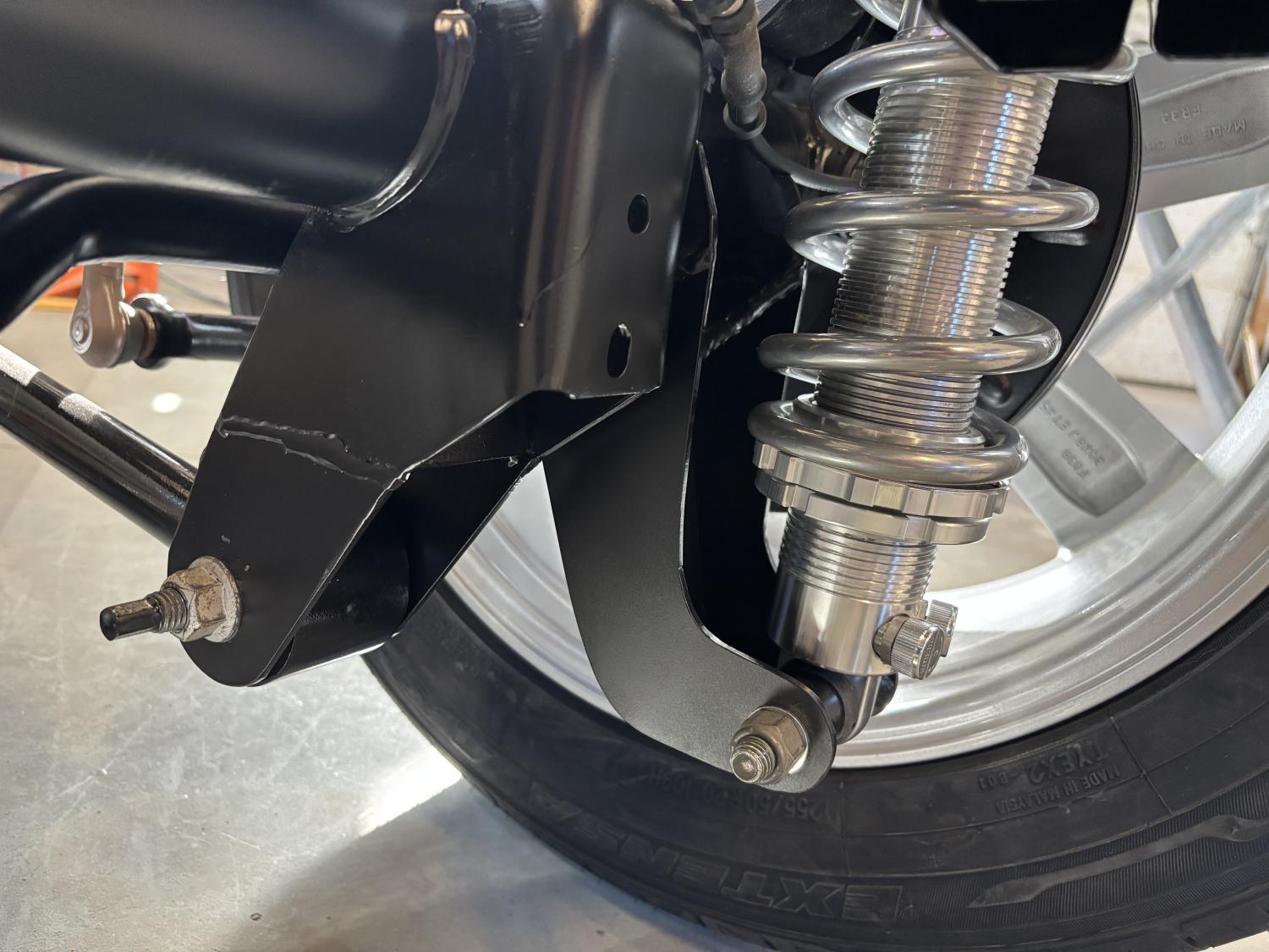

In the front I’m using Belltech shocks and springs, one of the few companies that offer for the trailblazer. In the back I contacted Viking and they specked a shock/spring package that fit my measurements. I’m using reproduction SS wheels, they’re 20x8.
