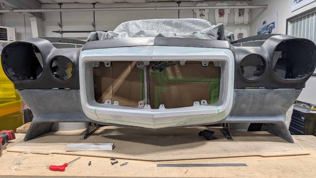

Thanks guys!!!
Took a couple weeks off visiting family for the holidays, left the spoiler in the mold to fully cure and help keep it's shape.
Here is the part out of the mold and just starting to smooth all of the seams where the gelcoat seeps into the joints of the mold.

The fiberglass nose, purchased about 6 years ago, shrunk up a bit, so I'll cut it and reshape to get the shape back. Glass does move if you don't anchor it and this piece has been off the car for some time now. My bad, definitely not the manufactures fault. Fix started today.

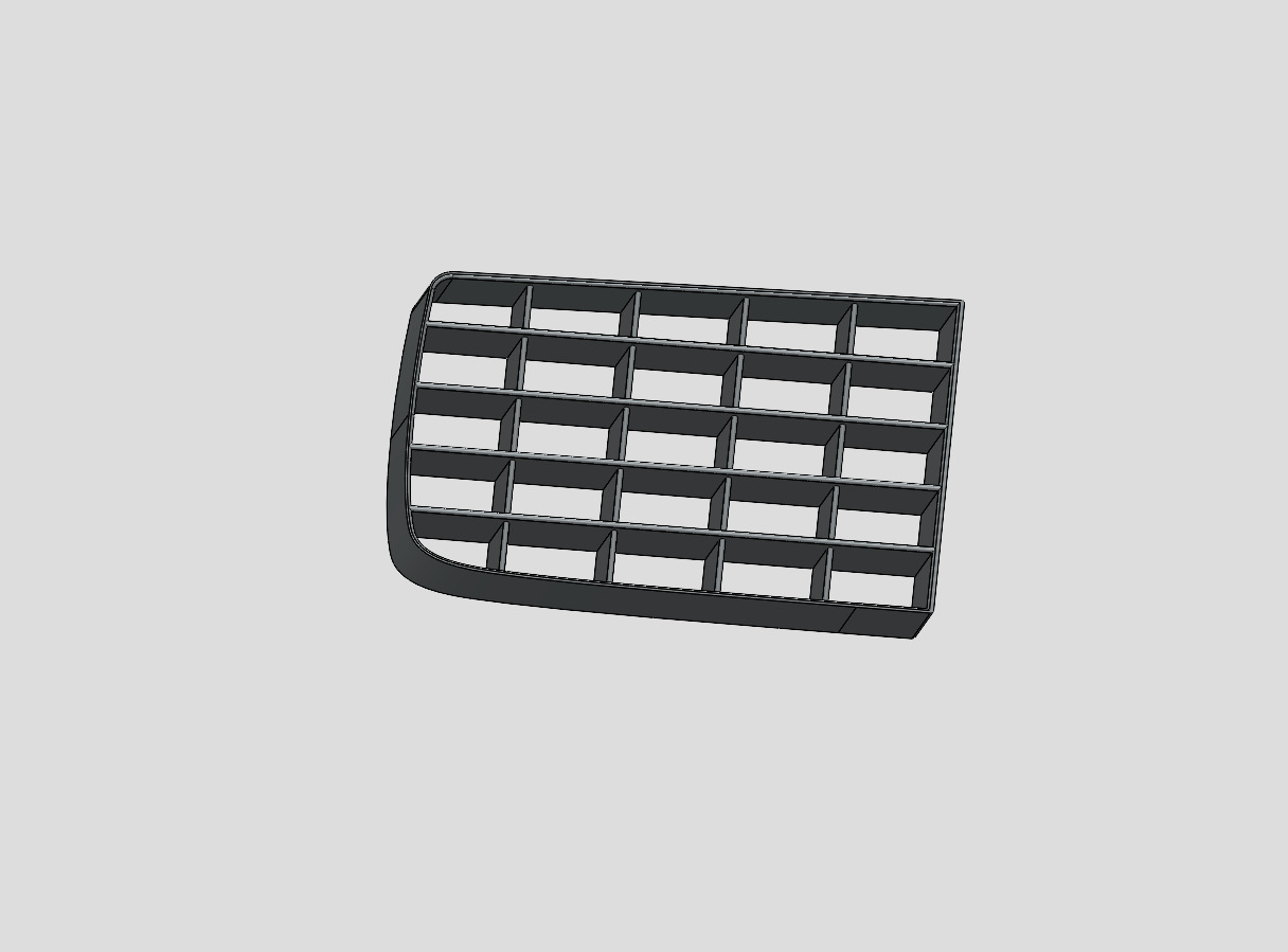

Here's the first attempt at doing a plastic insert. Stretched my Solidworks skills big time. Had some help, thankfully. Just hit send for the first test print.

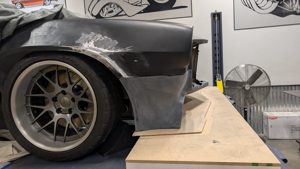

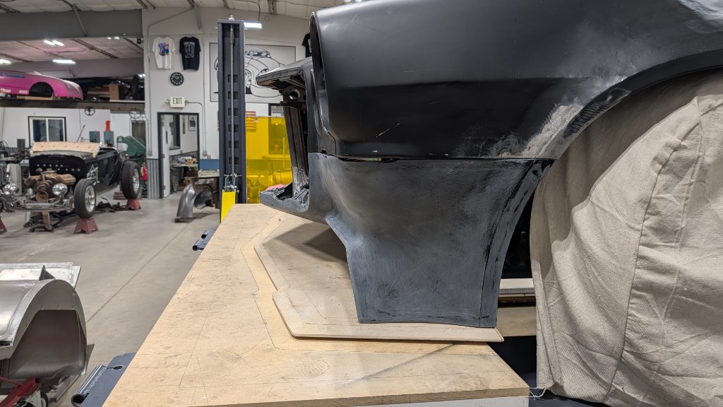

Good progress on the grill. My printer isn't large enough to print in one piece but still in mock-up, will find someone to print each side in one piece...hopefully.

First one out of the mold, glass cut for the second.

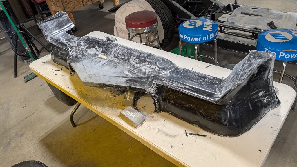

In the mold, little chilly right now in ID so helping the cure with some heat.

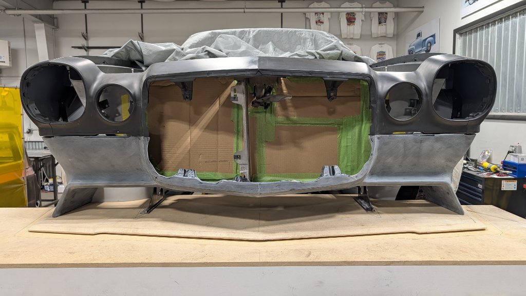

Initial trim and a quicky sand. lots more to do.
