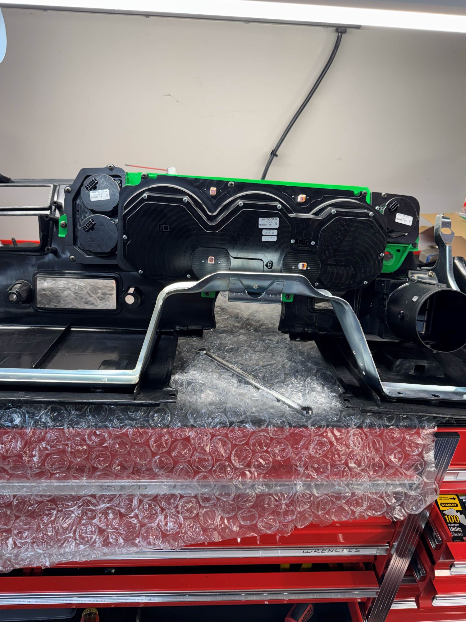

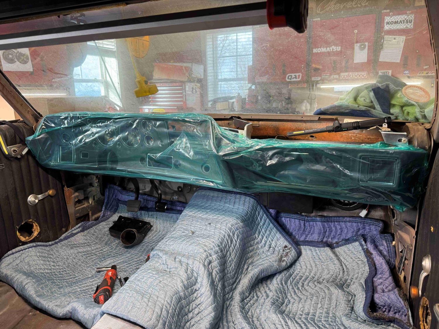

So after a couple of days with the bumper kicking my butt, I moved into the interior. Getting ready to install the Vintage Air system, the new dash and Dakota Digital gauges, and determine where to mount the ECM, DD module and PSI harness components.

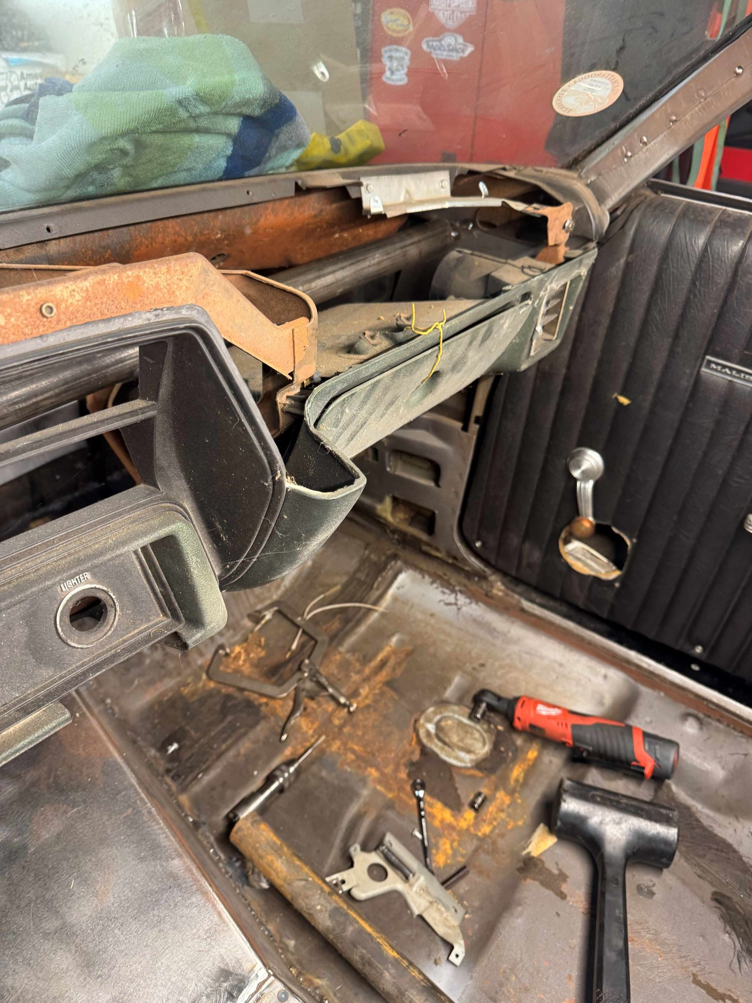

I had seen pictures on Ironworks page of the Chevelles he is building, which are so impressive. Tried to copy the bar that he runs behind the dash to mount some of these components.
I temporarily installed an old Malibu dash that I had, to check fitment.
Bill

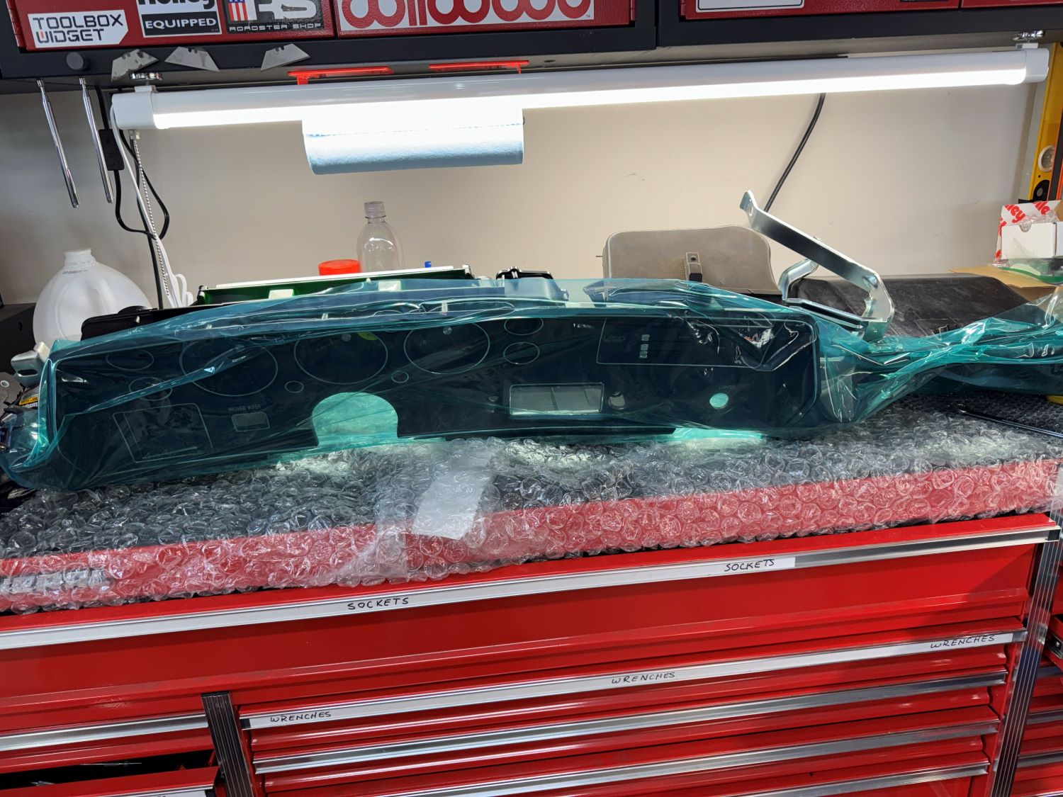

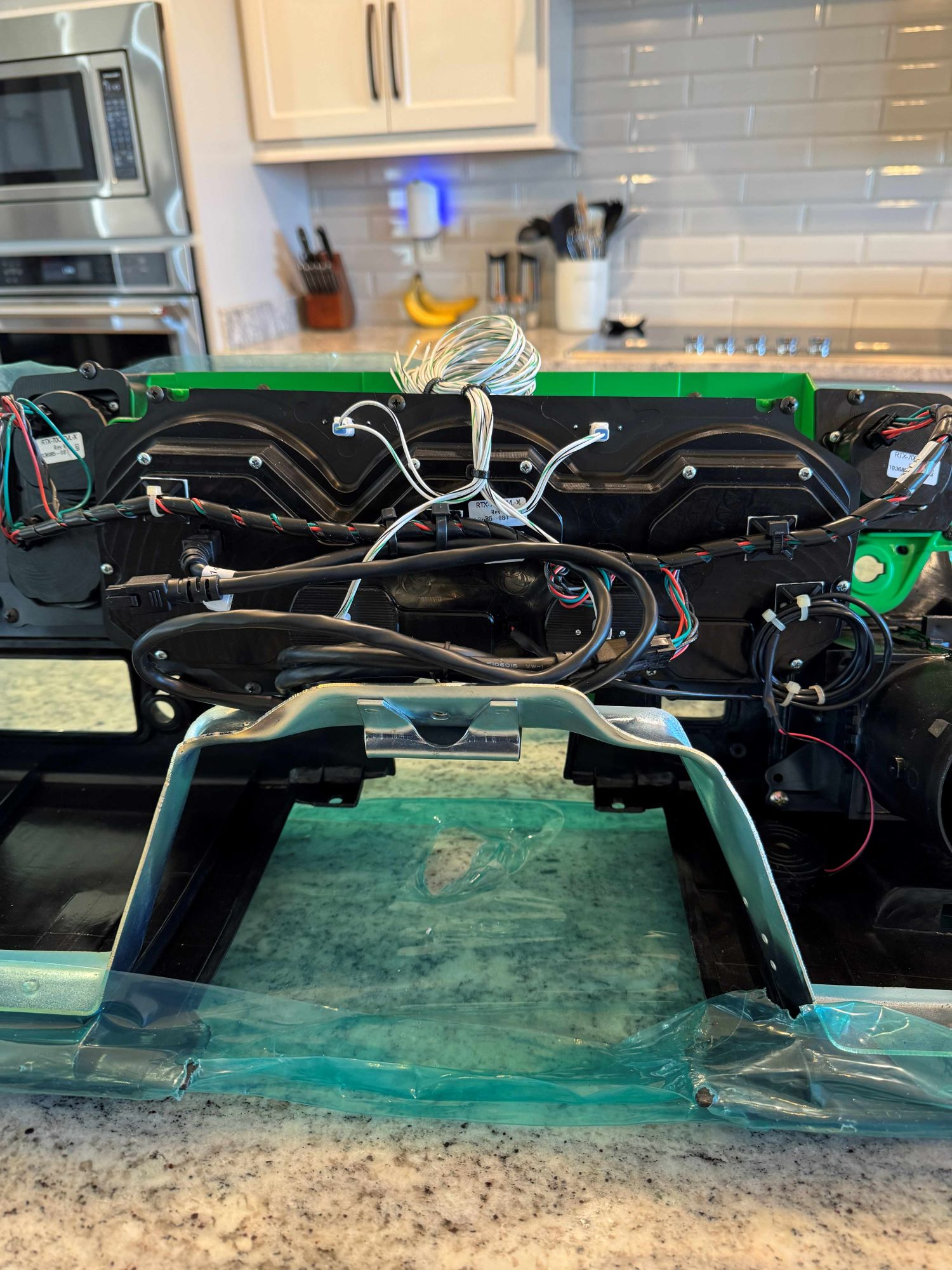

Moving on, I then installed the new SS dash, with the gauges so that I could determine component mounting.

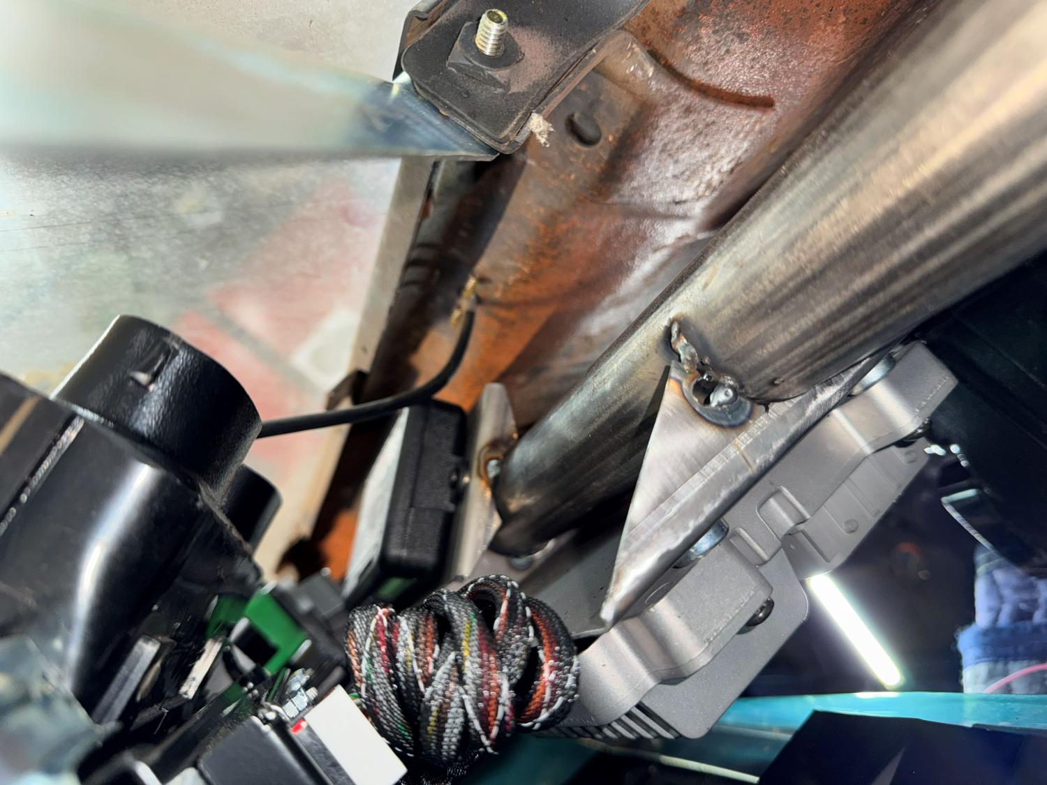

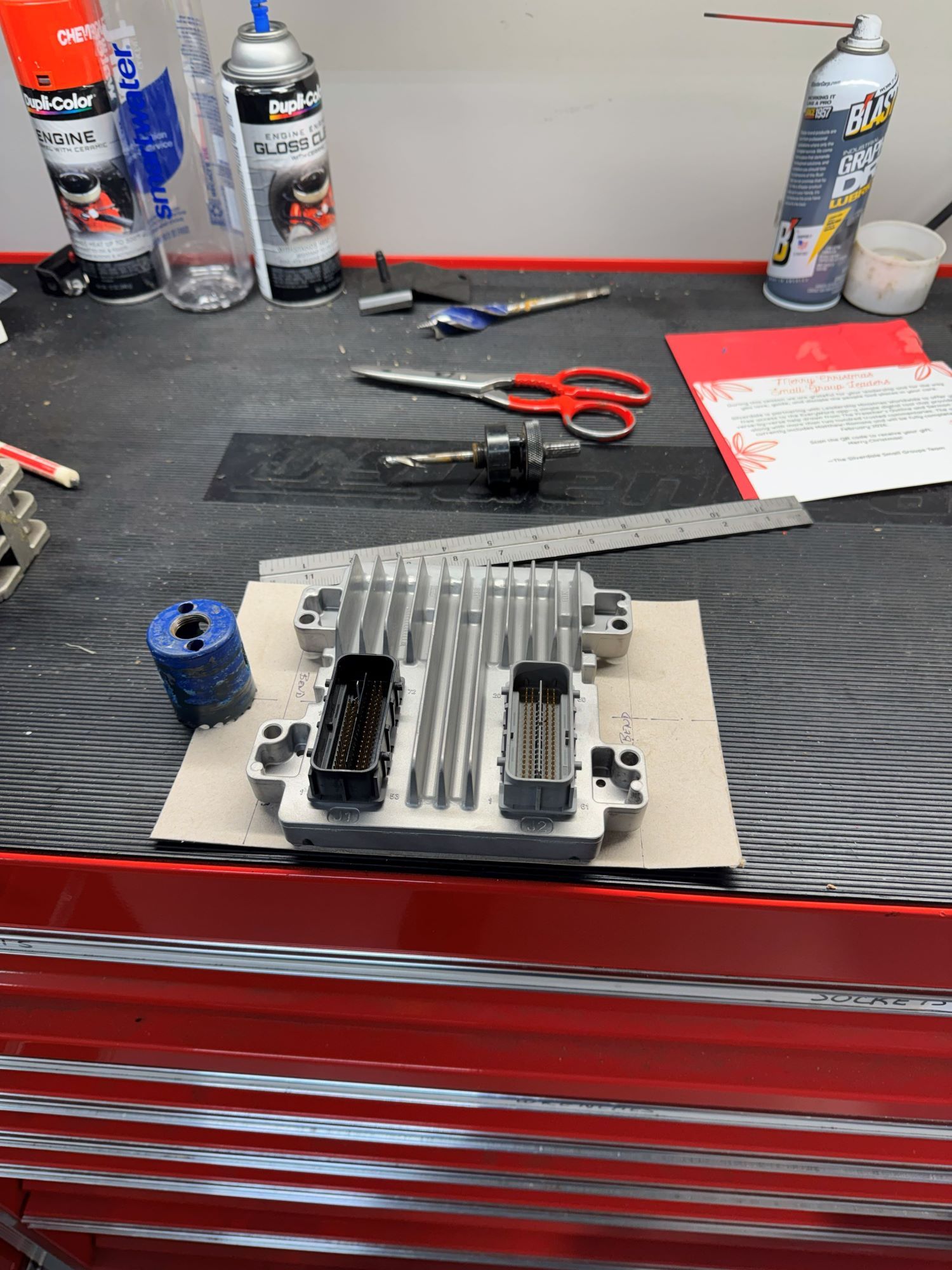

Made the ECM mount, then found the mounting spot on the dash bar, tacked it in so that I could check fitment and find the spot for the DD Module. Then removed the dash and set up the DD wiring.

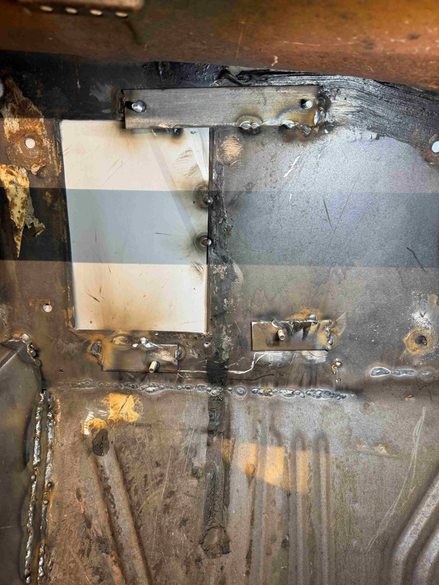

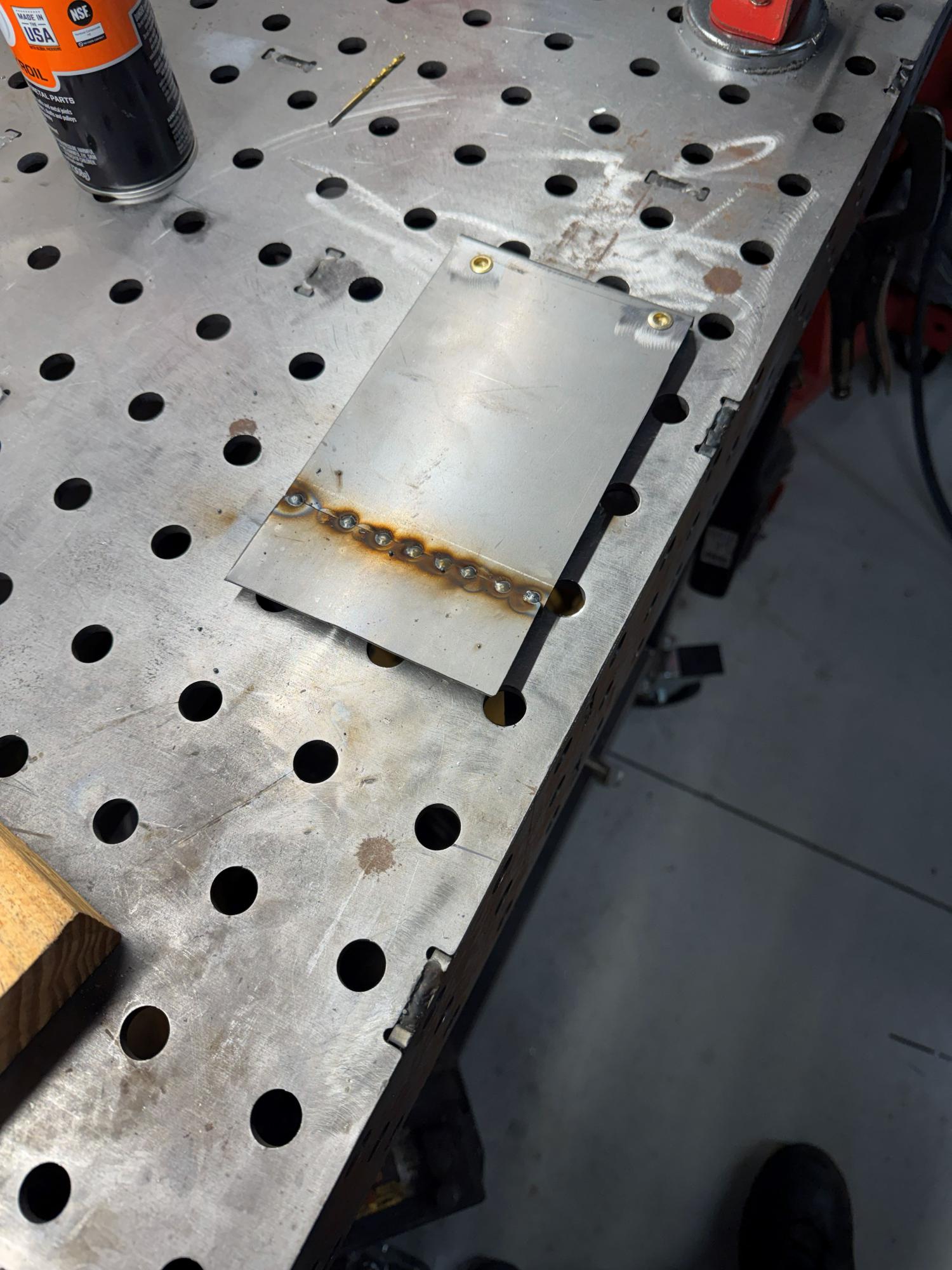

Thanked 176 Times in 72 Posts

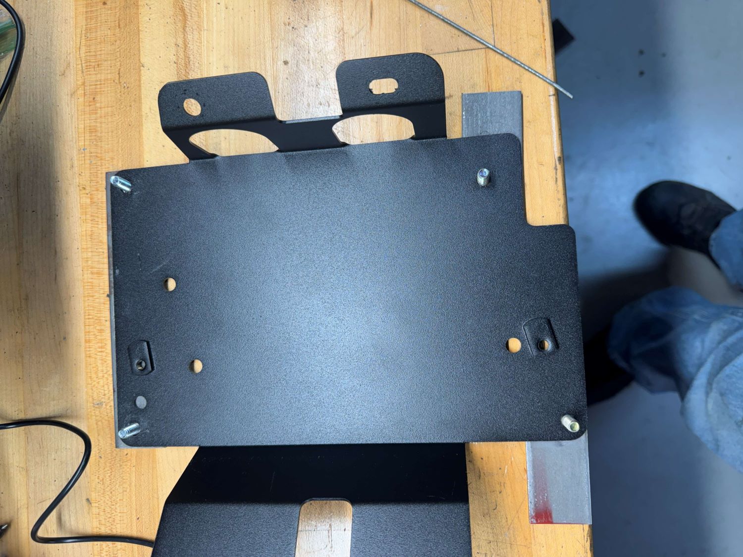

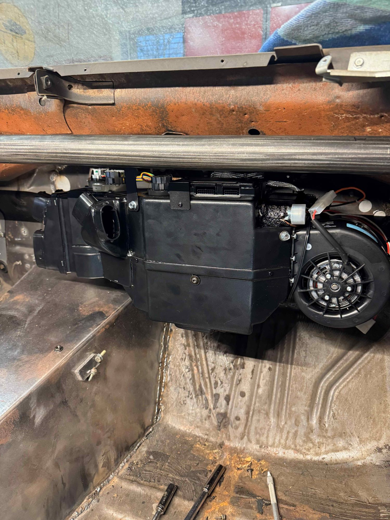

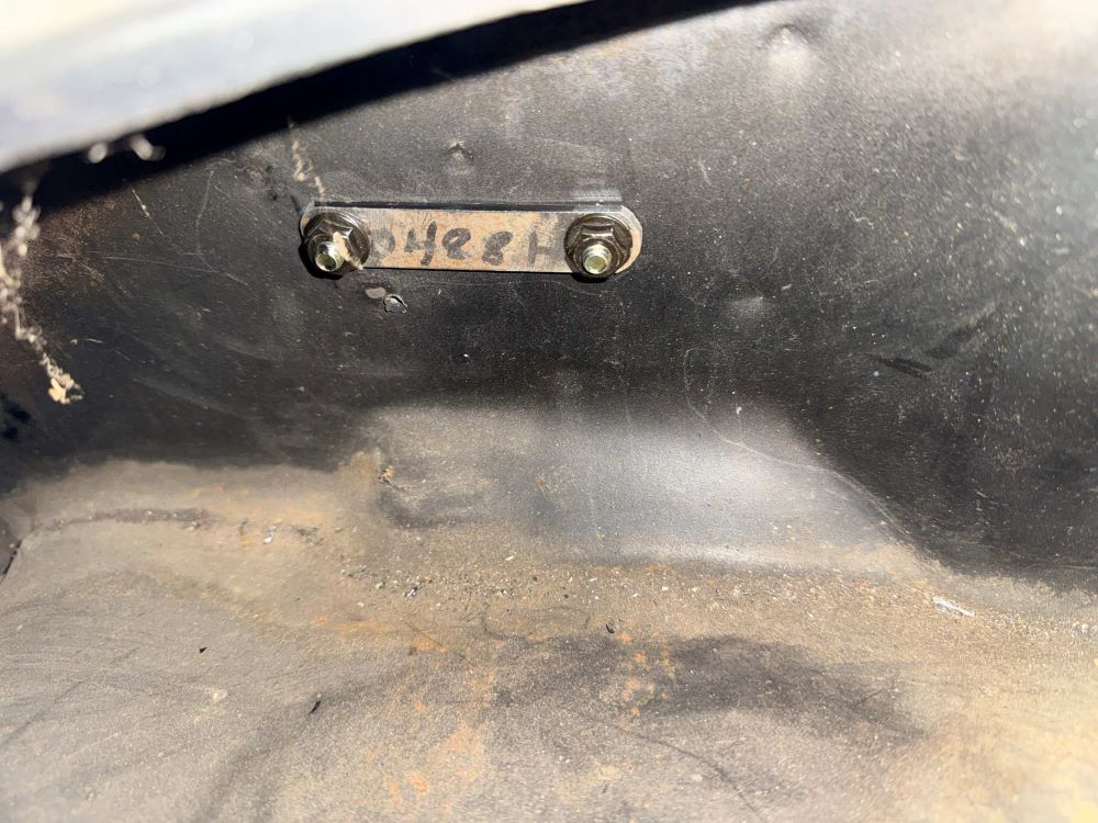

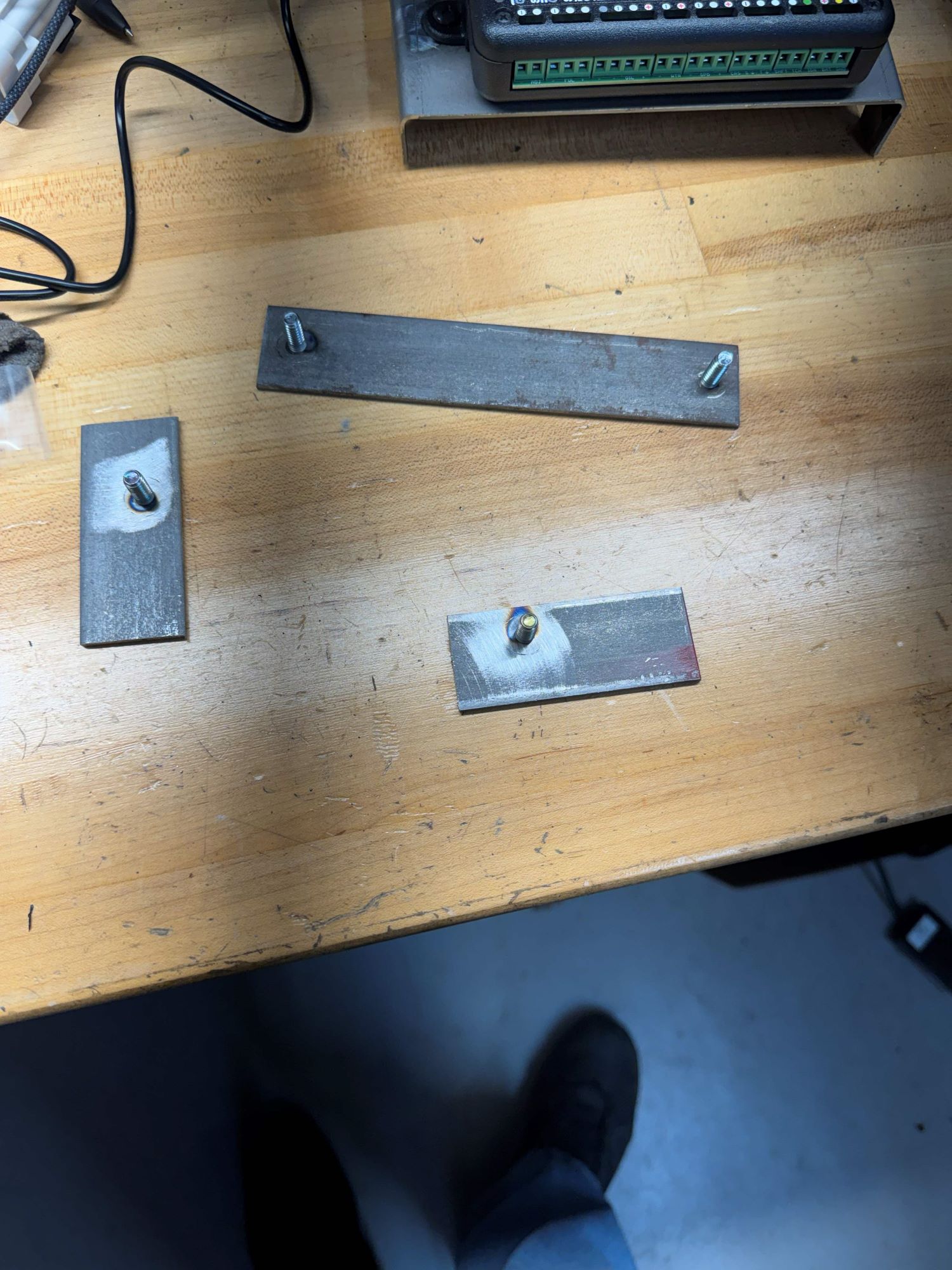

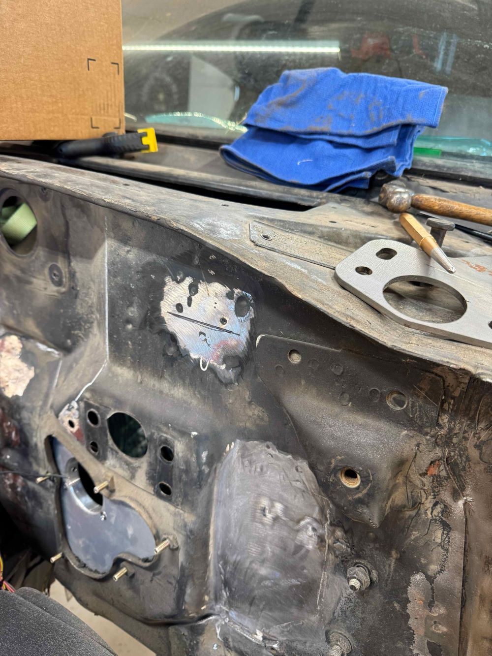

Next was to set up the mounting of the Vintage Air Evap box. I did not want to run bolts through the firewall, as it has already been smoothed. Made some plates with studs welded in so that I could weld those to the inside firewall and mount the unit.

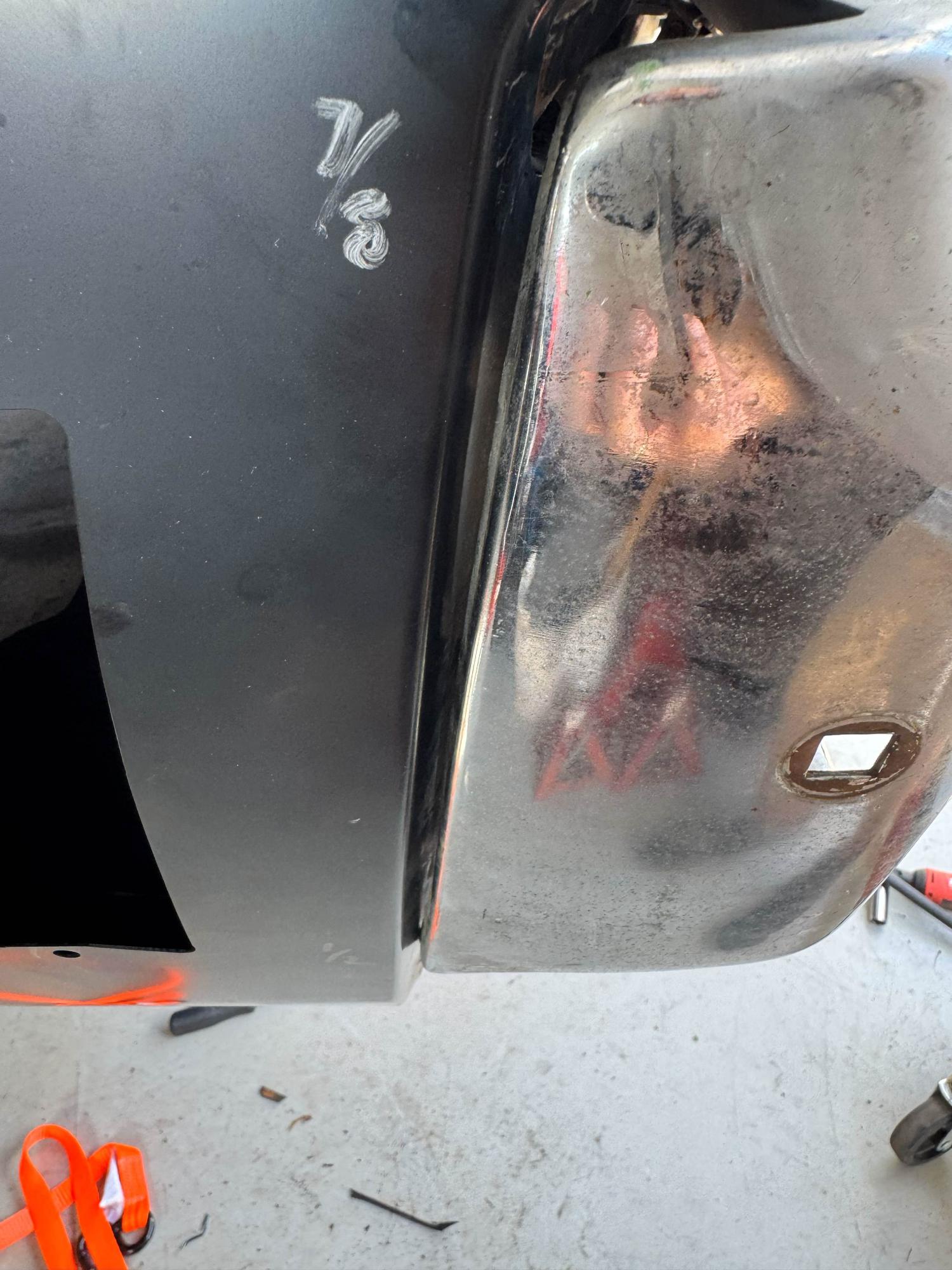

So I left off with the rear bumper. I started working to try to make it fit better, not necessarily to custom flush and mold the bumper to the body, but to just bring them in t the end, and make them line up with the body a little better.

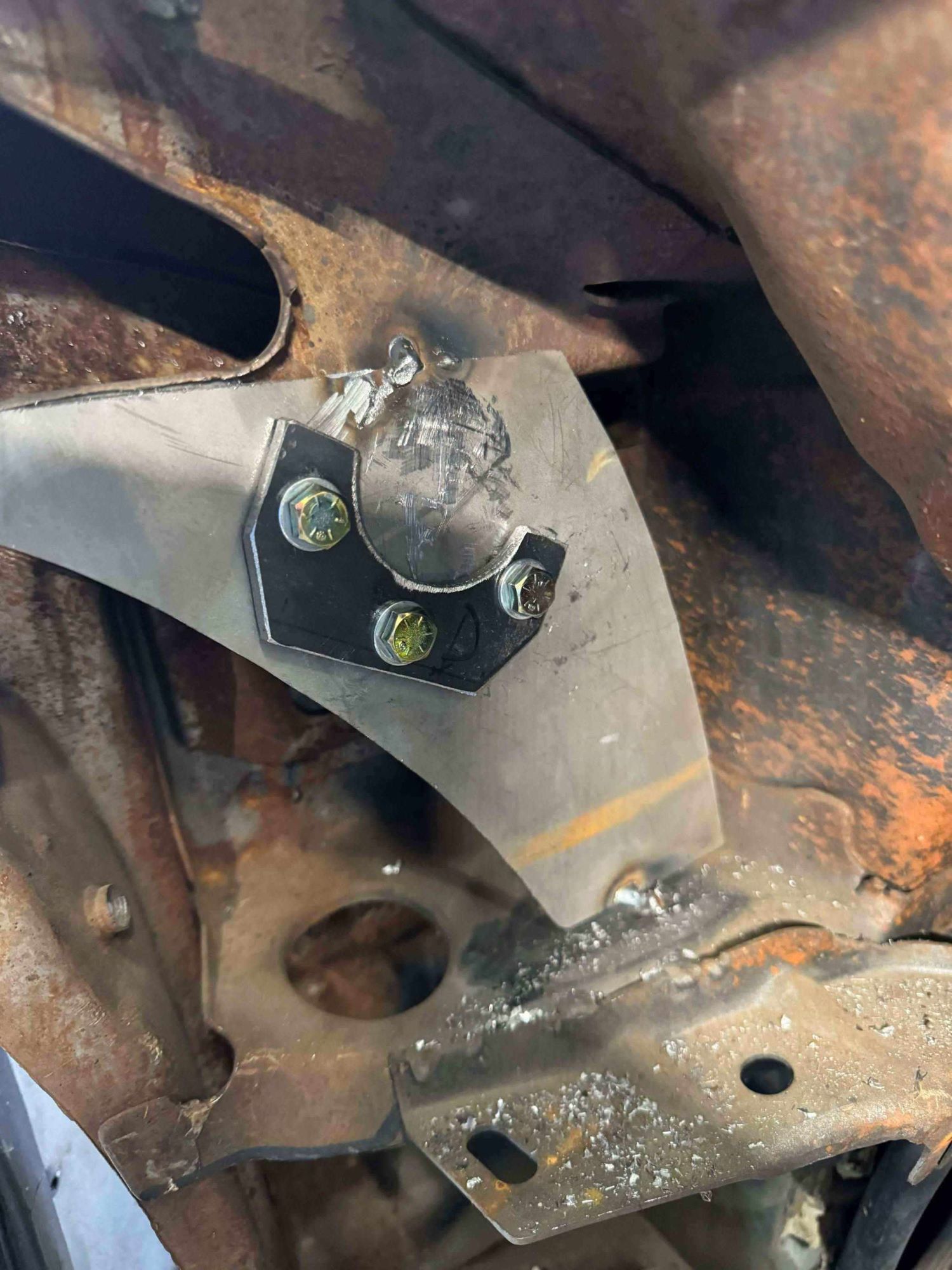

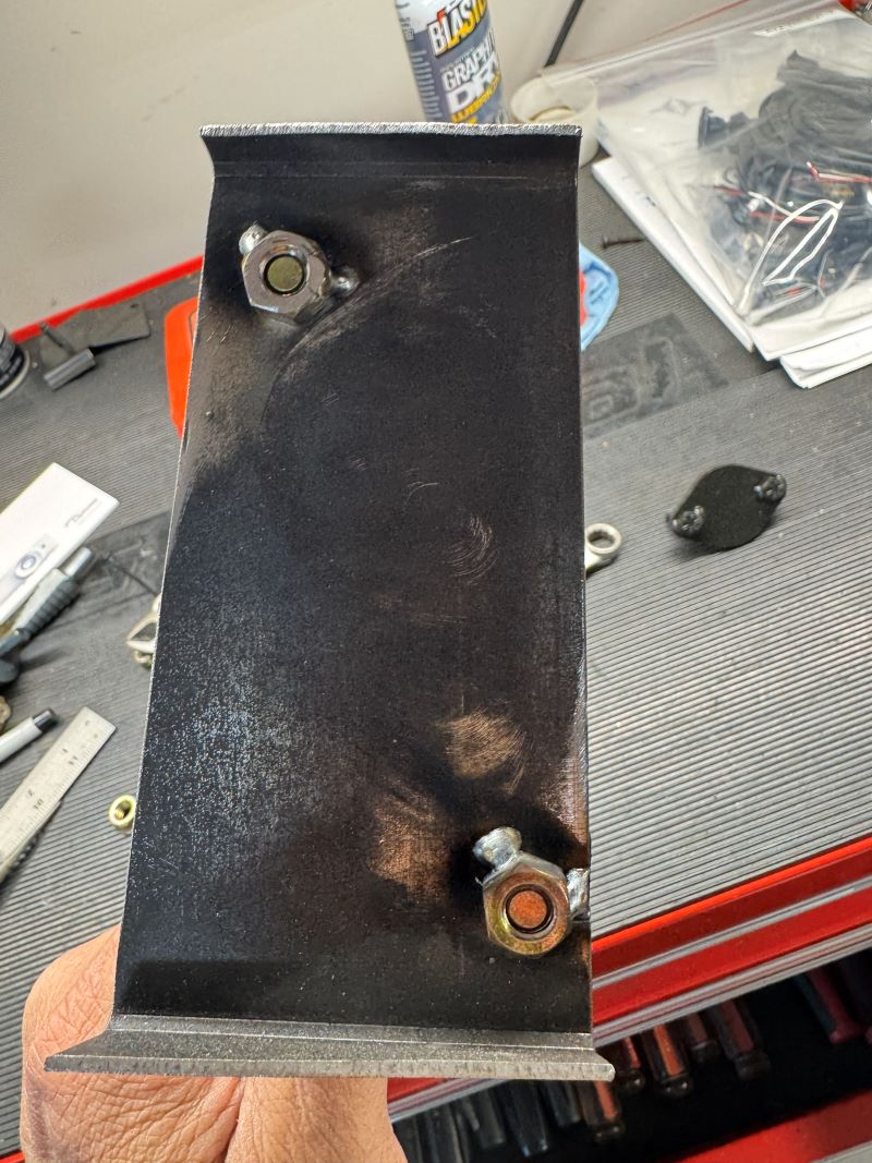

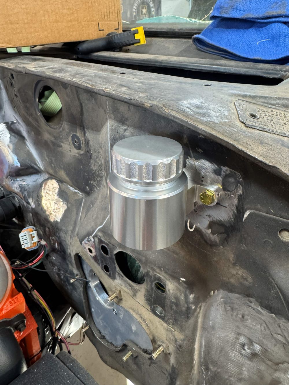

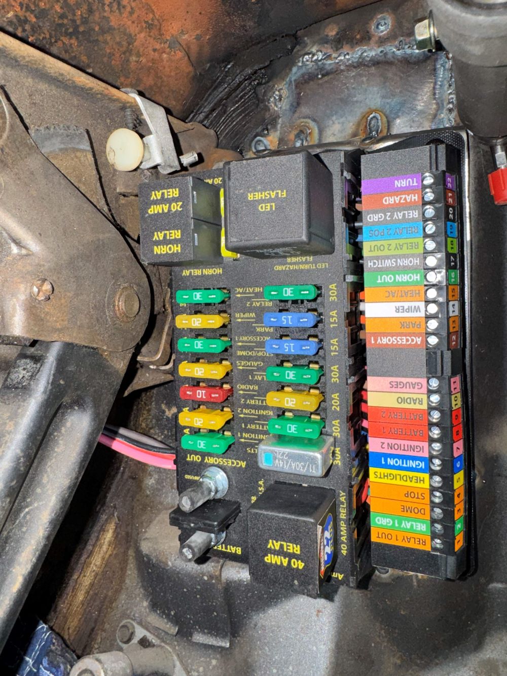

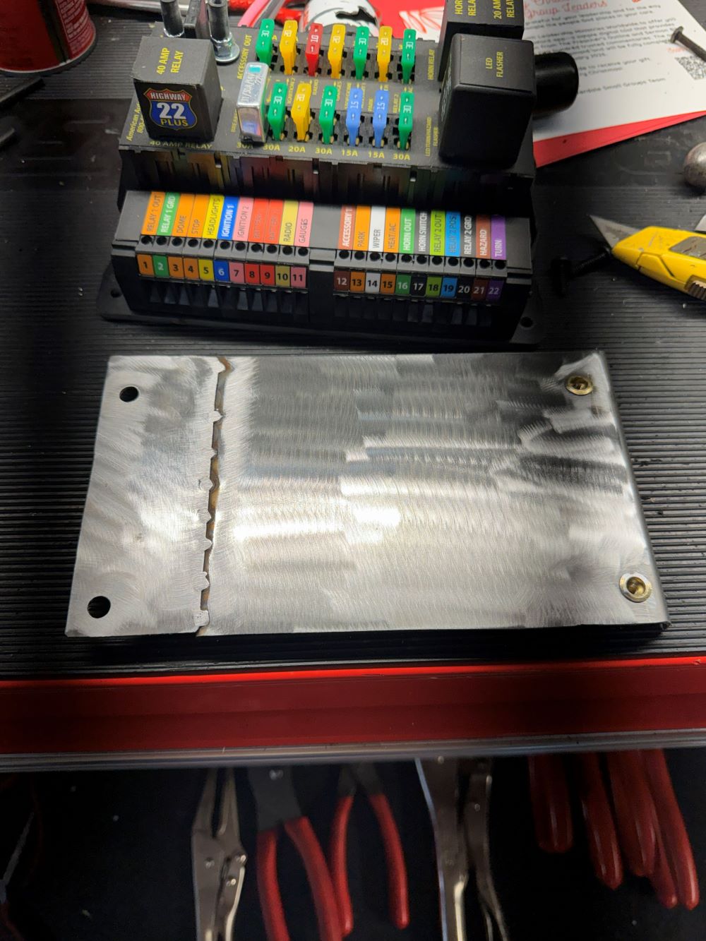

So keeping in line with what has been completed. Made a bracket for the American Autowire Hwy 22 fuse block. Got it mounted in the car close to where the original fuse block went through the firewall.
Then moved on to the clutch resorvoir to finalize the mounting and the routing from under the dash of the Malwood clutch system.
Bill

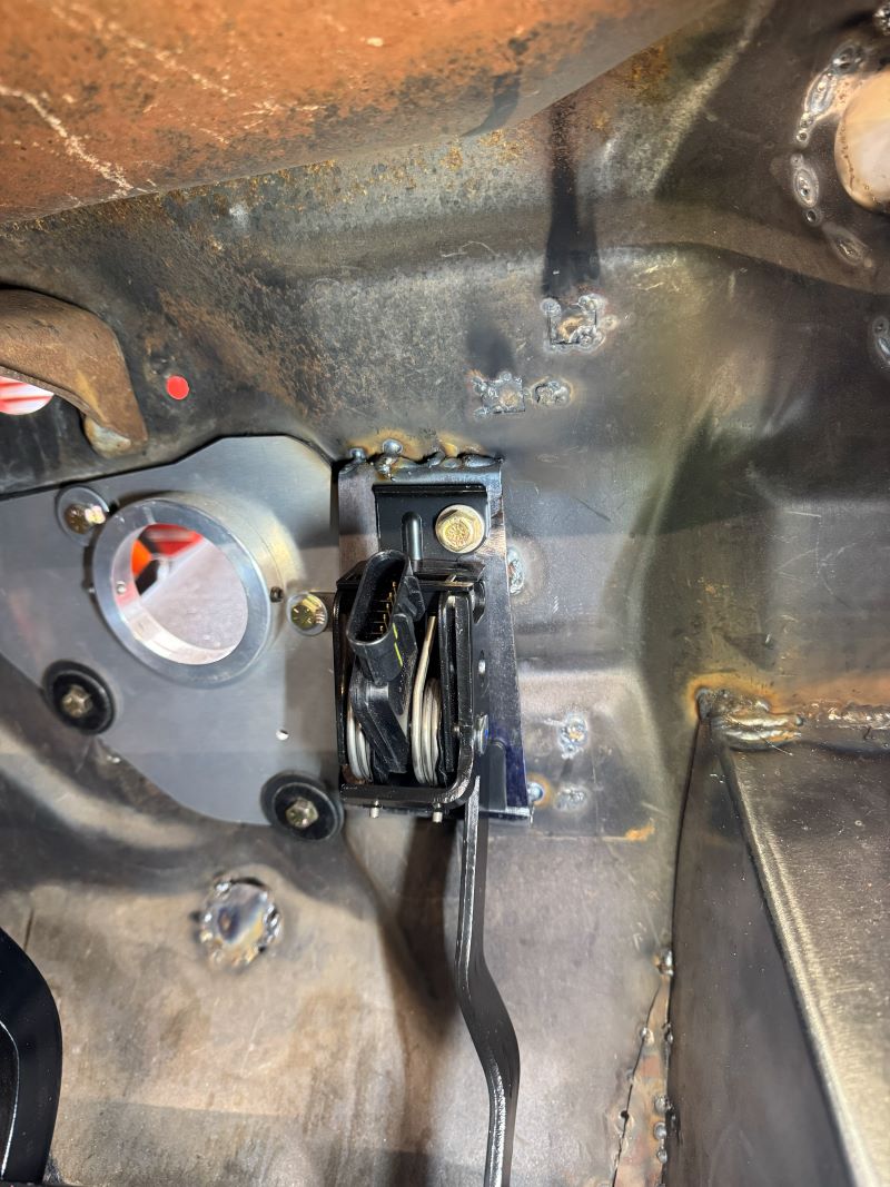

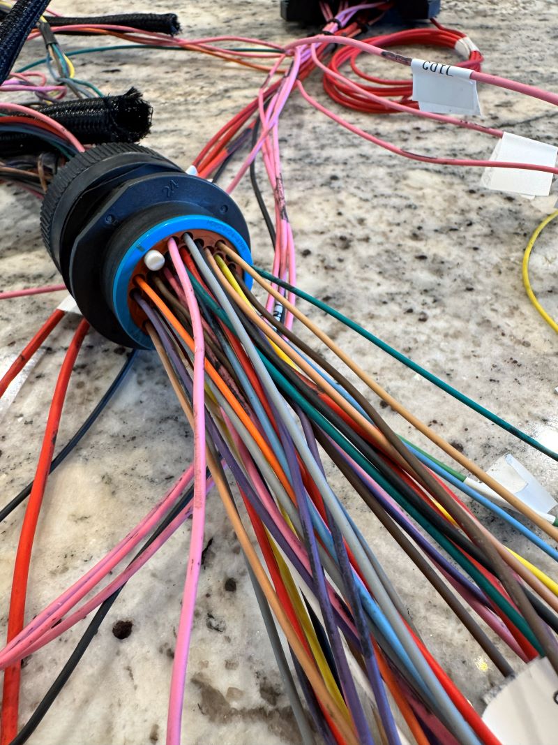

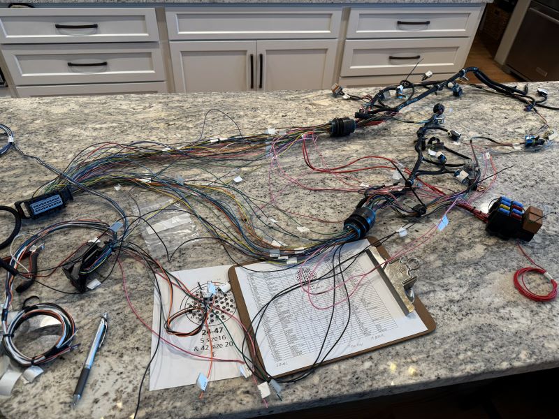

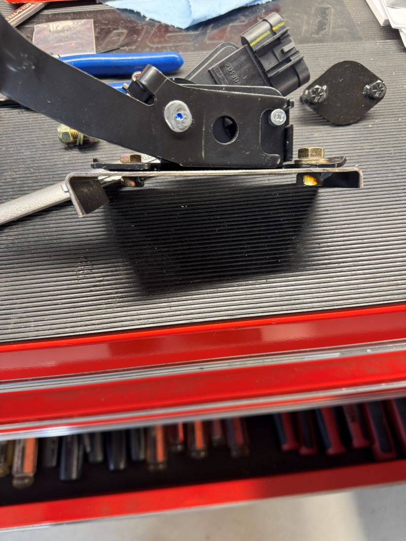

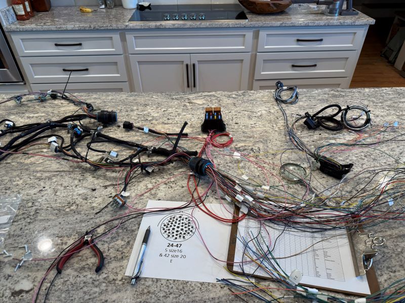

Next up, was making a throttle pedal mount, and getting it mounted in the car. From there, I moved to the PSI ECM wiring going to the firewall plugs. Yes, the wife let me use the kitchen island to lay everything out. She is a jewel, as I am sure everyone's here is as well.
