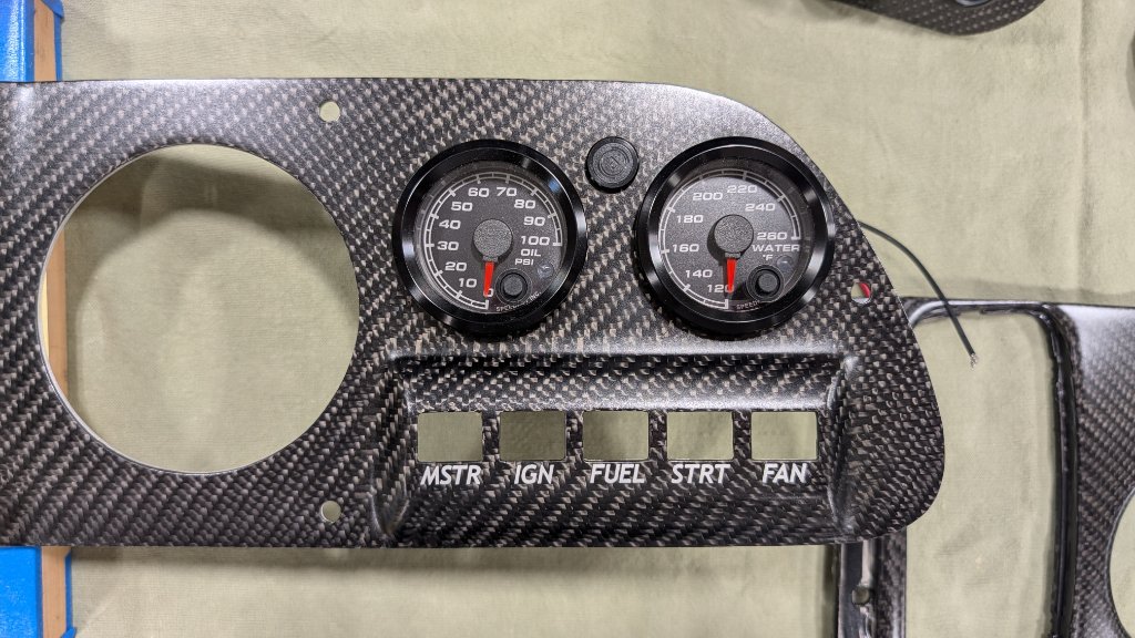

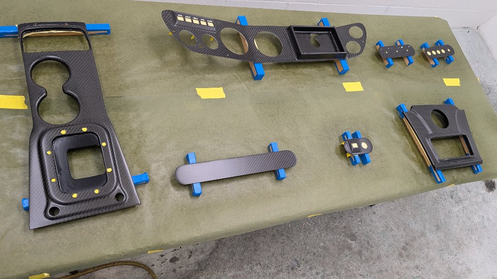

Needed to get some clear on the carbon interior panels so I could put them away safely, at least for a while. 4 coats of matte clear.

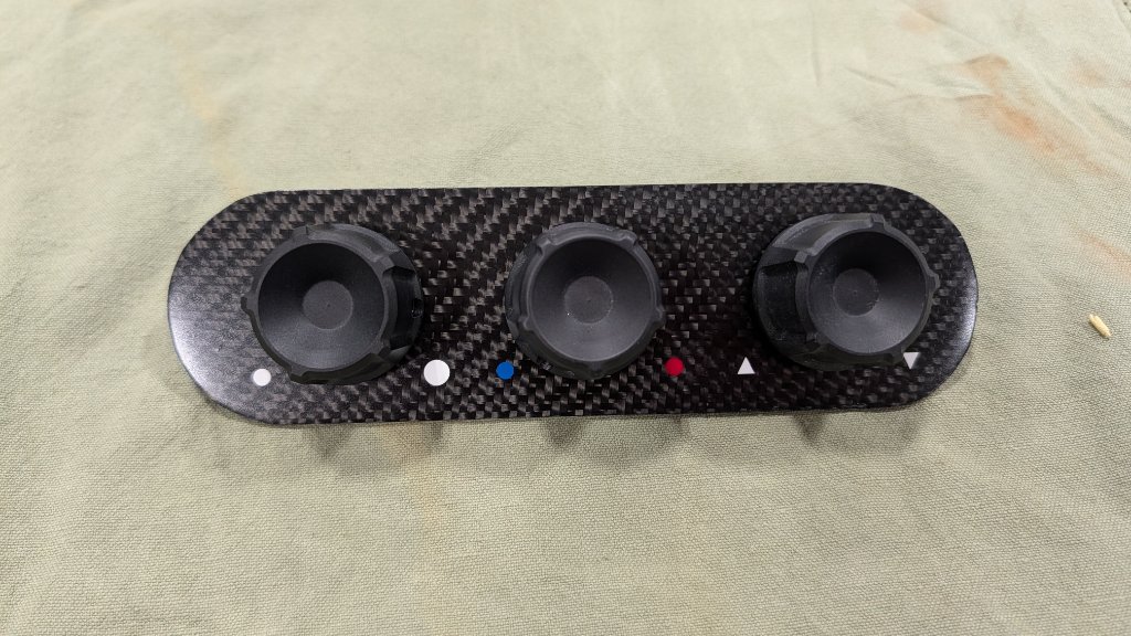

Need to have the AC knobs and the switches anodized so quicky fit up to pick the sheen.
