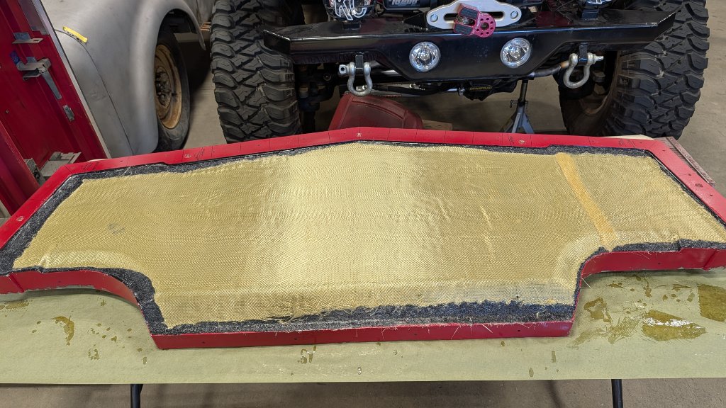

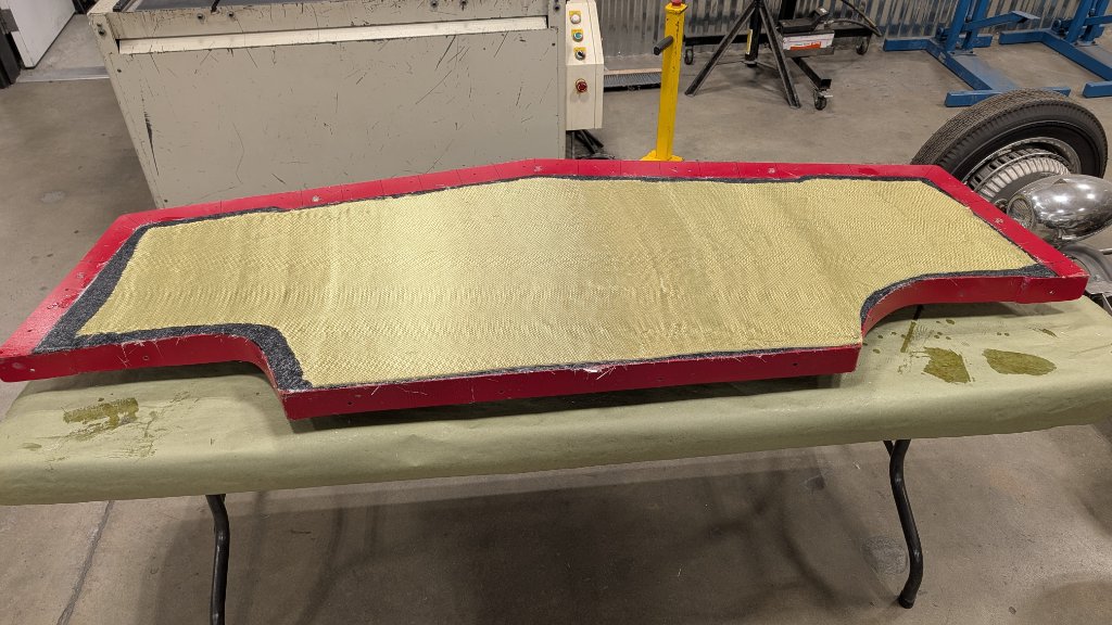

Fiat done. Back to the Camaro.
Laminated both halves of the lower splitter. Gelcoat, Carbon Fiber, Glass and a layer of Kevlar(yellow). Will put the two halves together tomorrow, should be interesting. Some might use 3M panel bond but I'm going to use 1/32" Fibers and resin as I need to drill/tap it so I can bolt up the aluminum portion of the splitter. That mix is ultra strong/dense and taps very well. Will only have about 3/8" of threads but already tested and I couldn't tear the 10-32 out, should work fantastic.
