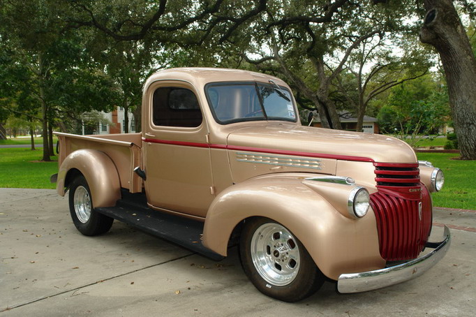

I have a 1946 Chevy Truck with hydraulic booster brakes. The problem is, room in the truck is very tight and when the steering column was added, the brake pedal had to be on the left side of the column. You have to use both feet to drive the truck. The problem is the pedal is mounted so high and with the cramped interior, you have to raise your leg pretty high to use the pedal. Not a good thing if you get in a bind in traffic. If I could rest the ball of my foot on the floor it would not be as bad.

In a 1946 Chevy the pedals were through the floor. But the last owner had power brakes installed. The pedal is mounted under the dash. They put a 350 in the truck and with the limited space under the hood the mount was a bit high and the cab space is pretty small.
Having to lift ones leg so high to brake the truck plus using your left leg to brake is a bit clumsy. I can adjust to using my left foot, but having to lift your leg so high is a problem and I worry about having to brake in a hurry!
I'm having some work done to the truck in two weeks. It has some suspension issues that need to be corrected. I may talk to the mechanic and see if the pedal can be repositioned. If it could drop 3 or 4" I could at least rest the ball of my foot on the floor and tap the brake when needed!
