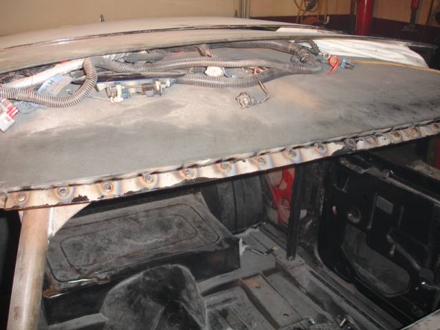

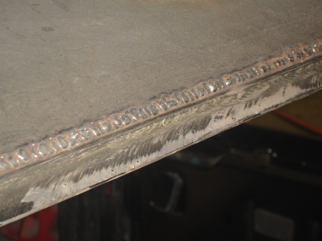

here are some pics of the flush glass,I've got to say that was a pain in the as*,I do alot of metal work,and it made hanging quarters seem like childs play
I told you it was pain. What are you doing at the bottom of the windshield.

I'm going to bend a peice of flat bar to the shape of the window and run windsheild rubber trim across there

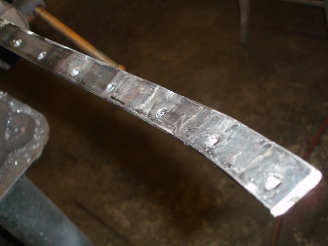

I'm sre there are alot of different ways to do this,Iknow Brian did his differently then I did.I took a peice of 1"x1/4" steel flat bar,curved it to the contour of the opening,to make up the thickness of the glass. then filled in the opening,see pics

How much room did you leave for the thickness of the glass sealing tape (that I assume you will put down before the glass goes in).
