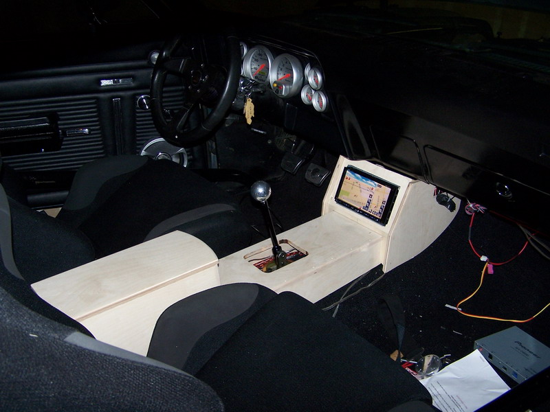

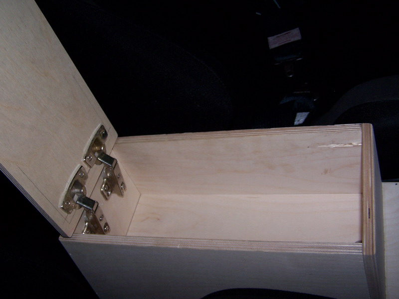

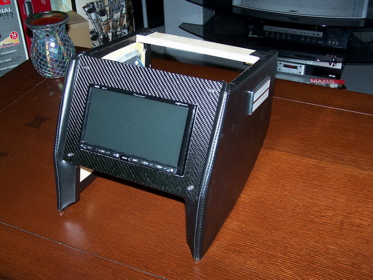

Payton here are some pictures of how mine turned out. I am very happy with it, except for that it's imposible to reach the stereo with the harness on. Thank goodness for remote controls.
David

I love to see and hear other people's ideas. I thought about making the metal frame...then out of aluminum. I can't weld aluminum. Still going back and forth on either glass or wood.
I like the where the stereo/ gps sits.
