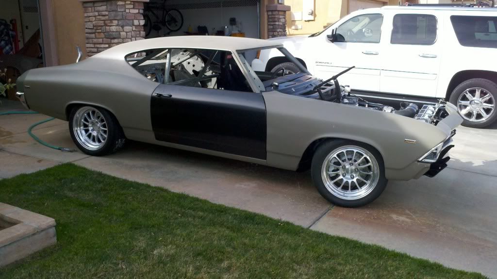

I got a windshield and a basic exhaust system on it (dumps before the rear axle). I plan to run like that and hopefully later mod my Ricks tank or possibly get one with shaved corners and clearence for a Fays 2 watts link and 3" exhaust. The muffler shop was only about a mile away so I drove it home. I still need to get an alignment badly but the mile drive was enough to know my remote oil lines still leak. I can't get the -12 AN to seal at the pan. The area is real tight. I am using Earls but just ordered some XRP lines and fittings.
I not 100% sure but I think not only is it leaking there but it have another leak in the seam. I am hoping that it is flinging oil from the lines if it is not well I don't know. Changing the pan means pulling the engine which will suck.
I should have the lines on Monday so we will see. I have the fenders, hood and trunk on but need to get them aligned better and all in one color primer.
It kinda a spotted mut
Tom
  #95
Old 03-18-2011, 11:10 PM
Its looking good. I may be crazy but I like that primer color.
  #96
Old 03-19-2011, 05:06 AM
65_LS1_T56's Avatar
65_LS1_T56 65_LS1_T56 is offline
Join Date: Jan 2011
Location: Mid-Michigan
Posts: 886
Thanks: 49
Thanked 25 Times in 12 Posts
Hmmmm....x2 on the primer. Weird, but I like it too for some reason.

  #97
Old 03-19-2011, 06:05 AM
BanditDave BanditDave is offline
Join Date: Apr 2008
Posts: 410
X3 on the primer...it just looks angry!
And btw, did you touch the suspension recently? If not then it has settled some and the rears look a lot better!

  #98
Old 03-19-2011, 07:42 AM
Steve68 Steve68 is offline
Join Date: Apr 2005
Location: orlando fl
Posts: 965
Thanks: 49
Thanked 45 Times in 33 Posts
I like the color of the primer too, and you know I'm a fan of the wheels!! looks good,

  #99
Old 03-19-2011, 08:01 AM
^^^^^^^^^^ what he said! LOL
The shadows and the primer color really give it a tasty look.
Sorry 'bout the leaking fittings.... Heres's trick that I use... I sneak up on the tightening -- and loosen it... and tighten a little more... loosen and tighten some more. Makes the two surfaces bed into each other.
That -- and there are "flare savers" -- copper "washers" you can get for 37* AN fittings. Put one between them and bingo problem solved.

  #100
Old 03-19-2011, 01:01 PM
Tom.A's Avatar
Tom.A Tom.A is offline
Join Date: Jul 2007
Location: So-Cal.
Posts: 950
Thanked 4 Times in 2 Posts
Thanks guy's for the nice words. I had the primer tinted wirth a drab olive color trying to look like the F-bomb which was actually paint. It did not come out the same but still looked better than gray.
Yes, you are correct it just settled.
