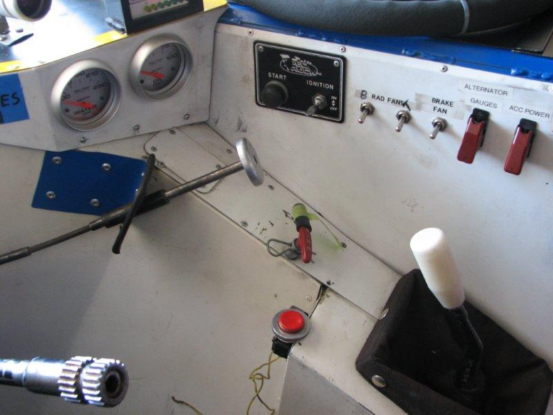

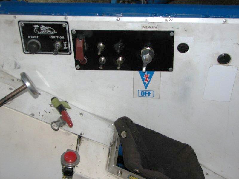

did a little clean up with the toggles
before & after And yes that is a trans brake button

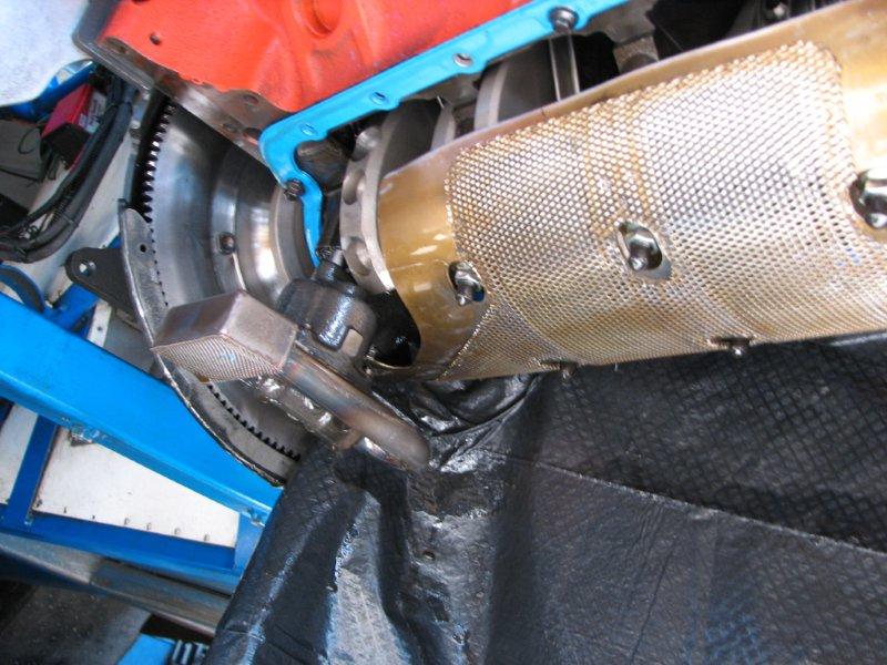

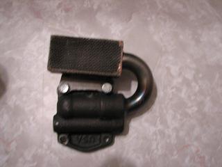

One of the issues we had was a loss of oil pressure in right turns ..It had an oval track pan and p/u so I fixed it.. i shortened the p/u and made another trap door boxing in the p/u in the pan (a hinge was added after the pic was taken..While i was in there, i changed all the rod and main bearings too
before and after

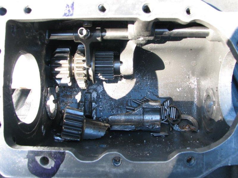

I also hurt the Jerico
.......hurt?
I'd hate to see what your definition of destroyed is.

.......hurt?
Destroyed?? There'd be nothing left at all
Send me what you can't use.......I'll turn it into some sort of garage art for ya.

Ouch! That's some hard driving.
