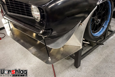

MORE FRONT SPLITTER & VALENCE WORK

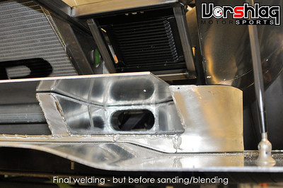

This front/splitter section is the "business end" of this Camaro, and a place where a considerable number of hours have been spent getting both the aero and aesthetics "right". Last time I showed some of the fabrication work on the dual plane aluminum front splitter and valance.
The lower valance panel (above) was based on an OEM piece but stamped in aluminum. It had to be heavily modified to incorporate the lower grill openings and cooler inlets for both the oil and p/s coolers as well as brake cooler inlet ducting. This modified panel and the custom parts below were both tack welded and now needed lots of final welding, sanding, and finish work.

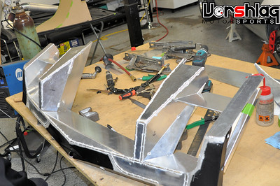

The front splitter assembly was built in stages and the lower valance and cooler inlets are joined together above and below the upper splitter plane. Almost everything here is made in aluminum and bolts together with discretely placed hardware, including the canard sections shown below.
These canards will help direct air spilling off the upper plane where we want, and complete the "lines" of the splitter. Admittedly these parts are part downforce, part styling, but without dozens of hours in a wind tunnel I cannot tell you if these are perfected or not - but this ain't an F1 car. We will do some aero tests in our initial track testing with the customer, of course.

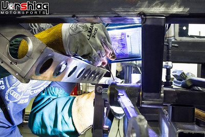

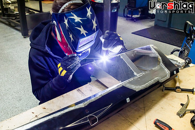

Ryan spent hours and hours final welding the initially tacked aluminum structures of the lower valance and grill openings.
Then he spent hours and hours grinding, sanding, welding, and sanding some more. These components are 100% metal worked, no bondo or putty tricks.

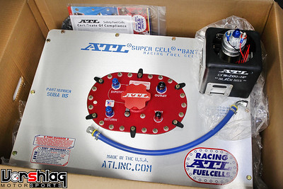

After discussions with the customer about safety, we decided to move from an aftermarket fuel tank to a proper fuel cell. This had a lot to do with the projected track speed and capabilities this car will have, and the customer wanted a SAFE car in the end. A fuel cell also just fits a build of this scale and magnitude.
Ryan mapped out the space allocated for the cell and we ordered this custom aluminum ATL cell can and bladder. This was spec'd with the internal surge tank and pumps for ease of plumbing. The surge tank is crucial to keep the fuel pump inlet submerged at all times, even at low fuel levels and 1.5 g or higher loads.

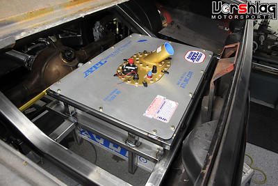

After waiting a number of weeks, the fuel cell was built and shipped to us at "Vorshilang", then we began discussing rear diffuser shapes and placement of the cell with the owner.
Ryan then laid out this fuel cell "cage" that he built out of square tubing. This will act as both a stable mount and a protective structure for the fuel cell. He even custom machined threaded bungs that are welded into the upper perimeter of the "fuel cell cage" which the upper lid of the fuel cell bolts into.
The fuel cell "cage" and the cell were both then installed into the trunk area between the frame rails. The lower valance panel even ties into this structure, replacing the structure normally in the spare tire well and factory trunk floor.

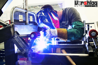

With all of the geometry of the frame components checked and rechecked, and now everything out of the way, many hours were spent final welding the main chassis and cage. First Ryan started welding with the chassis still on the table (above).

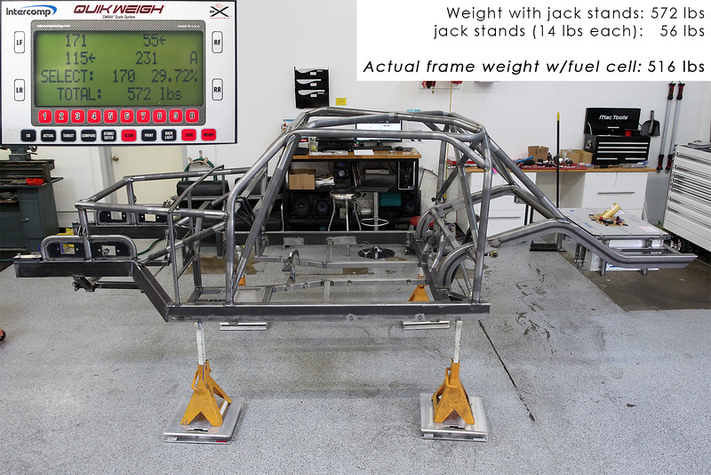

Then the chassis came off the table and he spent more hours welding, grinding, and finishing the bare chassis. It was both light and rigid enough to move around on its side to get to all of the hard-to-reach places, to finish weld every joint without having to do overhead welding on your back (which is hard).
The main chassis was then weighed. I mean come on, its Vorshlag - you would expect this. We will show the merged body-chassis weight in the next forum update. Speaking of weights, I need to right a wrong...

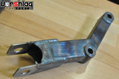

In my previous update to this thread I mentioned something that was "non-factual" about the replacement tubular steering arms. Ryan built these to replace the solid steel units that came on the car (which were heavier, had some sketchy welds, and incorrect bump steer geometry for the steering rack we chose). I felt them both in my hands, spit-balled a number, and actually wrote "these new steering arms save 12 pounds." Oh boy, I'm now well on my way to becoming a politician.
Of course several of you sharp eyed readers called my bluff, and I had to go weigh these parts. Then eat some crow when proven wrong. I "eyeballed" the weights and threw out a number that was nonsense. I thought I remembered weighing these arms, but I "mis-remembered" that fact. These tubular steering arms saved all of 1.8 pounds for the pair, not 12 pounds. So this is me admitting my mistake, showing the proof, and promising to try to never making that kind of error again. I'm sorry folks! #NotFakeNews

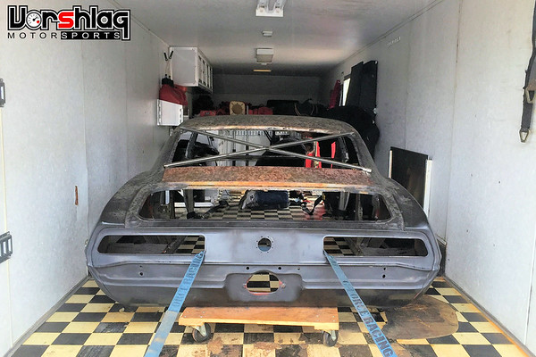

UNIBODY THEN CHASSIS BLASTED, REPAIRED, PRIMED AND PARTIALLY PAINTED
Our crew reassembled the naked Camaro chassis with the drivetrain, wheels, and suspension for the next phase of work. It would also look more presentable for our 2016 Open House we had on Feb 27th. Lots of people came to this event to see the shop, eat the food, get their free SCCA annual tech.... but many said they came just to see the Camaro. It was "naked and afraid" but didn't disappoint.
Meanwhile I had delivered the unibody to our paint and body experts at Heritage in Sherman, Texas. I am usually delivering or picking up cars there a couple of times a month.

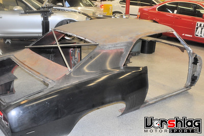

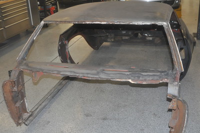

With the unibody sculpted down to the bare minimum needed there were now exposed areas that were pretty rusty. Some of these are normally not painted when the car was built, so that's to be expected. The underside of the roof was pretty nasty, with headliner residue and some light rust. Other sections were clearly rusted and needed replacement. Of course it was raining when we loaded the semi-bare metal tub into our trailer...

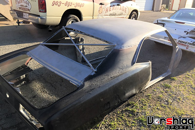

Sadly we never weighed the stripped unibody, but two people could move it easily. I took the pictures below at Heritage after the body had been bead blasted on all of the sections I asked them to (everything but the rear fenders), but before any primer or paint went back on. This car will be painted in 2 stages - some sections that the cage/frame cover up on the unibody needed final paint now.
They left the E-coat on the new rear fenders and tail panel, but everything else that was original steel was mostly in raw steel form, from work done by a previous shop who blasted some sections. Heritage concentrated heavier blasting around some areas on the tub that had a bit of "tin worm" or which had visible body filler - like on the front and rear window frames and A-pillars.
