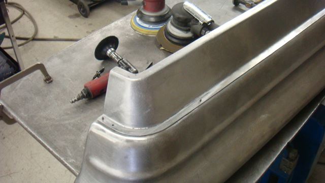

Originally Posted by wiedemab View Post
What are you guys using to smooth out the welds? They have a bronze-ish color? Just curious if you are using some sort of a metallic filler or something after they are welded and ground to give them that extra smooth look.
Thanks
We used a silicon bronze rod to weld that area with... It is easier to grind and finish...

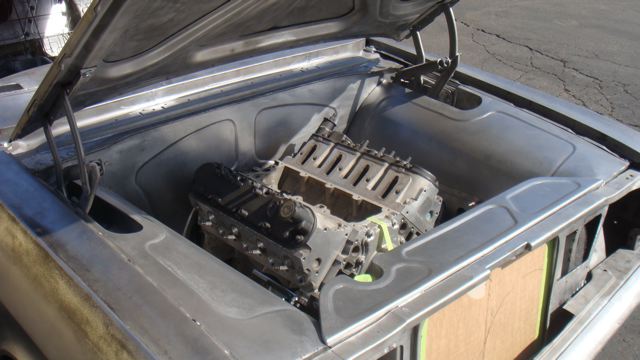

metal work looks OK, but damn!! who built that chassis, it looks killer in those engine compartment pics, are you gonna run those sheet metal panels and cover that fancy chassis work up or are they temporary? Just messin with you, sheet metal work looks amazing, always impressed with your work!!
Thanks
dont let the fool you is gold paint added to bondo .
really , the silicon bronze rod is perfect for sheetmatal tig work .
looks great !

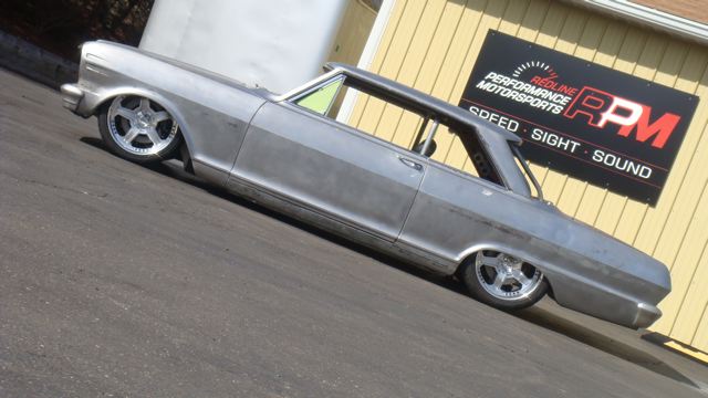

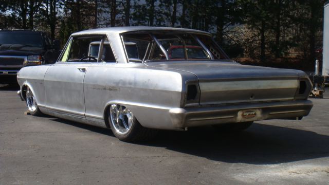

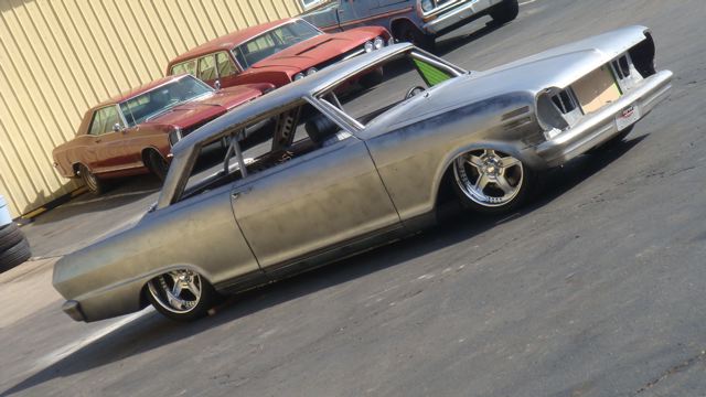

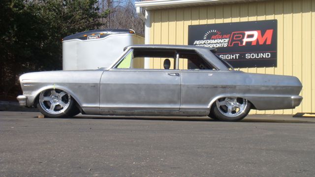

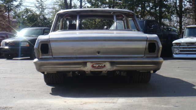

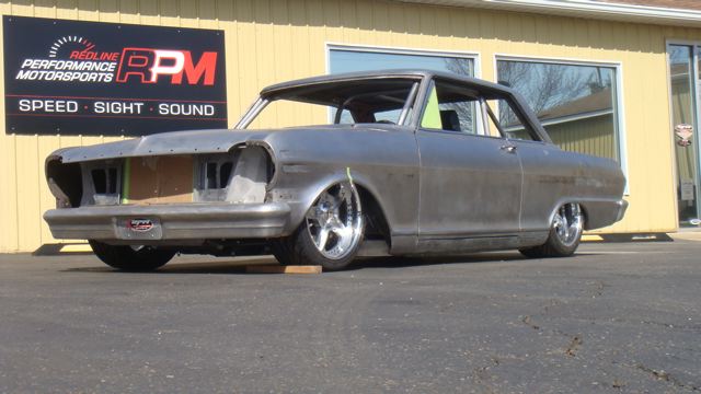

Rolled the car outside yesterday and got some pics... Getting ready for body work and paint..

WOW!!!! Love the stance and the engine bay. Very nice.

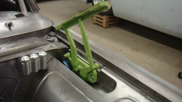

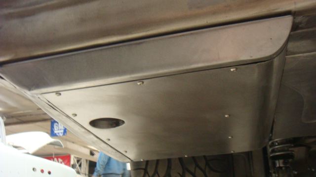

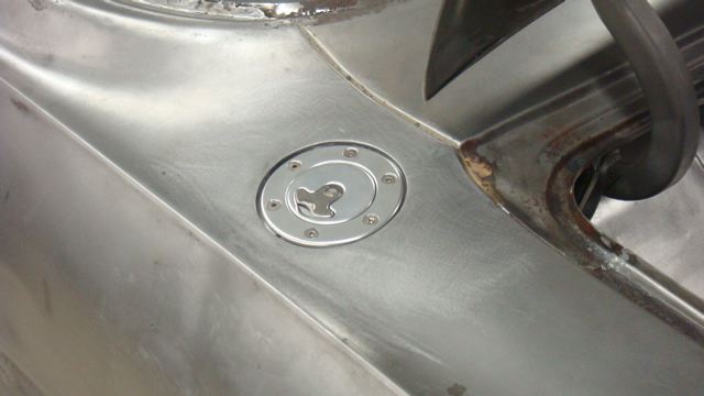

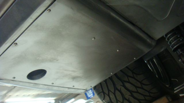

Time for a few updates... We worked with the Ring Brothers to come up with a one off set of hinges for this car.. They work and look great!! We also finished the belly pans under the rear of the car between the quarters and the fuel tank.. We also are making a chin spoiler for under the front bumper, raised sheetmetal floor mat panels that will sit flush with the rug and will have a non slip type of material inserted and lastly installed the fuel filler cap in the top of the quarter panel..
