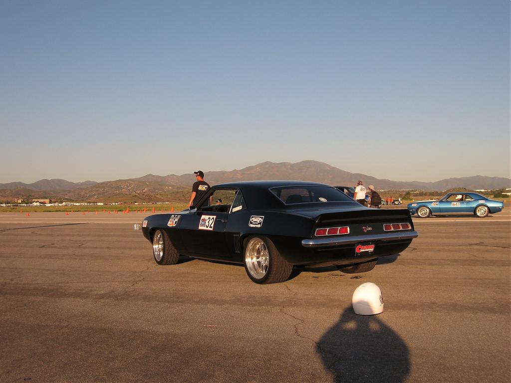

For a staggered 18/19 setup, I really like the setup on this car from HPI Customs (member 64pontiac)
Rear wheels are 19x12 with 7 inches of lip (rushforth rated x) 335/30/19 Tire and fronts are 18x9 (Tire size not sure)

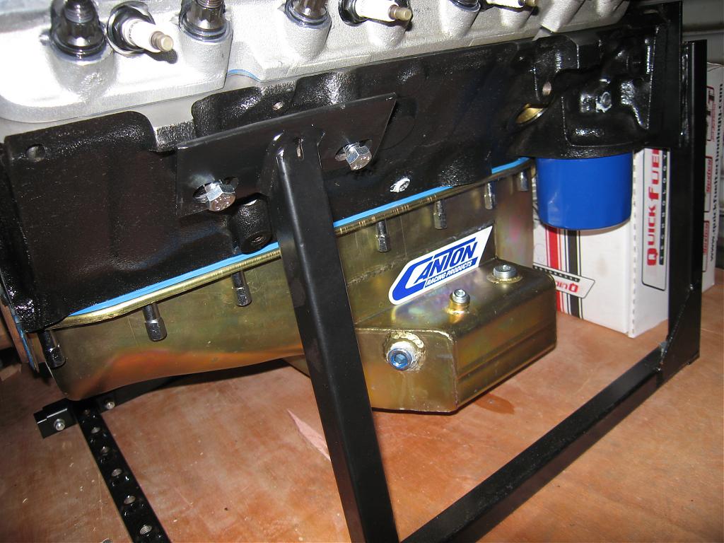

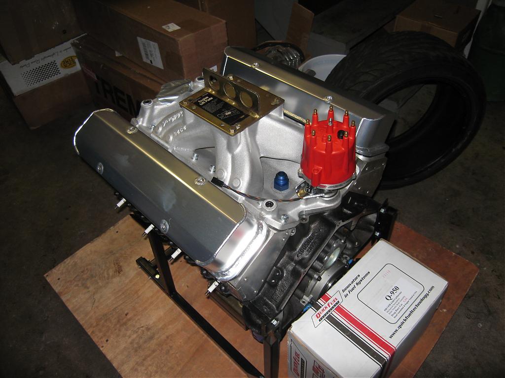

The motor is here!!! She is just beggin to be run hard.
421 stroker
bowtie block
scat rotating assem.
dart heads
edelbrock intake
canton road race pan 8qt
tuned 950 quickfuel carb.
This beast made 561tq @ 5200rpm and 591hp @ 6100! BRING IT!!!!!
