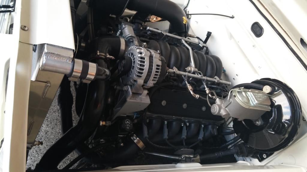

Truck is getting a 6.0 from an 03 hummer lq4 and a built 4l80E.
Power will be assisted with a Borg Warner s480 turbo, 80 lb injectors, circle d triple disc full billet converter and a HD-2 shift kit. Looking for somewhere in the 700-800 WHP range.
So, I got to work getting the engine in place and building some motor mounts.
Engine is nice and low in the engine bay, tranny should work out nicely and the engine is staggered to the passenger side to assist with steering rack, booster and exhaust clearance.

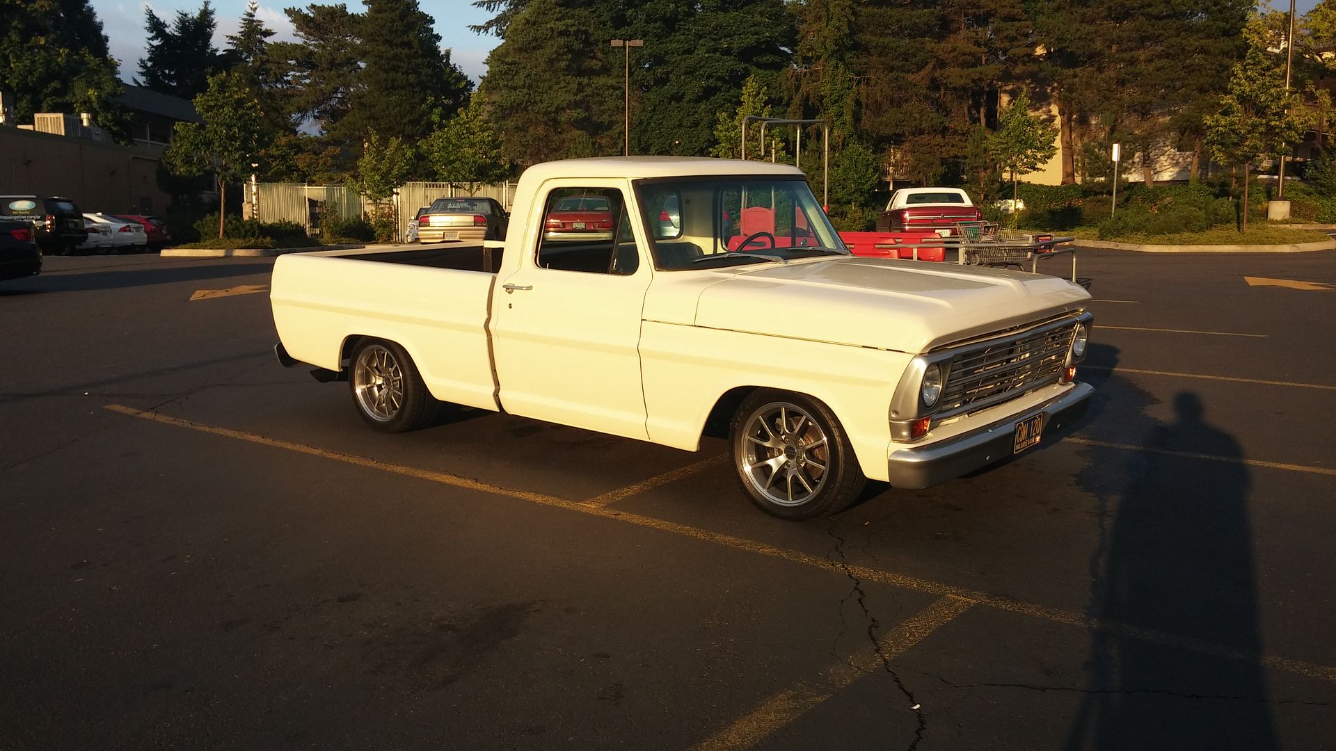

Pretty sure that it is going to get a nice coat of shiney new whimbledon white all around.
Trying to decide on wheels right now. Thinking 20x9 up front and 20x10 in the rear. Going back and forth between 18's and 20's though....18's seem much better to drive on, and a little bigger tire.
