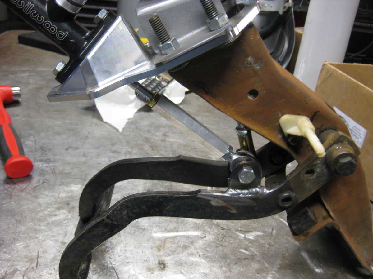

While that's off, he's been playing with some of the firewall mods. We bought a DSE panel and a wiper motor to move under the driver's fender. He also bought more body pucks to mount the rear IRS.
For some reason, the slave cylinder kit didn't line up, so Scott added a double capture bracket to allow some shifting. He also made a mount for the hydro boost that's going in, so we can stop reliably.
