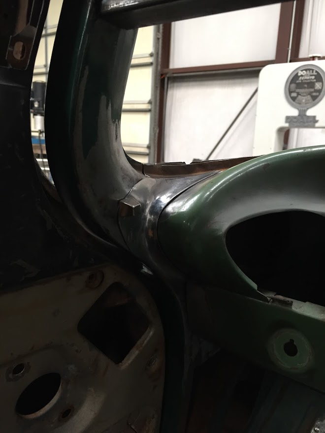

Dash done. Lots of work on ashtray to hold A/C controls. But it is in and I like the dash not narrowed with the position of the seat now. The transition needed some work, but looks amazing now.
