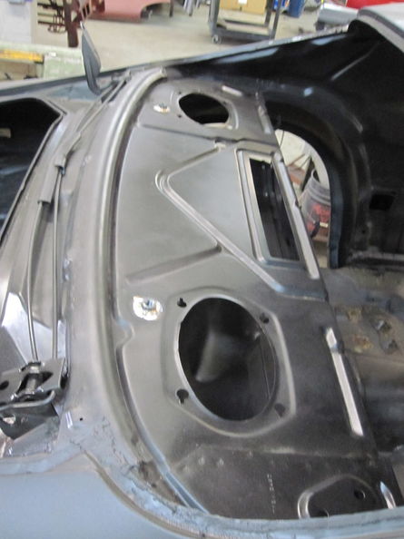

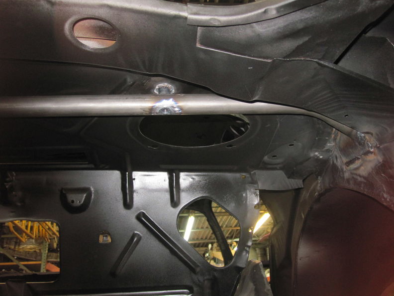

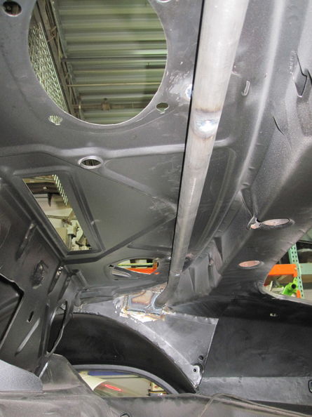

Originally Posted by grendel View Post
Looking really good. How did you anchor the shoulder belts?
Thanks John,
I had the guys at High Speed Welding weld bung in the package tray for this exact reason way back in July in 2011
