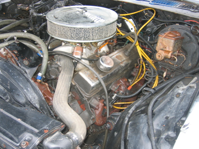

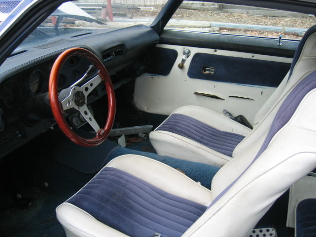

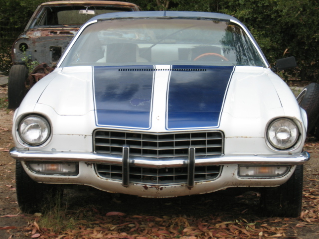

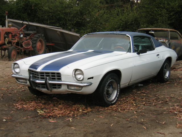

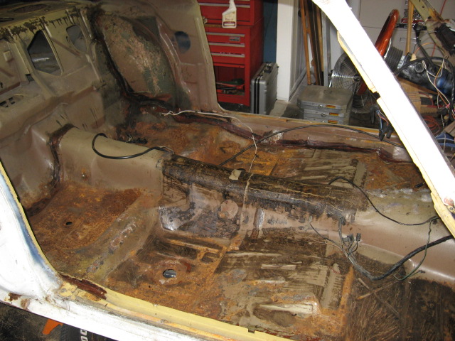

Here is what we started with.

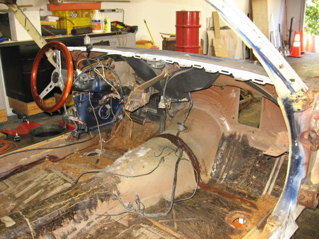

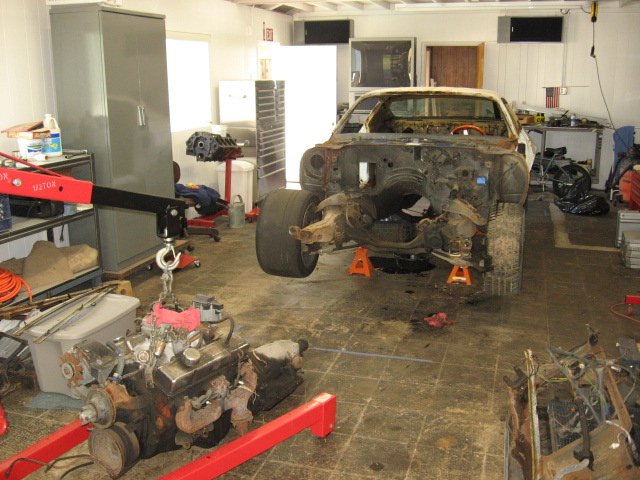

After we got the car home from Mary's, we took it all apart.
After we removed all the bolt on items, we started cutting away.
