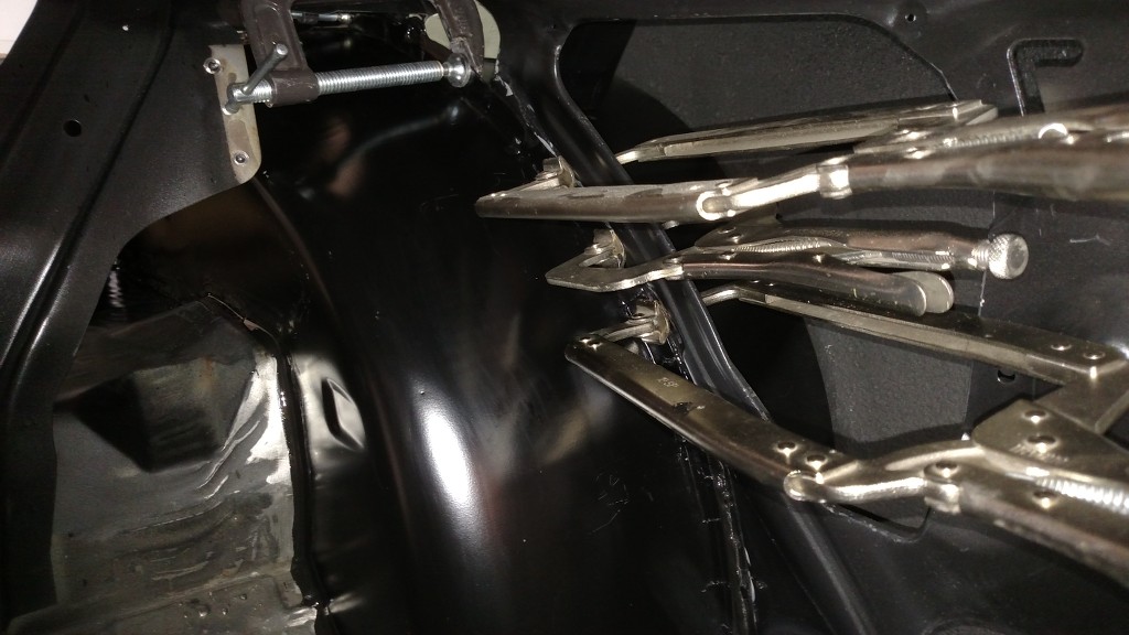

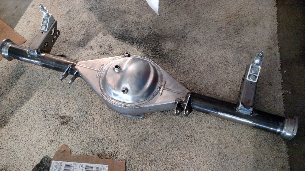

Some progress going on ... finished getting all the quarter off and started the mini-tub,picked up the rear end from Vince (thanks for TIG'n all the brackets), my headers came in, sweet fer sure!
The inner wheel house is bonded and sealed to the car forever now ... now I have to wait til its cures so I don't get grinding dust embedded in the adhesive!

Looks good Chief! You'll be done with metal work in no time!

Man, those headers are a work of art. They will look right at home next to your handywork.
Keep it up Chief!

what width did you go with for your read end?

They are a work of art, hopefully I can do them some justice on my car!!

Working with Jay at MillerBuilt I came up with a 56.375" between housing ends, hopefully if our math is correct I can use the same wheel and BS on the front and rear end (315 on a 10.5 w 8"BS), simplifying the choice of wheels and ability to rotate the tires!
That's my story and I'm sticking to it!! Front wheels are on order and the rear axles and pumpkin are in progress!
Trying to finish the passenger mini-tub in a few days vs. years on the driver's side, lol!
