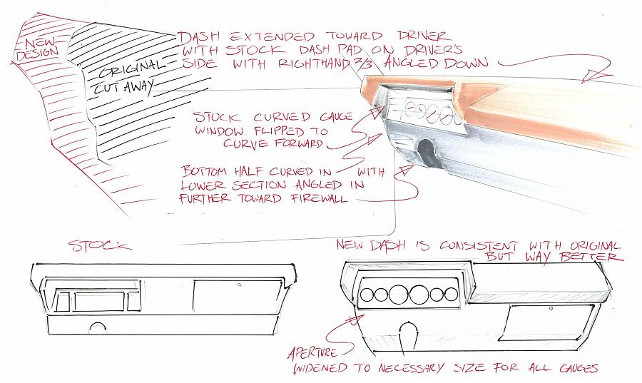

Originally Posted by 214Chevelle View Post
Not sure on how to advance the styling of this car, but the dash looks good to me. Subtle and classy. That dash and console design, in my opinion, looks like it can withstand the test of time. It's no too flashy where it would look dated in a year or two. I like it. Also, glad to see you still have the car thru a divorce. I have some friends who got divorced and the spouse neither wanted the car nor knew what to do with it. They just didn't want them to have it and knew it would hurt them to take it.
I'm glad I kept the car too, just want to get it finished, but the details are endless. Have several things up in the air that need decisions. Hopefully I can get some help and suggestions here.

I too hope you continue to work on the car. Use whatever motivation you can to bring this to completion.
I love your idea about extending the lower dash and angling it back. That would definitely help with hiding the bottom of a Gen IV evaporator and the A/C tubing. And it wouldn't look "tacked on".
