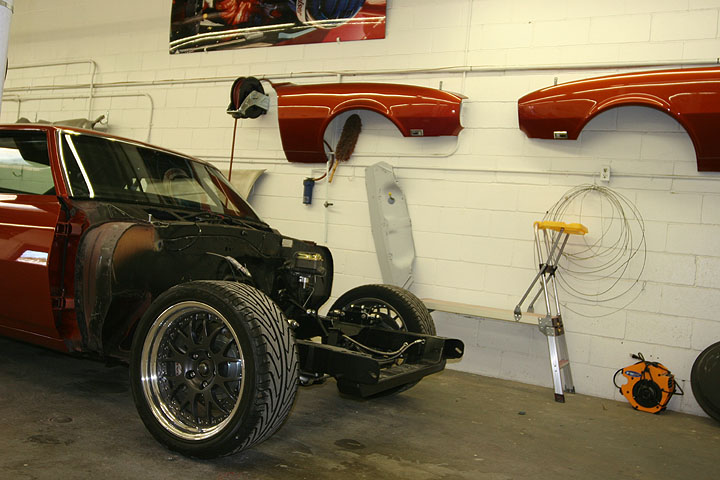

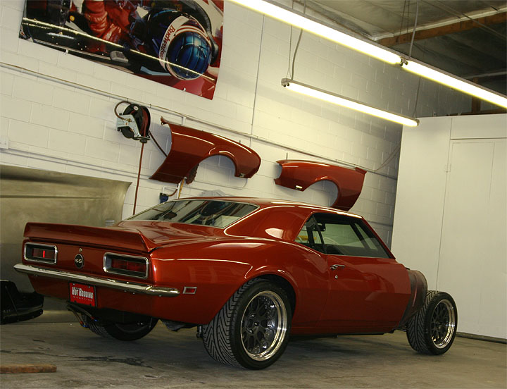

Originally Posted by Roger Poirier
Steve, What front sheet metal, When you shipped it out a few weeks back in had the front fenders on it. What are we talking about here? Why a new firewall? Did you have to move it back to fit the new engine?
Questions, questions, questions...
Well, you know how I just can't leave well enough alone
we pulled the front sheet metal and we are completely smoothing the firewall.. the only remaining holes will be for the MC and the steering column, even the wire block is gone. the inner fenders and firewall will be shot in body color. I also have a core support closeout coming from DSE. I haven't decided what color I am gonna paint it.
The only mods needed for the subframe was a slight enlarging of the trans tunnel for the T56 (21st Century supplies the pre-formed parts).
The shop just recieved in their new tool to cut heavy gauge steel so my firewall should start next week.
As she sits now..
