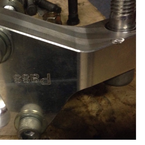

Remember that time you figured out that your nice billett steering arms are hitting the tie Rod ends and locking up the steering ... Gee that as a fun time wasn't it

Jesus thus could have been bad

Glad you found it now.
We spent a lot of time, cycling steering, suspension, etc. Found things like control arms hitting and locking on coil over springs, sway bars hitting and locking suspension down... I guess "that's hot rodding"

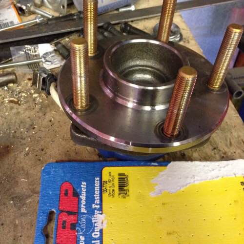

Since I had to take the entire front suspension off to drill two holes :-)
I figured I would replace the wheel studs with longer ARP studs..
In keeping with the theme of Scary stuff I find.. I think a shorter bolt should have been used on this hub to spindle connection....

Is it longer for your steering arm or something?
Yeah, it's a bit close.

Just too close for comfort I cut 1/4 inch off it and it still had more to go...

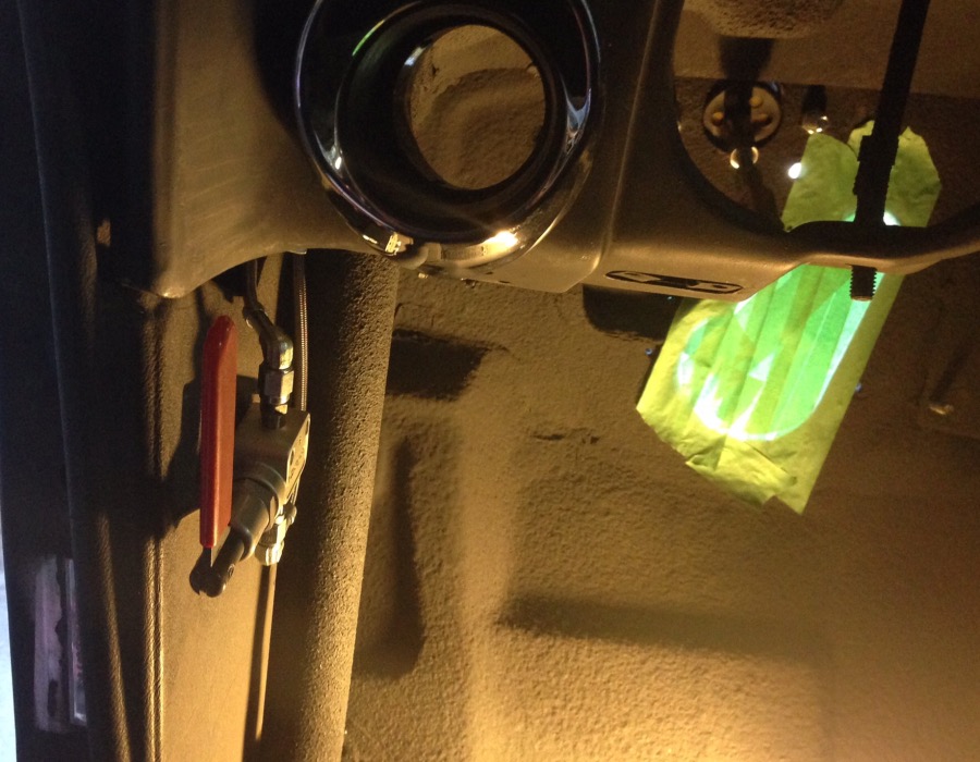

So haven't seen anyone do this but I got obsessed with the idea to be able to adjust the brake pressure from the drivers seat

So I picked up the detent type valve ran these neat bulkhead connections with -an to the valve . It's in a good spot to get to it without being in the way

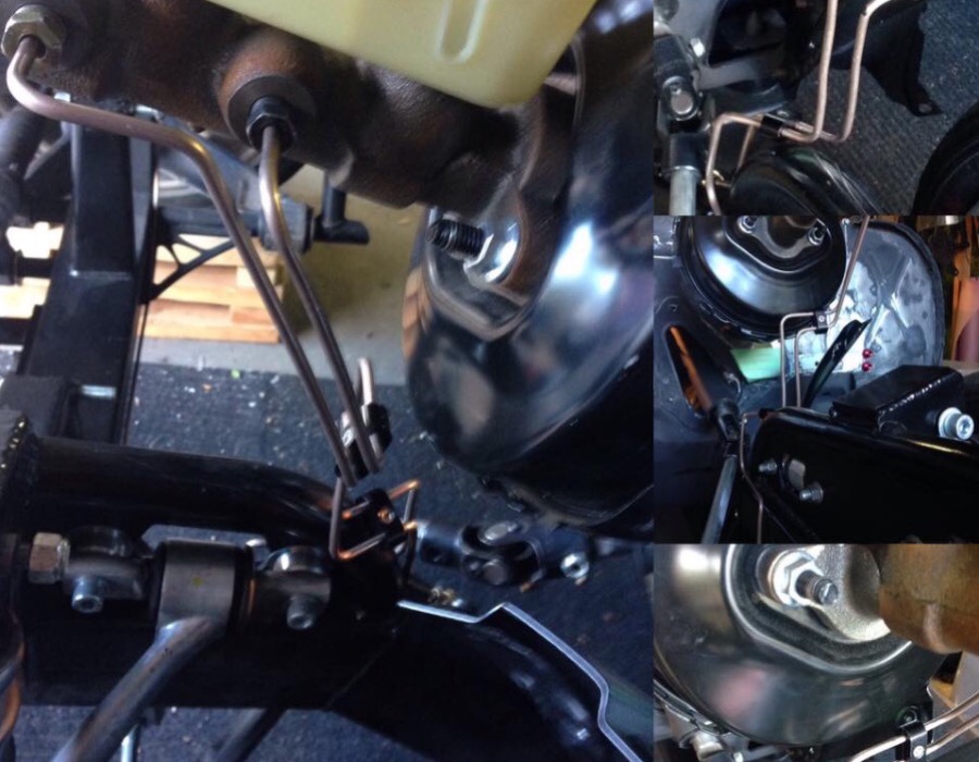

Had to redo this as it was interfering with the steering column

The lines look good.
