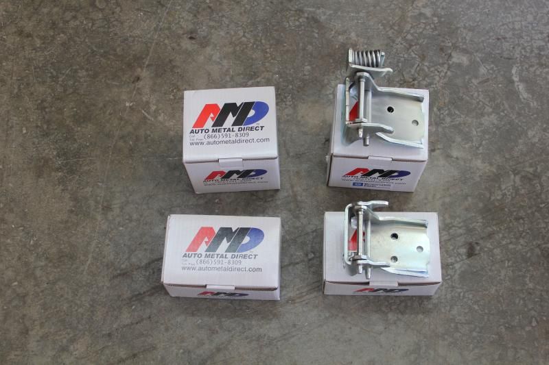

Well, I actually got out there and got a little done. First, I got everything out of the boxes. Bought some new hinges from AMD....
