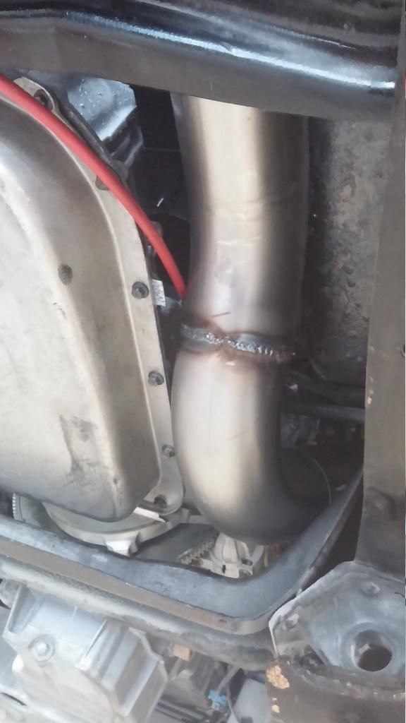

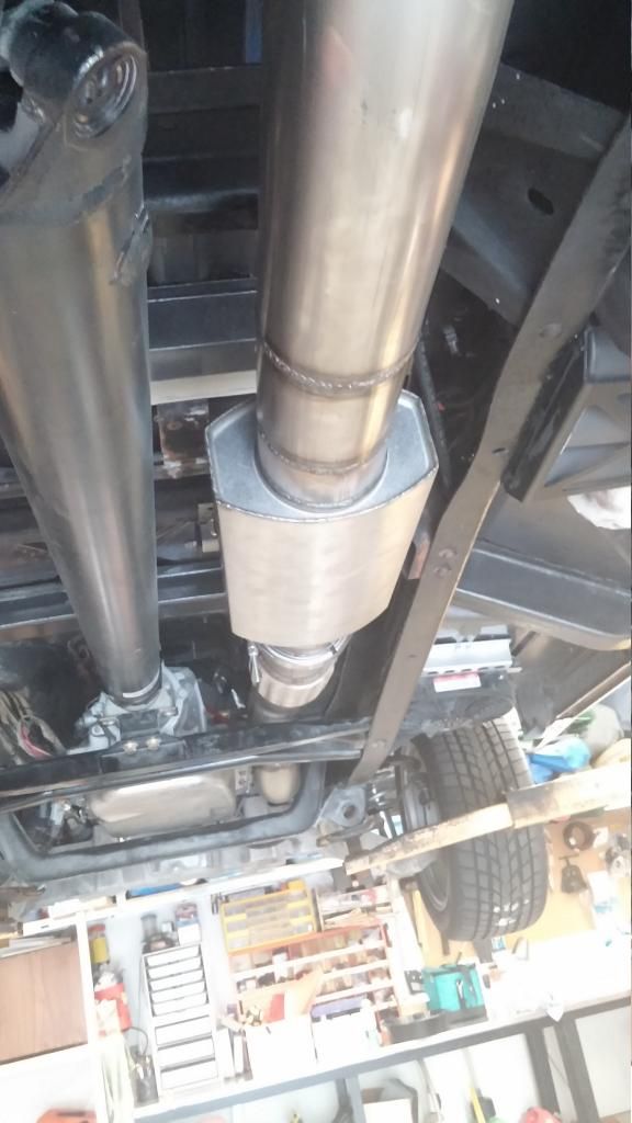

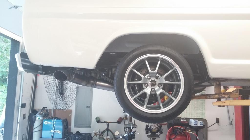

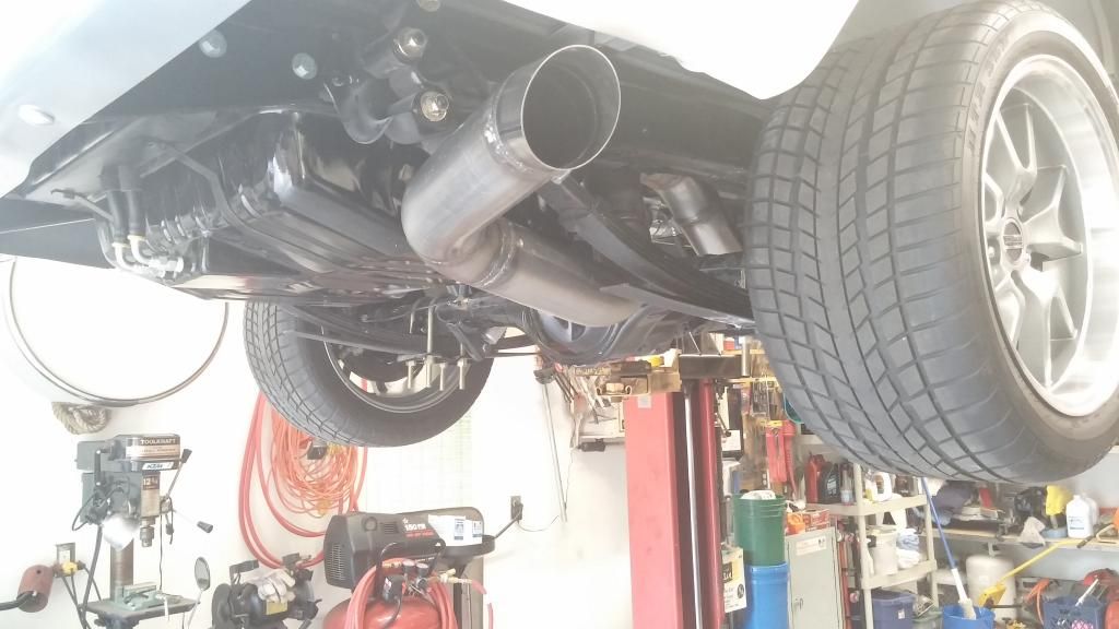

I went up to my neighbor Brians place and got the truck up on the lift for the day to work on the exhaust.
It was a damn good thing too, it would have taken me 4x as long to get this done on the garage floor. Actually, I might not have been able to do it on my floor at all with the clearance needed to pull the parts and weld them out.
Turns out that it would not have worked well at all to do the side exit in front of the tire. It would have made it necessary to remove the exhaust to get to the battery and it kind of looked terrible.

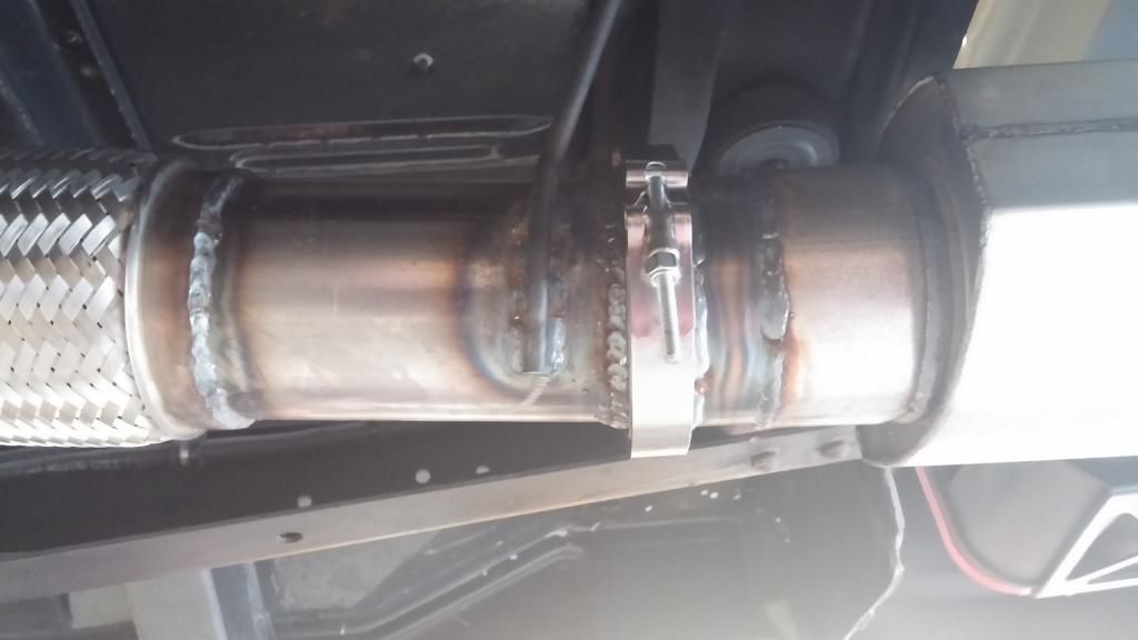

I ended up running 4" from the downpipe, over the first crossmember, then to a flex pipe and hanger then a 4" Vband to split the exhaust in two pieces for removal purposes.
Then into the muffler, over the rear axle and out the passenger side between the bumper and rear tire.
It was a ridiculously tight fit getting past the tranny, over the x member and below the body then over the axle and between the spring and fuel tank.
It turned out pretty good. Under the truck has awesome ground clearance, under the tank the very rear is pretty low but still a good 5 or 6" off the ground. I am not worried at all.
Here are a few crappy pics....I am going to paint the rear most section with high temp satin black paint to make it not stand out as much.
