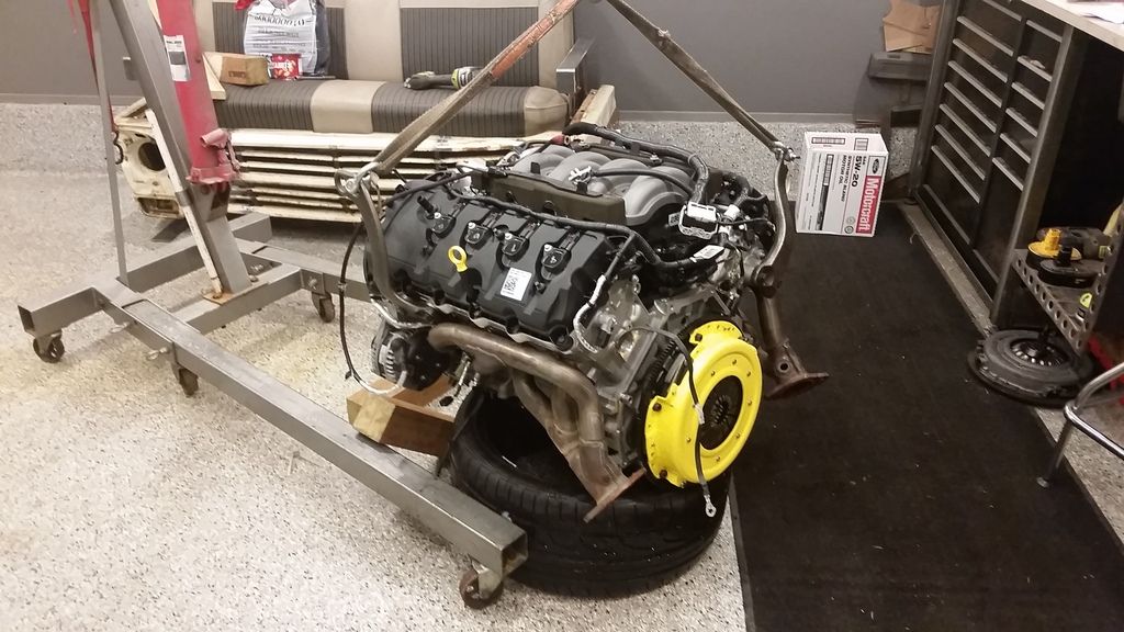

Well, motor showed up at Ford around 2 so I headed down there and picked it up. I was pleasantly surprised for once, Not only were all the parts there, on time and they loaded it up for me. They gave me a $300 in store credit after the purchase I was not expecting..
Not to mention the engine came with more parts than expected!! New intake, water pump, idler pulley, motor picking eyes that made our job so much easier. Also came with all the sensors on the engine proper.
Got it home and got it all unloaded....did I mention how nice those picking points were?
We then worked on transfering all of the parts onto the new engine, accessories, alternator, injectors, new Pilot bearing, transmission spacer plate, exhaust manifolds, flywheel, clutch and pressure plate. I also pulled the oil pressure switch and ran three quarts of fluid through my pre oiler setup. You could hear the oil making its way back to the oil pan, and pulling the fill cap you could see it running out of the timing gears and the cam. It was pretty neat actually. Rotated the crank shaft while pre oiling as well.

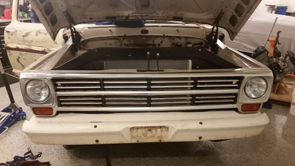

Its about ready for the front clip to go back on. I need to swap on a couple of pigtails on the harness for a change in connector at the Cam Solenoid.
I should be pretty close to firing it up tomorrow night.

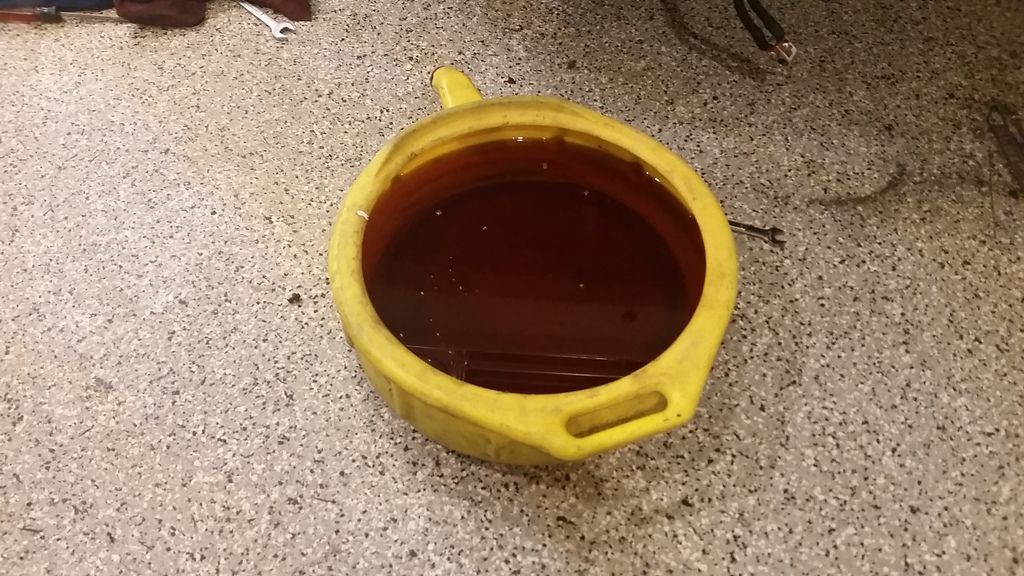

Made some good progress tonight. Have everything back together ready to start......Not too sure how I overlooked it but apparently this thing comes with a pan full of oil? Well, I did not check it first and added oil and ended up with a ton of oil in there. So I had to drain it all out and start over, guess I need to get more oil tomorrow and fire it up
You kind of have to laugh at this...at least its all I could do. That is a lot of oil.

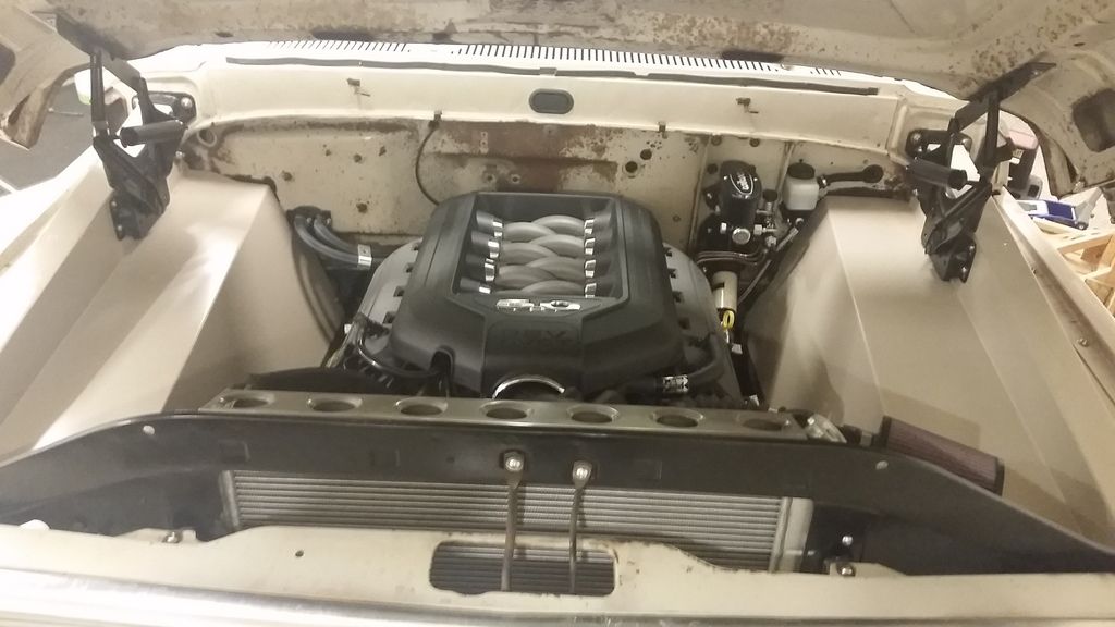

Got it up to temp and got the coolant all topped off and checked everything else out. All looks good.
First trip around the block and its nice and quiet.

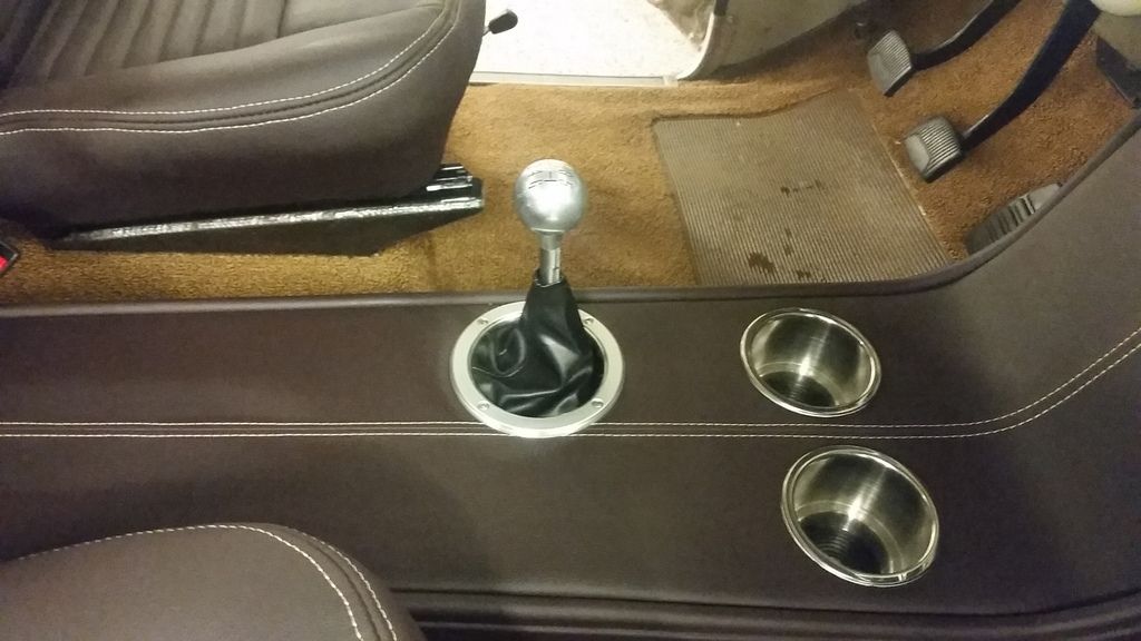

Worked on getting the new shifter extension built and installed and the new shift boot and ring glued up and installed. Turned out really good I think

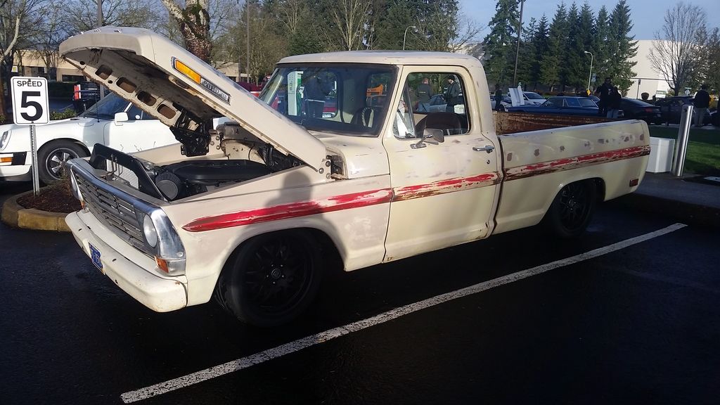

Buttoned up a few things, got the new plates on, cleaned the windows and hit the road for the first real time ever.
Drove south of town a ways and hit the cars and coffee.
Was really interesting to hear people's thoughts an opinions on the truck. People would walk right past it, stop, come back, walk around it and then smile. Lots of people wanted to talk with me about about it. Made me feel good.
