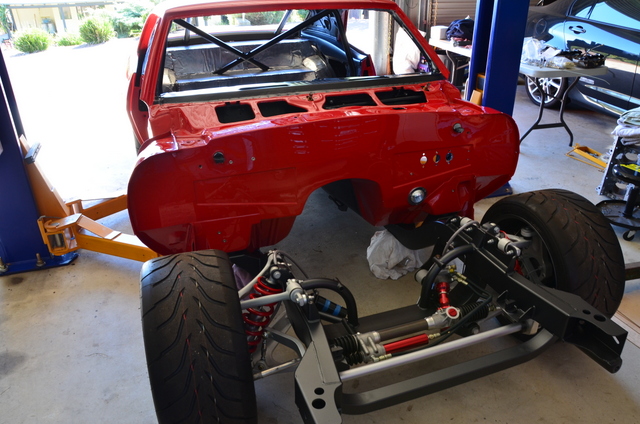

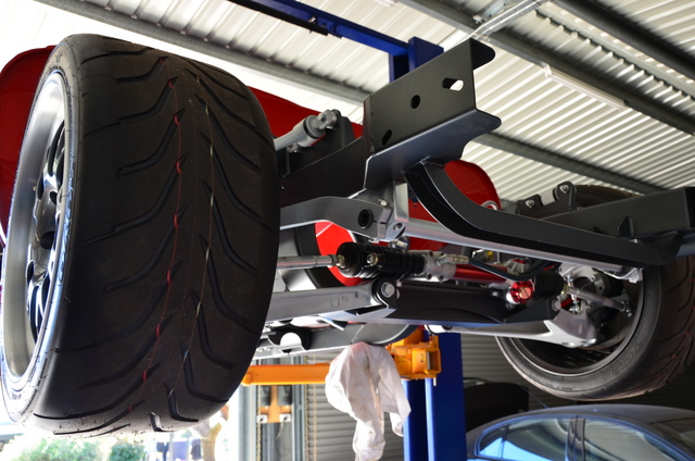

I purchased Art Morrision front and rear clips.

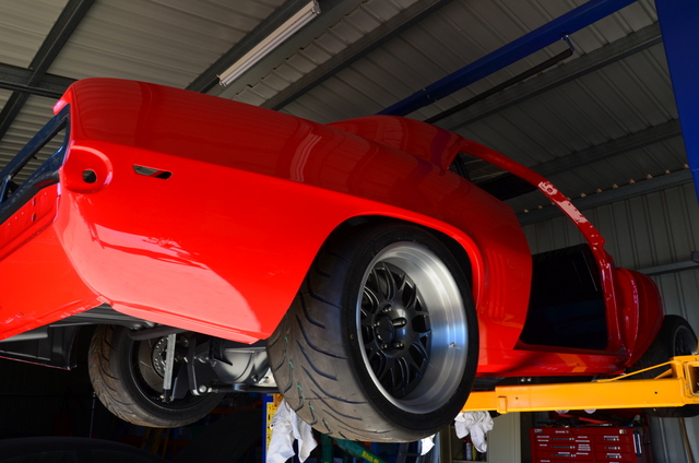

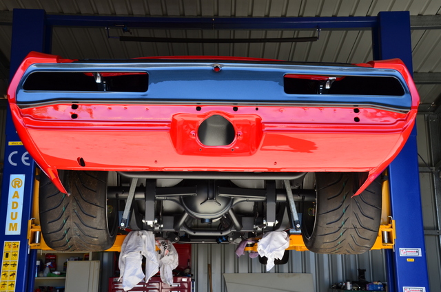

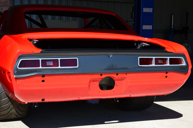

It's been moving along pretty well the last year.
Bringing it home after the firewall, interior and underside where painted.
The red is Sting Red, the interior is Matt Black and the underside is Gregorio Silverstone.

Great progress.
I was just wondering if you were going to run that suspension as a 5 link? I know AM offer both the 3 and 4 link option, but is there a reason to run 5?
Just curious.
Andrew
Old 06-03-2013, 06:14 AM
Greg from Aus's Avatar
Greg from Aus Greg from Aus is offline
Join Date: Jan 2008
Location: Western Australia
Posts: 808
Thanks: 87
Thanked 20 Times in 3 Posts
Originally Posted by andrewb70 View Post
Great progress.
Just curious.
Andrew
Andrew, it"s the same setup that was being used in Project Unfair, I believe there is only the 2 of them. I will use the 4 link for the drags and the 3 link for everything else.
