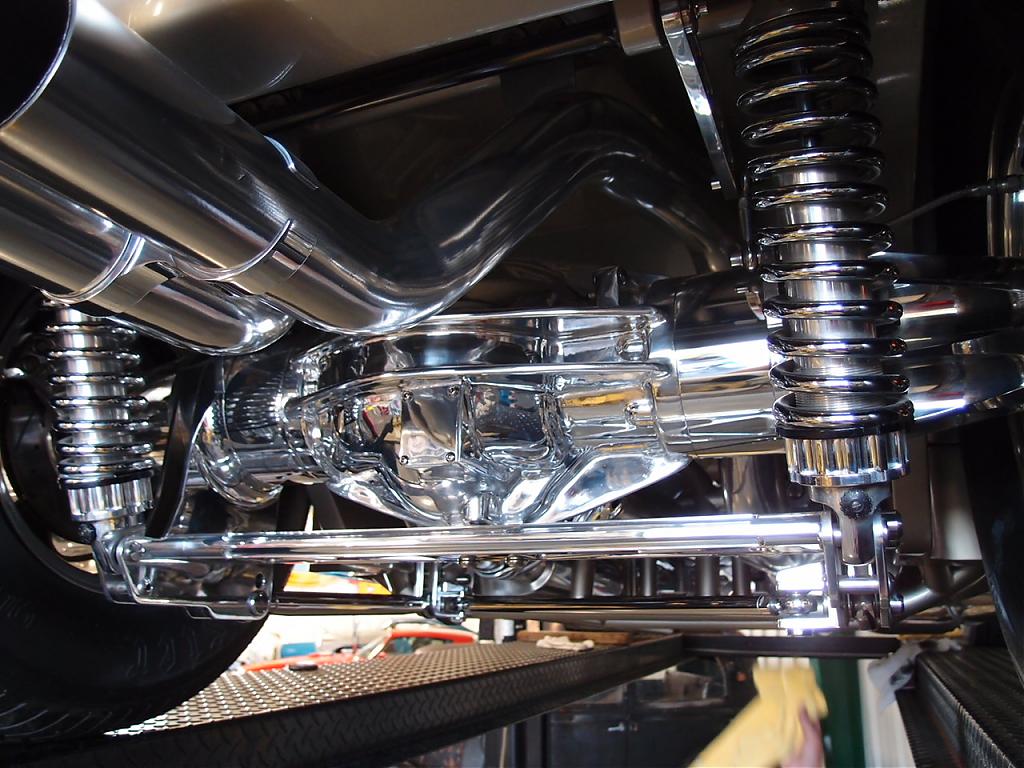

I think you could repair that cracked rear housing W/JB weld.

That's too slow to set.... Chinese sheet metal works faster, comes on a roll in silver... and is rated to 200 mph.

I wonder which quick change manufacturer, That is a pretty odd place to crack. I wonder if it might be mounted in correctly. Those quickchanges typically handle quite a bit of power with ease.

The Champ Adapter is the same housing but for straight axles - the Independent is shipped with 1350 yokes -- ya don't need 1350 yokes on a whimpy POS... if ya get what I'm saying'
Champ Adapter
Ideal for big horsepower cars, this combination adapts original Early FordŽ side bells and tubes to our full size Championship Quick Change. Assembly includes a Winters Track differential designed specifically for this application, heat treated lower shaft and a 10 spline straight cut gear set of your choice. "Hot Rod Heaven".
Championship Independent Quick Change
Winters Independent Quick Change . What happens when you cross an independent rear with a quick change? Winters Independent Quick Change, the absolute ultimate rear money can buy. Everything about it is race inspired. All upgrades are standard. 4.12 ring & pinion, heat treated lower shaft, Winters Track assembly, caliper mount side bells, roller support bearing upgrade, pinion lock nut assembly and 1350 series flange yokes. One set of 10 spline straight cut quick change gears included.
Considering the original builder, what's the chance the frame isn't square or properly reinforced and the housing is being stressed?
The rear end was removed and re-installed by Brizio and I'm sure if they saw something wrong - they would have either fixedededed it or talked to me about it. But I will be interested in what Jeff K has to say - and will send photos etc and ask him about the installation!

I had sent Jeff Kugel a picture of the Mariana's Trench in the case on Sunday -- he calls first thing this morning. He's already spoken with Winters about my issues -- and all I need to do is to drop the ENTIRE reared out of the roadster - send it to Kugel - and they will rebuild and inspect every square inch of it - inside and out.... and ship it back to me. Not once mentioning "abuse" or that I broke it - or that it shouldn't have happened.... just a simple "How do you want to handle it? Want to bring the car to us to have us do the work or..."
On several occasions I've said I will be more than happy to PAY whatever it takes to get this all squared away... and not once has he said - "well... it's going to cost X". Not once. I will -- somehow -- take care of him/them.
THAT IS HOW A COMPANY BUILDS AND MAINTAINS A GREAT REPUTATION.
Winters makes a heavier version than the Champs - but they're not happy with it all polished out.... the casting is porous.... so they're working to make it better but this will take awhile -- so that's not an option.
