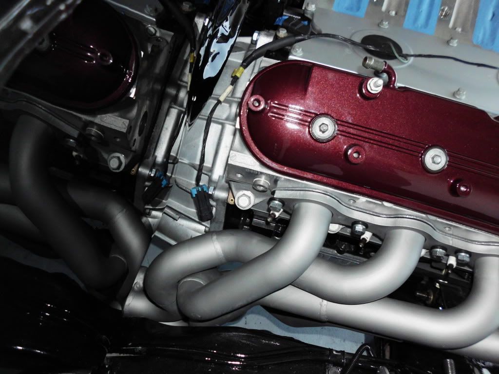

That looks awesome Brian. Good job. What did you use to sand down the intake? Just wondering if you used good old muscle with sand paper or an angle grinder first? I'm debating about doing mine body color, but haven't decided. It's covered in the little dimples.

Thanks guys, and Mitch I wish you could help too! lol As for the intake I sanded it down by hand with 180 grit then filled the casting holes in the top with red filler putty to even it out. Then a couple coats of 2K high build primer, later ill wet sand the primer with 600 grit then some color and clear.

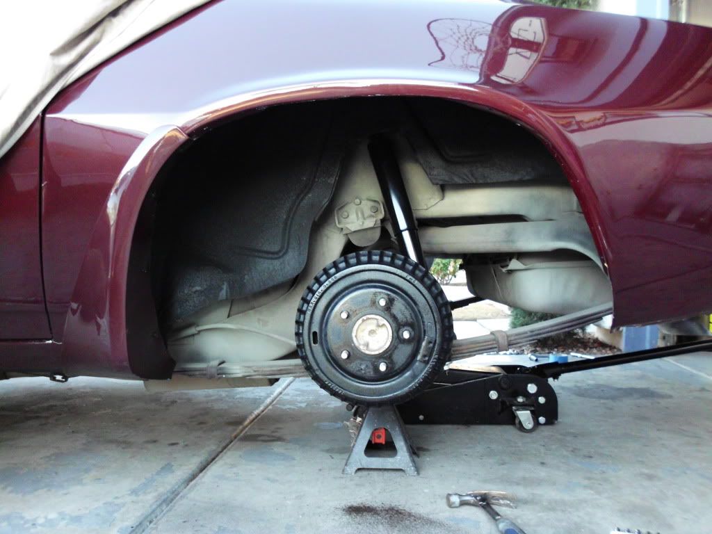

little update; undercoated rear wheel wells, installed new shocks and cleaned up the drums.

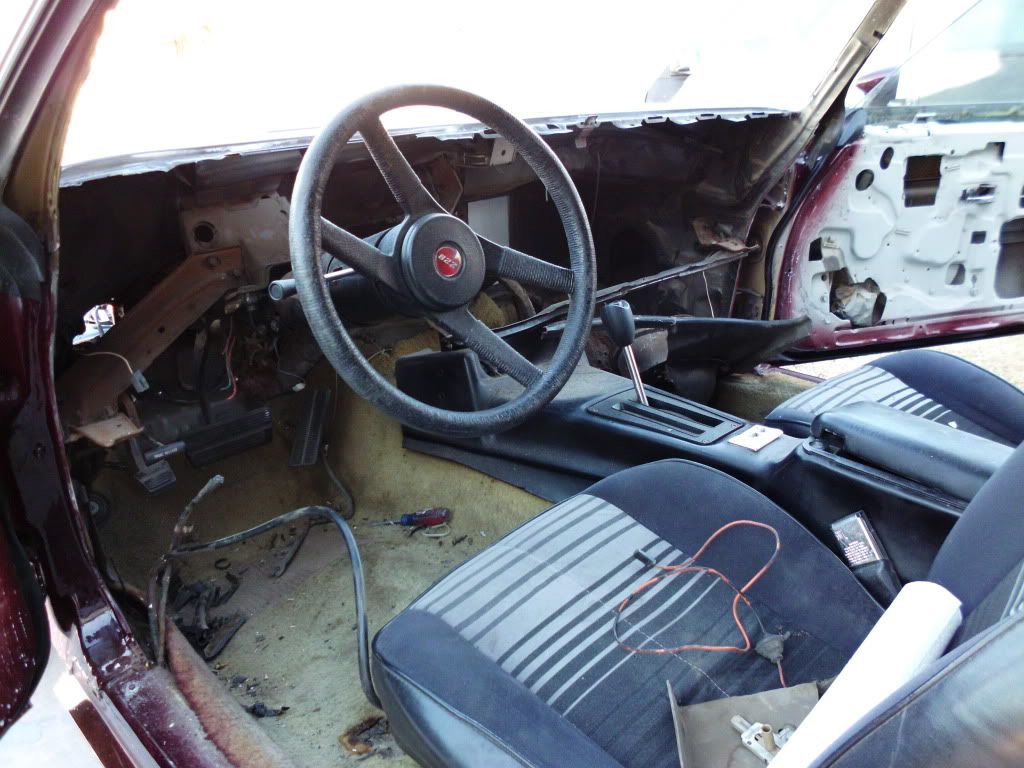

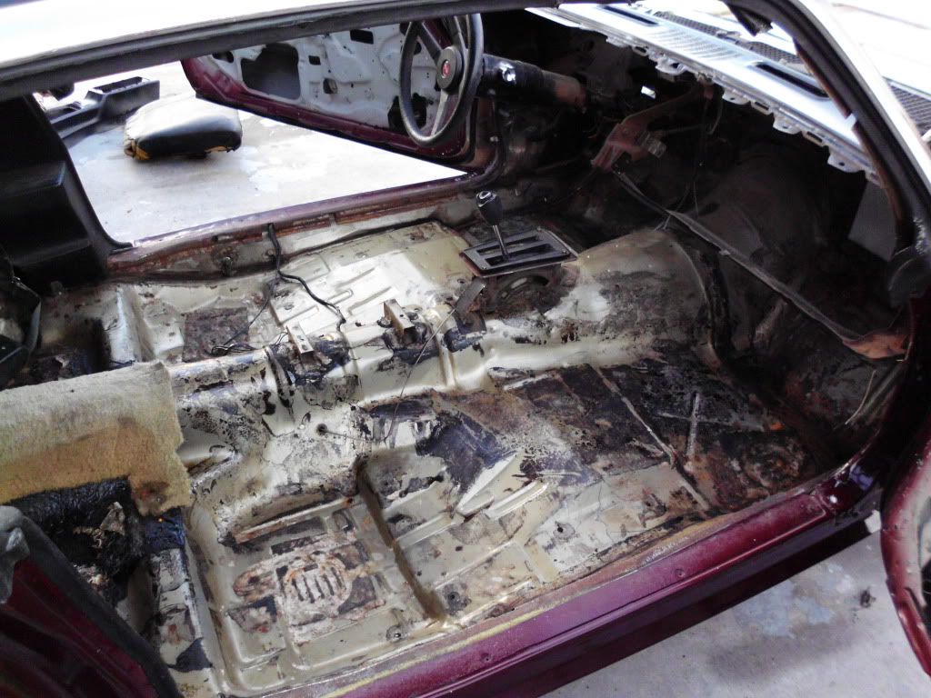

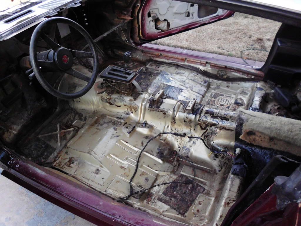

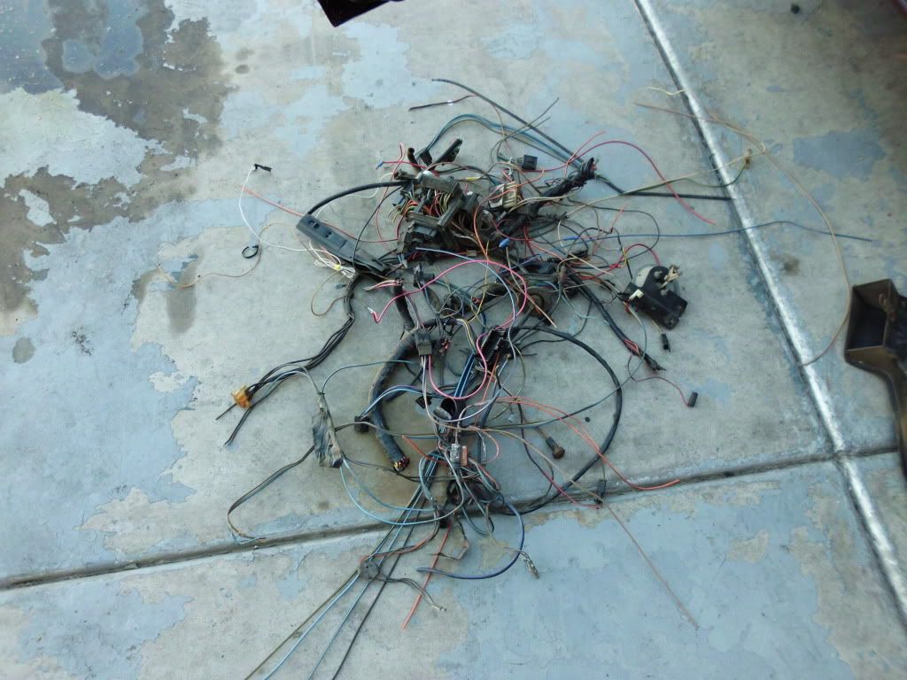

started stripping out the old wiring and interior today.
