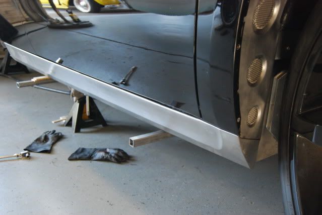

Here's what's been the most difficult project on this vehicle to date. It looks fairly simple on outside, but was everything but that to fab up. There's literally no room to work the panel from behind either and we attached it using all factory mounting locations, or to the other panels we've made.
The truck just didn't look good with the running boards and looked dumber without them as the proportions were lost in the body. We made the decision to make a rocker panel that would bolt on the truck and finish off the lower portion of the body. I figured also why not incorporate the body line that runs around both wheel wells that GM seemed to have forgotten about in the center of the car.

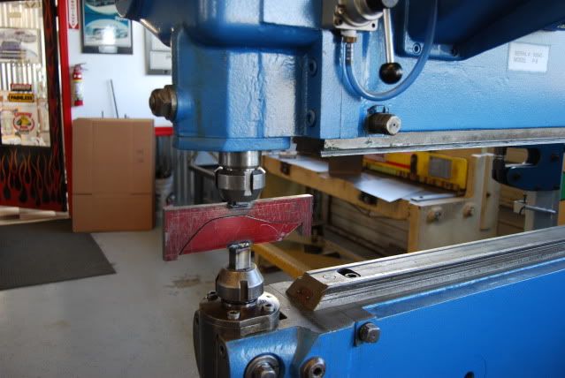

I made up these dies for the pullmax to stamp out the pieces I need. This is quickly becoming my favorite piece of equipment...
Here's the outcome:
Here's where it meets up with the inner fender panels we'd built earlier. I pre-planned (almost never happens) it by putting the notch in the panel in the beginning.

That turned out incredible. Like how you followed the body line around. I would love to have a pullmax.
