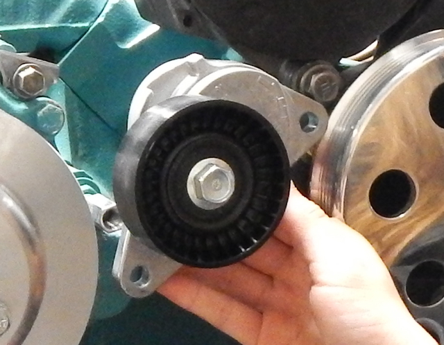

i believe i've solved the tensioner pulley puzzle.
after countless hours of sorting through pulleys at parts stores and salvage yards, i finally found a general motors manufactured tensioner pulley that might work for the serpentine accessory drive.
at 4.00" the dimension between the two mounting holes in the tensioner is exactly the same as the dimension between the threaded stud on the timing cover and the lower alternator mount!

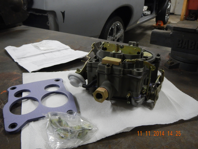

also, after months of screening ebay and other online sources i finally found a spread bore, four barrel, rochester quadrajet carburetor for 1968 pontiac manual transmission application.
huge credit to cliff ruggles and his team at cliff's high performance for their effort in remanufacturing and refinishing this quadrajet.
many sources claim no one has more skill and knowledge with the rochester quadrajet than cliff ruggles, so i am very fortunate i was able to coordinate with him on this project.

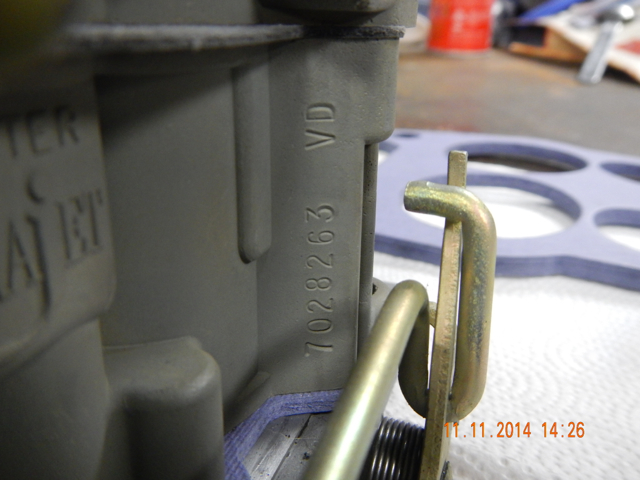

702 => 1960's
8 => 1968
2 => quadrajet (4 bbl) federal standards
6 => pontiac
3 => manual transmission
