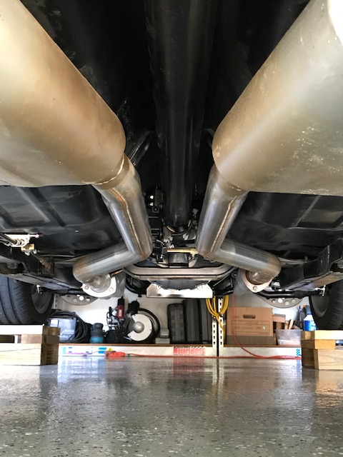

This past Saturday was a washout so I decided to tackle the exhaust redo. I got the X pipe and Dynomax Super Turbo mufflers installed. Overall, it went smoother than expected considering I'd never done one before.
I'm still working on the engine/carb tune. My A/F ratio gauge reads 14.5ish at idle, but it still smells very rich, the spark plugs are dark, and I get intermittent exhaust "popping." I may break down and try to find a carb "expert" soon. We'll see.
Daniel
