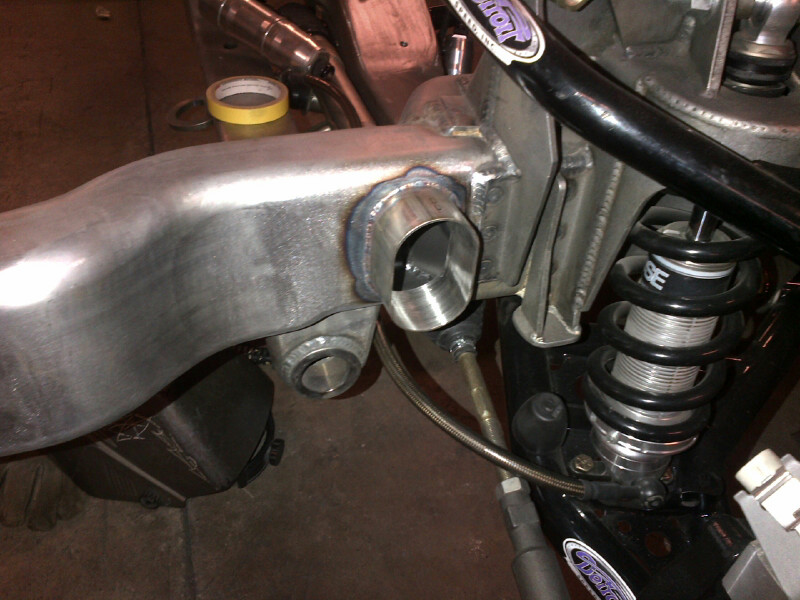

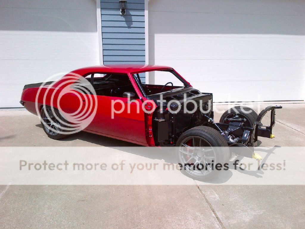

Guys I had an idea of moving the dry sump tank back in the cowl. With some measuring and a cutoff wheel it fits. It all fits inside the fender. Working on getting mass back in the car. I also mounted a C-6 brake booster and master. Matt filled the firewall. I really like the guys at Sled Alley. Top Notch.

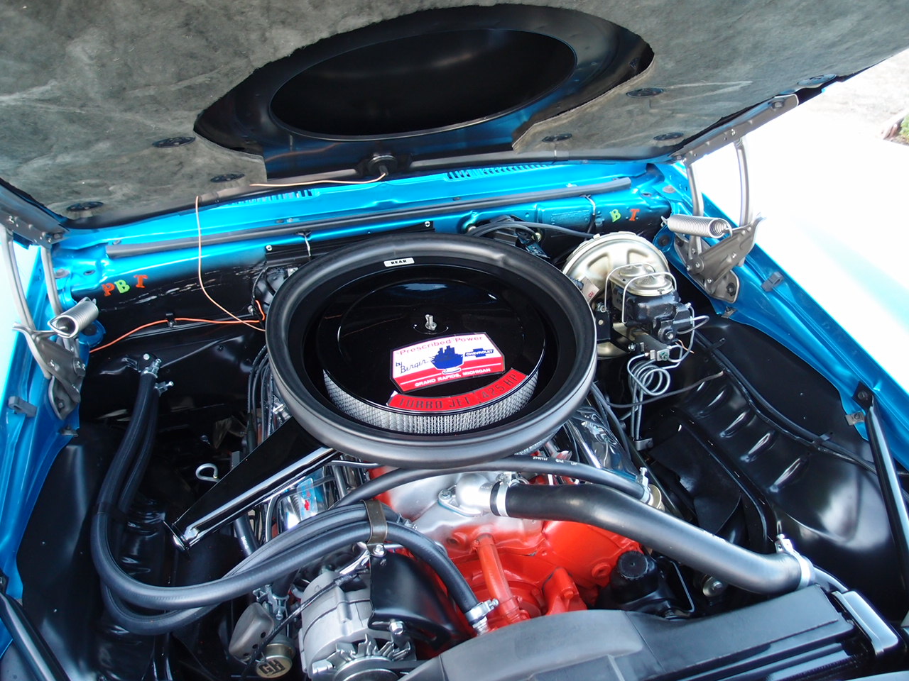

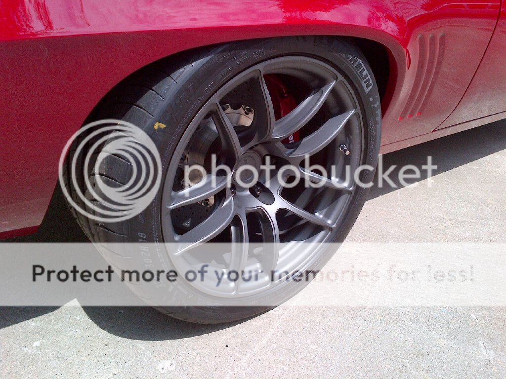

Originally Posted by Stielow;453080 I also mounted a C-6 brake booster and master.
[IMG
http://i439.photobucket.com/albums/qq118/Stielow65/Camaro%20XV/Clinton-20121222-00171_zps74927ca3.jpg[/IMG]
So you use the stock c6 brake booster and master? How would this work with the z06 brakes without abs? If you could give us some more info on this. So you used the dse bracket but where did you get your measurements and what are all the part numbers and some feedback. what peddles are these and what would you do to eliminate the sensor on the side of the reservoir?
Old 05-12-2013, 07:59 PM
Posts: 6,621
Thanks: 1,803
Thanked 926 Times in 688 Posts
ABS is a separate module so the MC and booster combination would work just fine like it does in a Z06 when ABS isn't activated.
