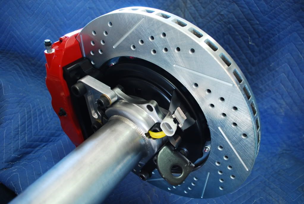

When I changed rear suspension in my car last year I went with the Moser floater. The DB unit (dual bolt pattern) It is 5x4.75 with 1/2 studs. The center register is 3.06 (which is a ford) I had them turn it down to 2.78 (Chevy) After getting the floater, I doubt that I would ever run anything different in a PT/track car if I owned it. The strength of the design and bearing spread make for a very safe and serviceable unit. It takes me longer to jack up the car, place it on jack stands and remove the wheels than it does for me to pull the axles and remove the hubs.
In my opinion there is no comparison to a standard 9 with the tapered or sealed bearing and the floater. But...and there is alway a but, the parking brake is an issue and how much lip you want on your wheels. I wanted to run a C6Z06 wheel offset, so I had plenty of room to package a custom parking brake. If you want 5 inches of lip on your wheel, it is going to be tough to do with a standard floater. The new one that is being developed that runs a C6 bearing pack and parking brake would solve all of that.
Doug, not sure if you still have my cell but give me a call 704-564-8577 and I can answer any questions you have. I have researched every floater set-up out there and can give you a ball park in cost and pros and cons of each one.
Here is what I did for a parking brake. Took my existing Wilwood hat with the intergal parking brake, machined out the center and attached it to a rotor adapter. Then machined out a bracket that is like a 9 inch flange and attached it to the floater to mount the ebrake/caliper mount.
