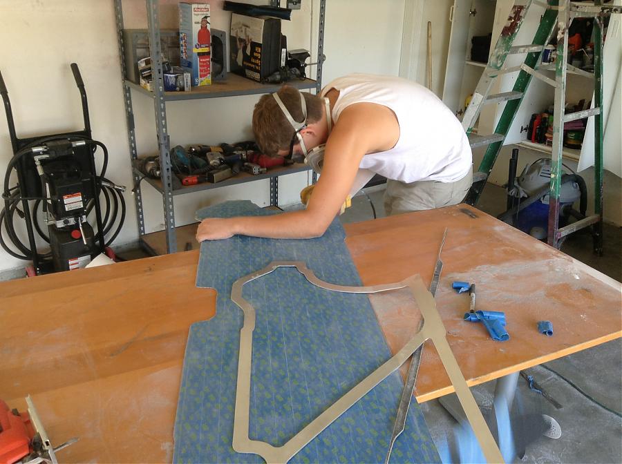

Here is a quick update. I have got to give all the credit to Justin on this one as this has been his pet project.
Over the past several days he's been working on a close out panel for the trunk to separate it from the interior since we lost the rear seats. This stuff has taken time. lots of it. It is one of those things that though it may look pretty simple, not many people realize how much time and effort is put into it. Here are some pics.

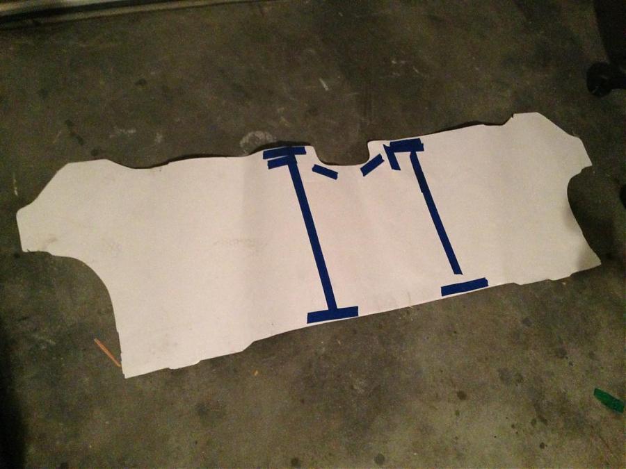

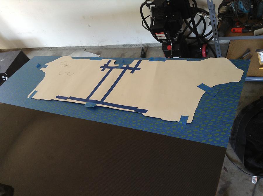

The template was the first step. Hours of fitting, checking, trimming, trashing, cutting, checking, trimming, you get the idea... the driver and passenger sides were not identical as well so had to do a separate template for each side.

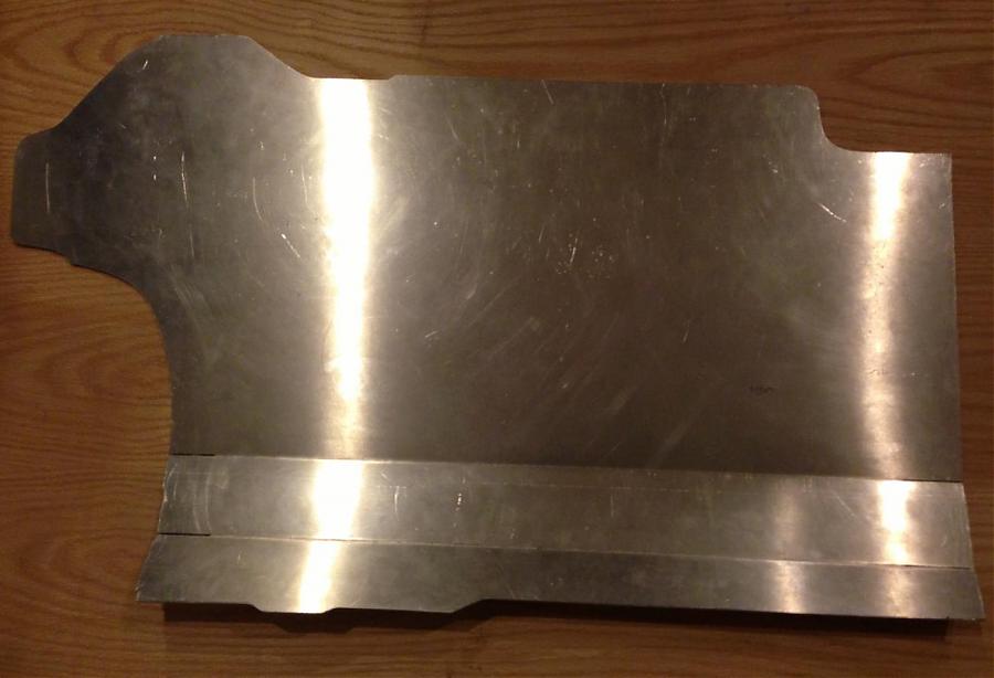

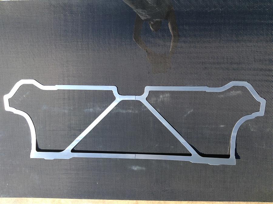

Hand cut the panels from the template

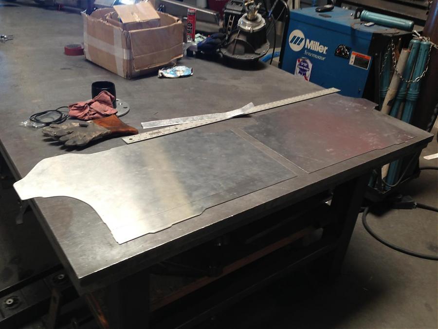

Made two bends to comply with the frame it will sit against in the trunk.

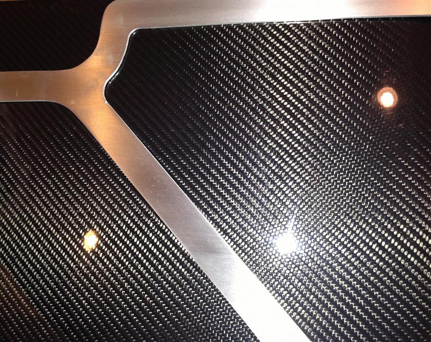

We had a sheet of carbon made by APR performance. These guys specialize in wings and aero. They will be making one for G5.R. This has got to be the largest piece of flat carbon in the "UNIVERSE". That was for you GW, LOL
Here is a close up.
Tracing the template.
After some online research, he found the best way to cut this carbon was with a jig saw and a carbide blade.

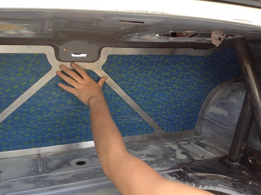

here a mock up. Next in line will be drilling the counter sunken holes and bolting.
