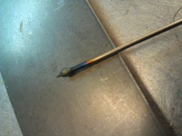

Can anyone beat this tungsten trick?

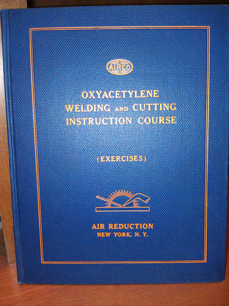

A hot-rod friend saw this book and had to buy it for me.
It's the second version of the 1942 original published in 1947 and in immaculate condition. Has all the basic weld techniques, certification and testing requirements. Great resource!

Nice book!
When I was in high school I worked in at body shop (Gateway Body and Fender - which is still in business to this day!) -- and we used to Braze fenders etc on - and I learned to weld with Oxy/Ace torch. Those skills were easily transferred when I started to TIG - because it's a similar hand action. The major difference is with the gas torch - you made a circular motion. But moving the puddle - torch angles - fill feed - those are directly similar.
Back then (45 years ago!) we Stick welded... and that's very similar to MIG welding - you could push or drag the stick.. You learned to bury it in the puddle if you needed the penetration - and how to pick up both sides of an inside corner - or the weave needed for a vertical joint etc. I like not having to chip the slag...

The oldest trick in the book dude!
Backside contamination on 1/2" od 1/16 wall sq tubing. I was just tigging along and POP!......crater in one of the better beads I've put down. Happened three more times and I said "F it" enough of this cutesey crap this bracket needs to be done and fired up the MIG.
  #147
Old 04-03-2013, 08:46 AM
If your weld is popping ---- it's DIRTY!
Or you're welding on junk tube. Tough to TIG Galvanized water pipe... Which I doubt you're doing. In fact -- don't TIG galvanized anything.
Tubes tend to build up heat inside and draw oily smoke into the weld...
And - if you're trying to close up the tube ... and it's a short piece... I punch a 1/8" hole at the end for a heat escape - otherwise the pressure build up of the expanding heated air inside can blow thru right where you're welding as you're trying to close it up.
Didn't consider the pressure build up, it was fully closed but the small volume probably added to POP. Contamination most likely the culprit, new stock tubing properly prepped externally but I didn't take a bore cleaning brush and solvent to the inside. It was a fast and dirty project............and another learn by experience event. Regrinding tungsten is similar punishment to writing something a 100 times on a chalkboard.

It's a steep learning curve.... but check another "don't" or "do" off the list.
Yes --- you had HEAT and Fumes (think machine oil from the tube process) blowing out molten metal.
Do you ever wonder - how I can figure these things out BEFORE you post pics of what you were working on??
I buy NON Chlorinated brake clean by the CASE ($1.99 a can if you catch it on sale) to shoot down inside stuff like this BEFORE welding. And either you can drill a small escape hole -- or leave the last tiny bit open - let it all cool down and go back and touch it up.
